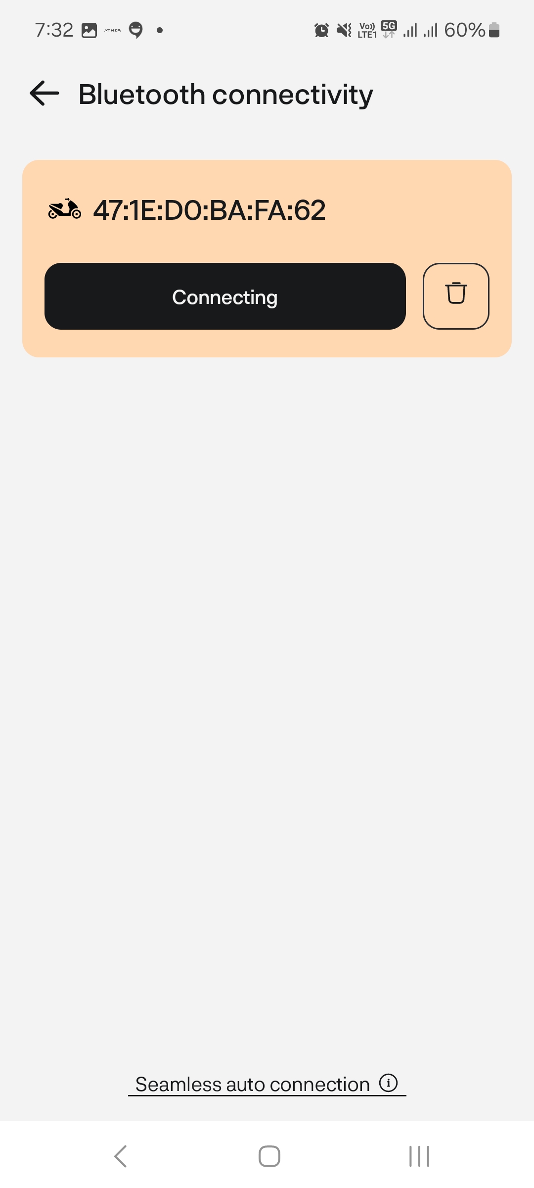

After update bluetooth work for 4 days . After that bluetooth not connect to my mobile / Ather app.
Vehicle name not shown in my mobile.
Somany times restart but not happened.
Any solutions sir
Same issue with me. I unpaired the device restarted scooter and after multiple attempt it got connected. I am not sure whether it will connect tomorrow. Bluetooth issue I hope Ather fixes it for user in next update as it is key for TPMS as well. Hope someone from Ather team atleast know bluetooth is an issue for Ather rizta customer

  1. UNABLE TO CONNECT TO BLUETOOTH

Rizta coming with AS6 with Bluetooth disabled. You need to wait for AS6 update to get Bluetooth enabled.
