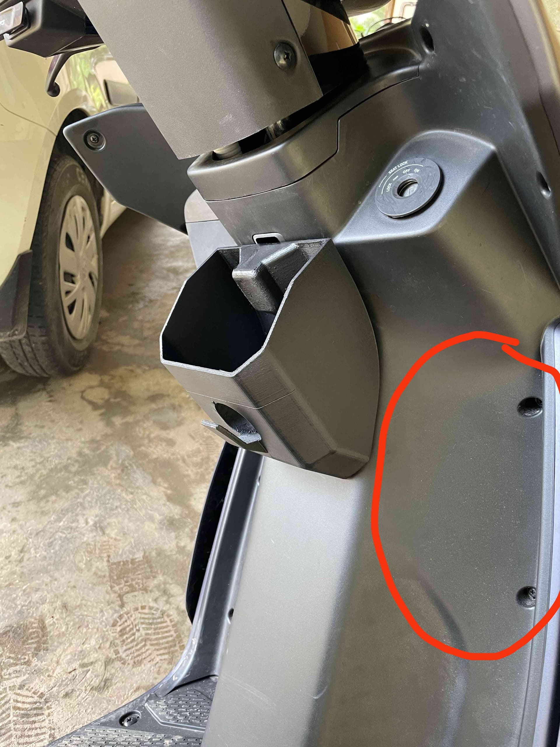

I have created a 3d printed glove box for 450x gen3. The product is not final, but this will do the function (don’t want to print lot of prototypes). Insert the model to luggage hook to lock, to remove it press in the bottom of the hook through the hole bellow the latch in the model and pull up. The Model: search in Thingiverse, model no 5488262
But this is good , with a clever idea to hold it without screwing ![]()
So will you be willing to sell it to potential customers ![]()
You can download the file and print it in any 3d printing shop. I printed it in PETG and spray painted black matte😊
What did you design this in? Blender, auto cad?
Autodesk Fusion360
Hope to see more stuff from you, might as well design the footrest XD
That will need a bigger bed for the printer or a clever way to attach two or more pieces of print.
Printing in parts and assembly can be done, but the printing should be in PA12 nylon or metal to be strong, which will be of huge cost
