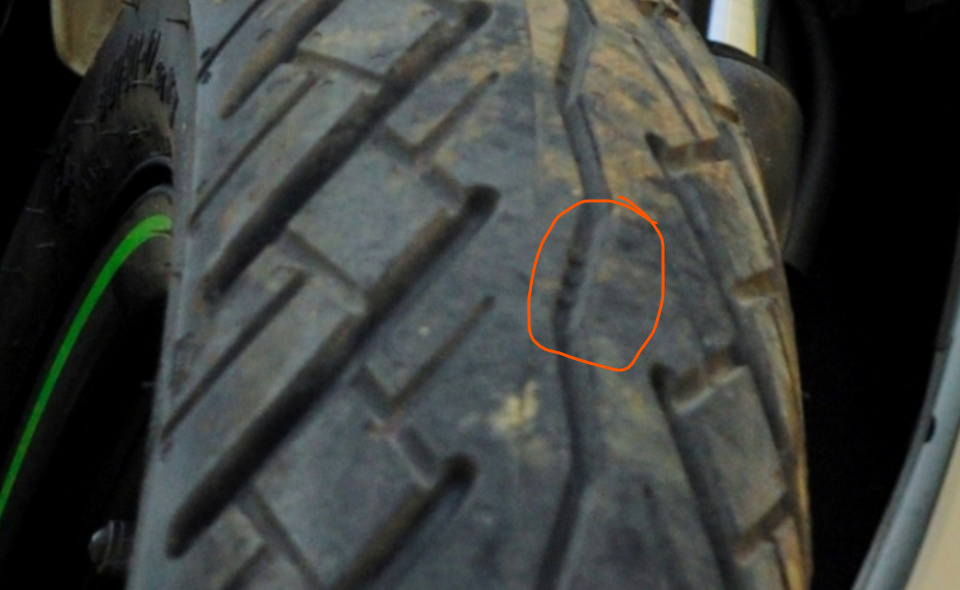

Insane!!! Its a New vehicle, just a month old, the first puncher and it ruined my tyre. I had to change my rear wheel tyre which had driven less than 1000 kms, all because of a nail. yes, that’s right. I picked up a puncher on a sunday evening and I only noticed it the next morning on the way to office. I got the nail removed with lot of difficulty and the hole plugged. To my surprise and it will surprise you too by just looking at the thing that pierced the rear tyre.
I was disgusted to see my tyre flat again in the parking lot when I was about to leave office in the evening. I rushed to the same tyre shop where I got it fixed in the morning. After 30 minutes of struggle, lifting and tilting Ather on its side and carefully checking all around the tyre we found another hole which was caused by the same nail
After finding out the cause I certainly knew it could not be fixed and the puncher guy also said its impossible to fix this. The nail had traveled all the way and pierced the side wall of the tyre just next to the rim.
