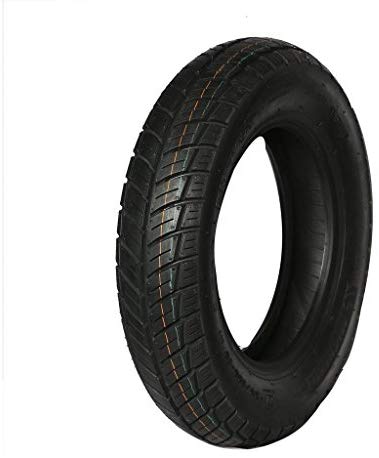

Which were the tyres that you changed to ?
Is there any way we could add fat tyres because that would look rad :grin: … I know it increases drag, but just asking if anyone has tried
Miclelin city pro. same spec as stock tyre. I am getting a new Ather in September hopefully, will put in fatter tyres on it. cos u know rad is in

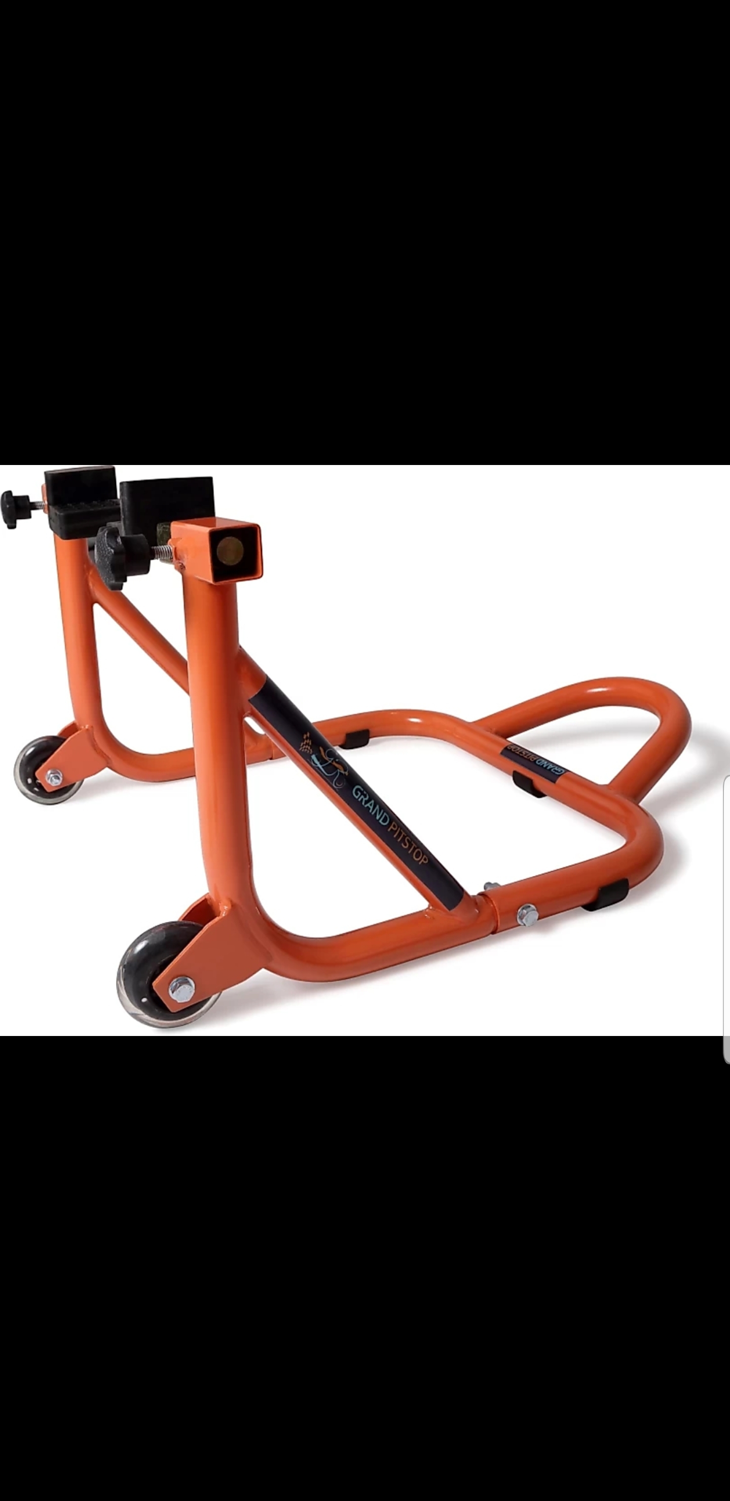

But Without Centre stand how can change the tyre?
They use paddock stand
