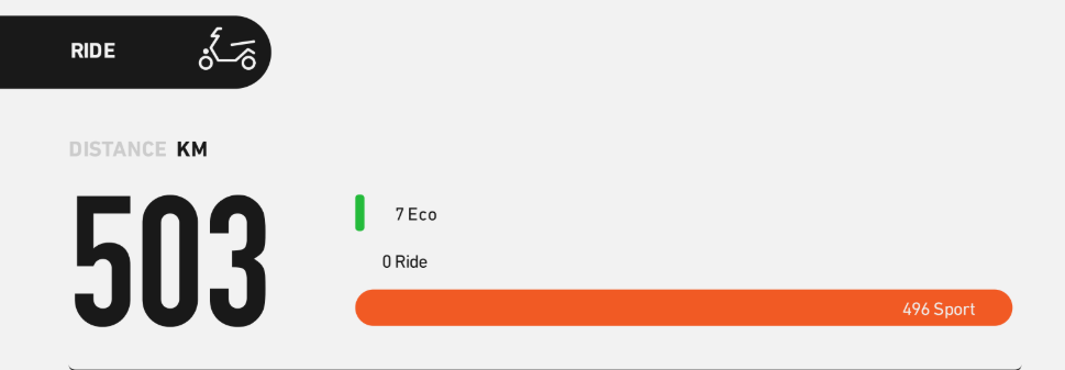

The Ride tab where Distance Km is shown for each mode, Eco mode distance is not calculated if that mode is force applied (battery below 18%)
Thanks @abhishek.balaji. Looking forward to see my report with correct values

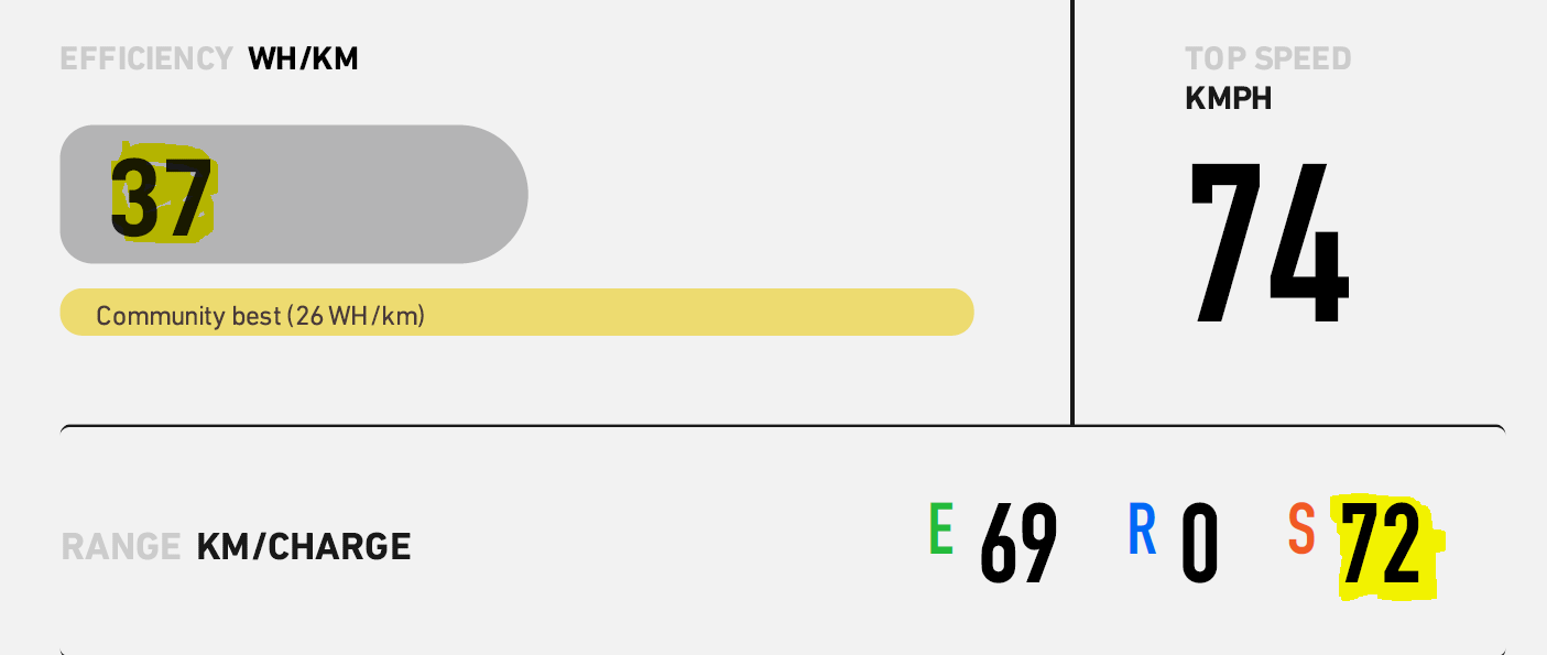

The report have good information but there are a few errors that possible might be due to different method used to calculate these
Ex: efficiency Vs Range values don’t match
If I have a avg eff of 37 watts this would mean that my range will actually be 65 km per 2.4 Kw battery charge if I take the data as uncapped 2.7 Kw the values are closer see comparison below
I hope this is not the case as most of the user are facing same issue on the report, I suspect the calculation is braced on Battery actual capacity of 2.7 Kw where as we can only use 2.4 Kw

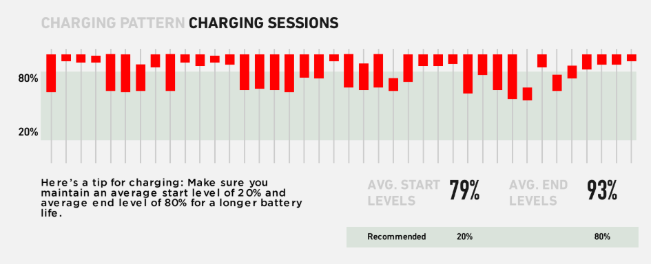

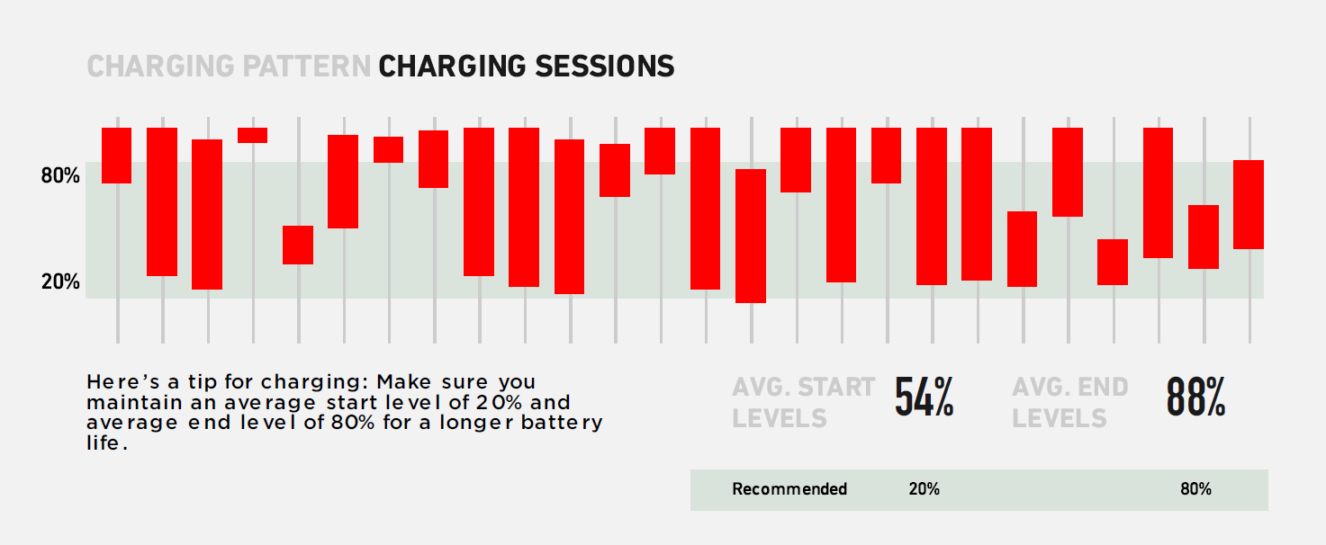

Now moving to the next data that we are very interested charging pattern.
The current issue is that if a user is driving 50 - 60 km per day none of us will fall in the ideal range of charge it to 80% as full and use it till 20% charge left( @2.4 as base line).
To achieve this is next to impossible for me at least as with a SOH value of 60% I can use the actual battery wattage I can consume is only 1.44 Kw(@2.4 Kw) that would require some very very conservative drive characteristics of the power consumption where the user needs to consume between 29 w/km for 50 km and 24 w/km for 60 km which is actually impossible for me as my commute will involve gradients that increase the power consumption.
Note your own representation of range in Eco is 75 , Ride is 65 and Sport is 55 . This means that @2.4 Kw i will have a be burning 32 w/km , 37 w/km & 44 w/km
Also the use of red in a graph is to denote a negative representation of data hope this not the case as my data for every change is denoted as red that is quite confusing as this means that we are actually not chagrining as expected for optimal battery life when the data is shown as Red on the graph.

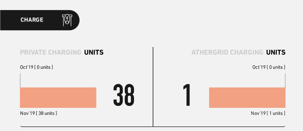

I just got our BESCOM bill and I see that the bill cycle is 14th of the month to 14th of the next month given that different areas will have different due dates there is no easy way to correlate the units consumed report and our electric bill.
Also charge sessions dont indicate if they are at home from the dot, outside from Ather Grid or from an unauthenticated portable charger
I feel that just like ride statistics we need a charge statistics tab on the app and this level of detail should be pushed out there. If we get that then I could use the portable charger at some random roadside tea stall and show the host how little power we have drawn
