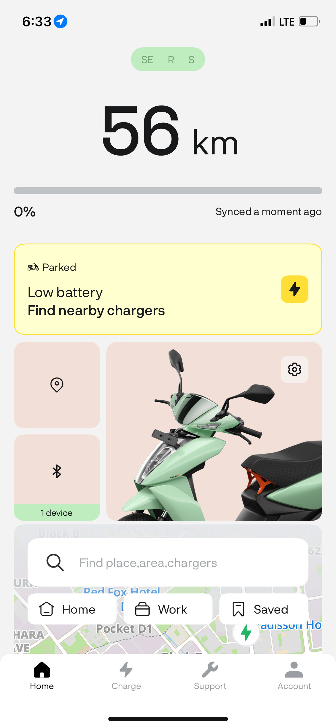

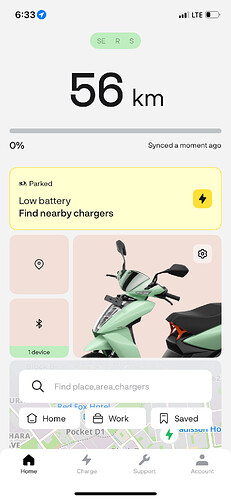

After sometime now in app it shows 0% battery :fearful::fearful:

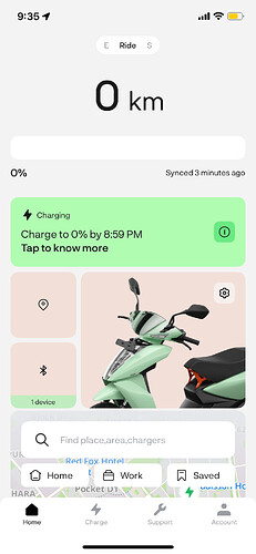

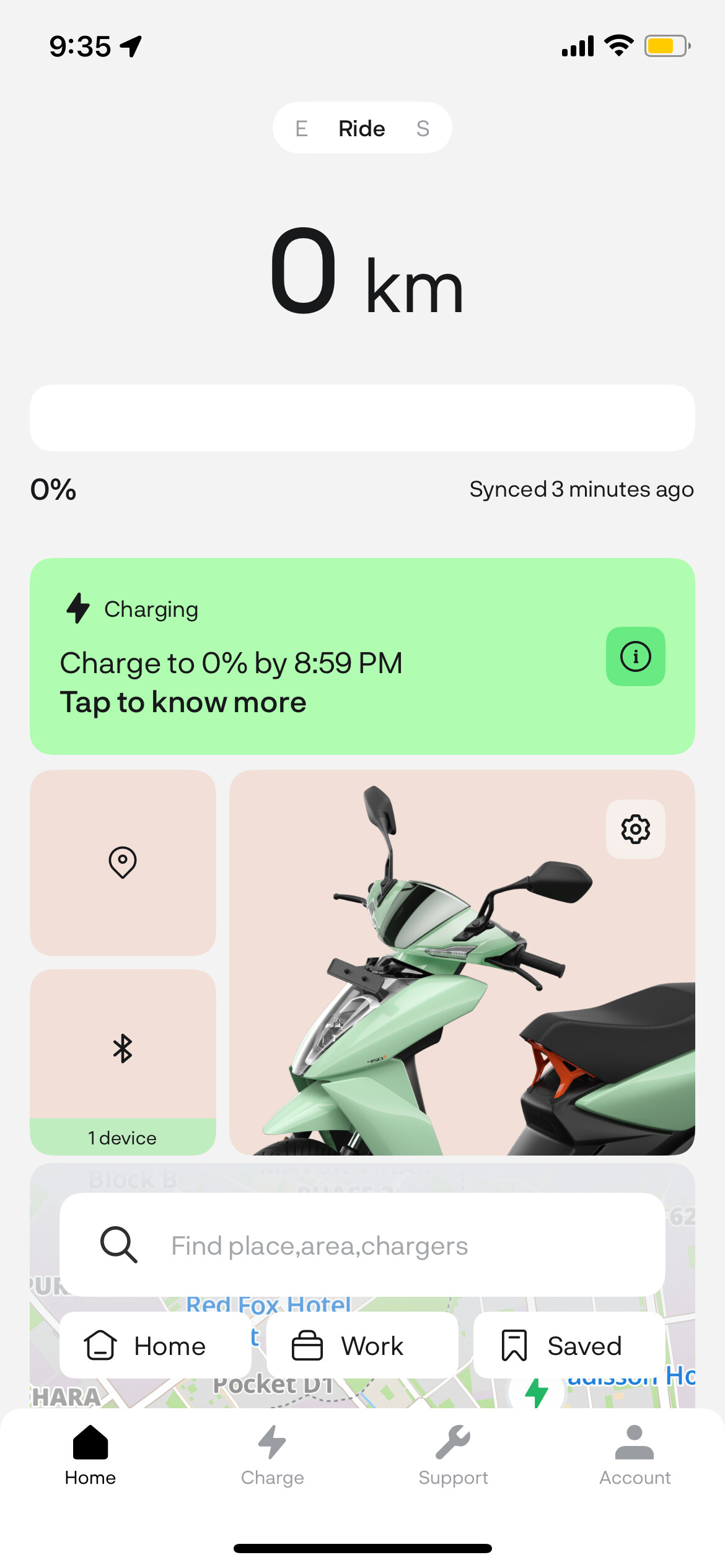

It wasn’t supposed to go to 0 from 76% all of a sudden… and now the reboot screen won’t go away even though I have put it for charge for 2 hours. :roll_eyes:
And even though it was charging it kept showing charge as 0%

Got a call from the service centre, and they said rats have bitten some wires, and quoted me 8.5k rs, but said it will be covered by insurance. but honestly, 8.5k for replacing some wires ???
