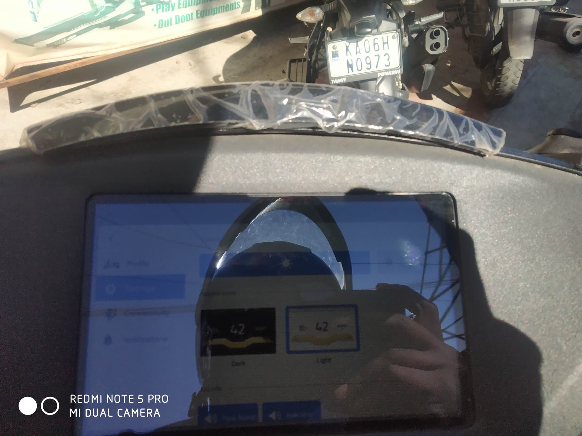

Same with light. Mode and full brightness!
That seems very less! The previous UI was reasonably brighter
No… UI change is good. Only thing it doesn’t work under bright sun light. Hopefully they will fix it by increasing font size or weight. I am really feeling Ather as premium product with new UI. Small issues are learning experience and once they figure out the fix we’ll all be Wheeing with pride.
Nope there is a bug with the screen brightness…You have to manually slide up and down a single time to get the full brightness even though it shows that the screen is fully bright…
+1. It’s a bug. Slide it and it will be fine.

This happens only when the charger is plugged in and removed. What happens is when the charger is plugged in the brightness is reduced to half and after removing the charger the brightness will remain half itself but the brightness bar will be full. This can be solved by sliding the brightness bar to full once or just a normal key on and off will also do the job.
Also i think it’s not a bug, it’s designed in that way.
