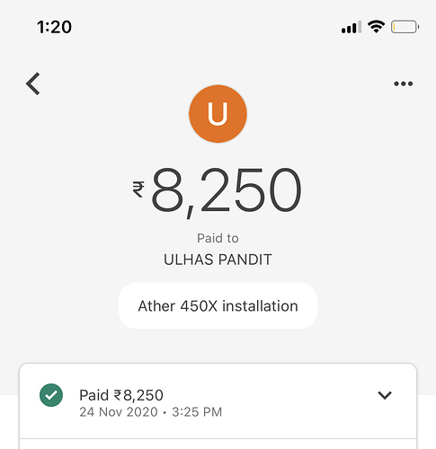

Additional cost I had to pay for the Charger installation, in Appartment complex the distance from the meter to the parking spot will certainly be high… so keep this cost in mind as Ather does not give any discount on the additional meters of installation … so there is an expense ever after the heavy cost of the 450X
