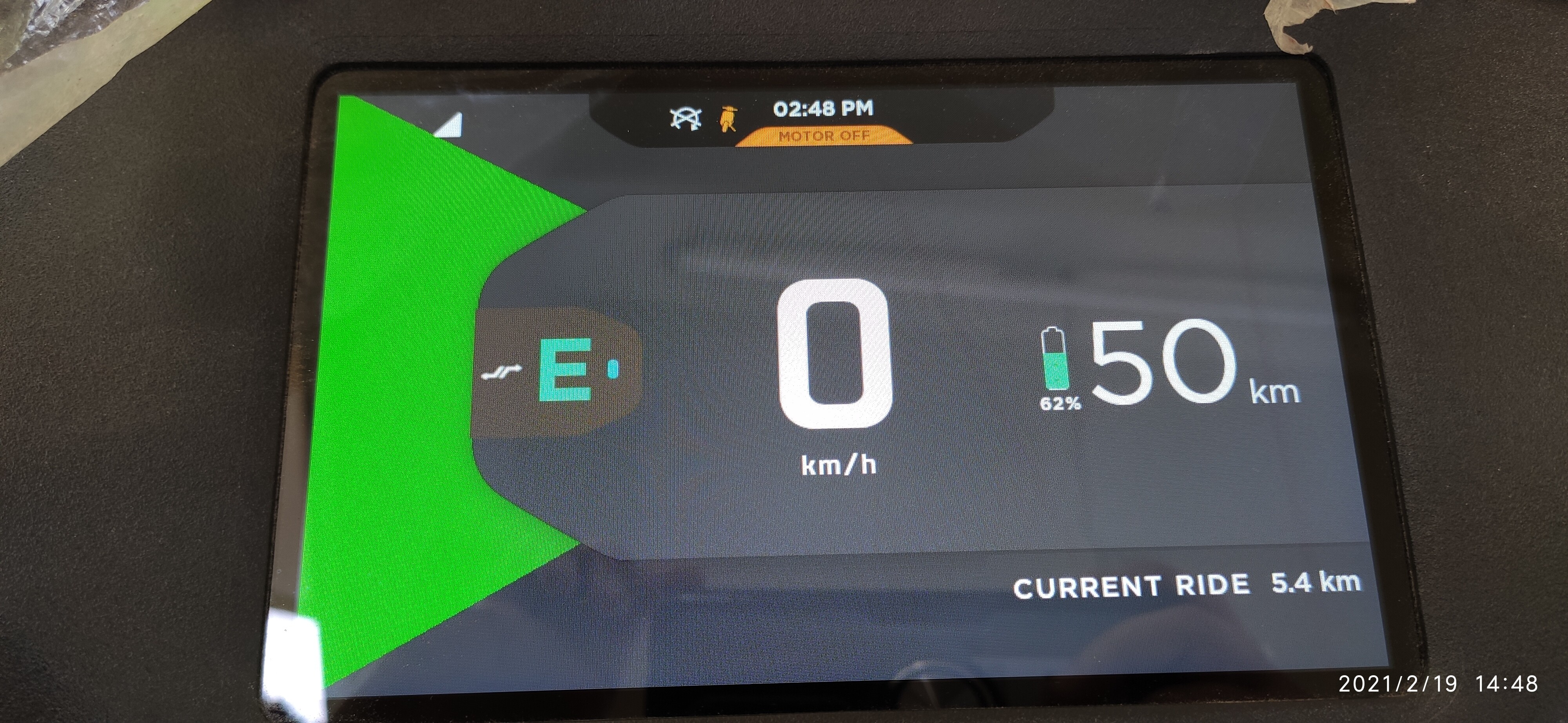

Alright folks! The issue has been resolved.
I raised a ticket through the app but didn’t receive a prompt response (a 24 hour waiting period for a quick resolution isn’t ideal!)
Called up the customer care and shared the video with them so that they had complete clarity of the issue.
And I did exactly what they instructed me to do:
  • Hard reset (both the brakes + ignition for 10 seconds)
  • The screen was on but the data was wrong (showed zero charge and the Odometer reading was incorrect).
  • That’s when they asked me to shutdown the scooter.
  • Turned it on after 5 mins and everything was back to normal :man_shrugging:t5:
This was my first software glitch with the 450X which otherwise I must say is a mean machine when it comes to it’s hardware performance.
I guess we will have to live with the software glitches but hopefully not for too long! Would have been downright embarrassing if this happened midway during my ride. Luckily for me the basement is a safe space :sweat_smile:

I suffered from the same yesterday. First major software glitch for me (apart from the dashboard hanging since I parked near a transformer, twice).
The most suspicious sign for me was - the app was showing NO discharge since 3 days. I knew something is wrong, took it for a quick spin, and behold! 0% battery, 0 km range displayed.
Funnily, everything worked : the indicators, starting the scooter up, putting it in reverse mode (via shortcuts) etc. but the screen was frozen.
I quickly browsed through the forum and performed a reset, which didn’t help. Then carried out the “shutdown” method I saw in @jeetash ‘s post. That solved the bug.
+1, same first time dashboard freeze experience. Your post helped resolve the issue. Thanks!
