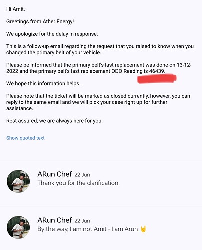

My Primary Belt Changed at 46,439 KMs ODO

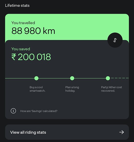

Today’s ODO : 88,890 KMs
Belt have some Missing Tooth + 4 Tooth Missing on a Row
But Still Rides like a Horse
Changing it Tomorrow :baby_symbol:

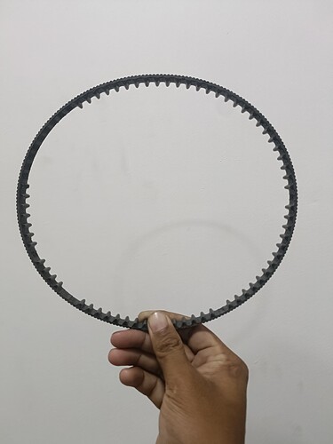

Ather’s Primary Belt Life after 42,553 KMs :white_check_mark:
Can you show me image of the belt as in video I can clearly hear that it is making sound like bullet 350 :joy: want to know how it is creating the sound?
Simple, Around 12-14 Tooth Missing :rofl:
Ather 450x Gen 2 Primary Belt :white_check_mark:
But the Quality is at Its Best !!
