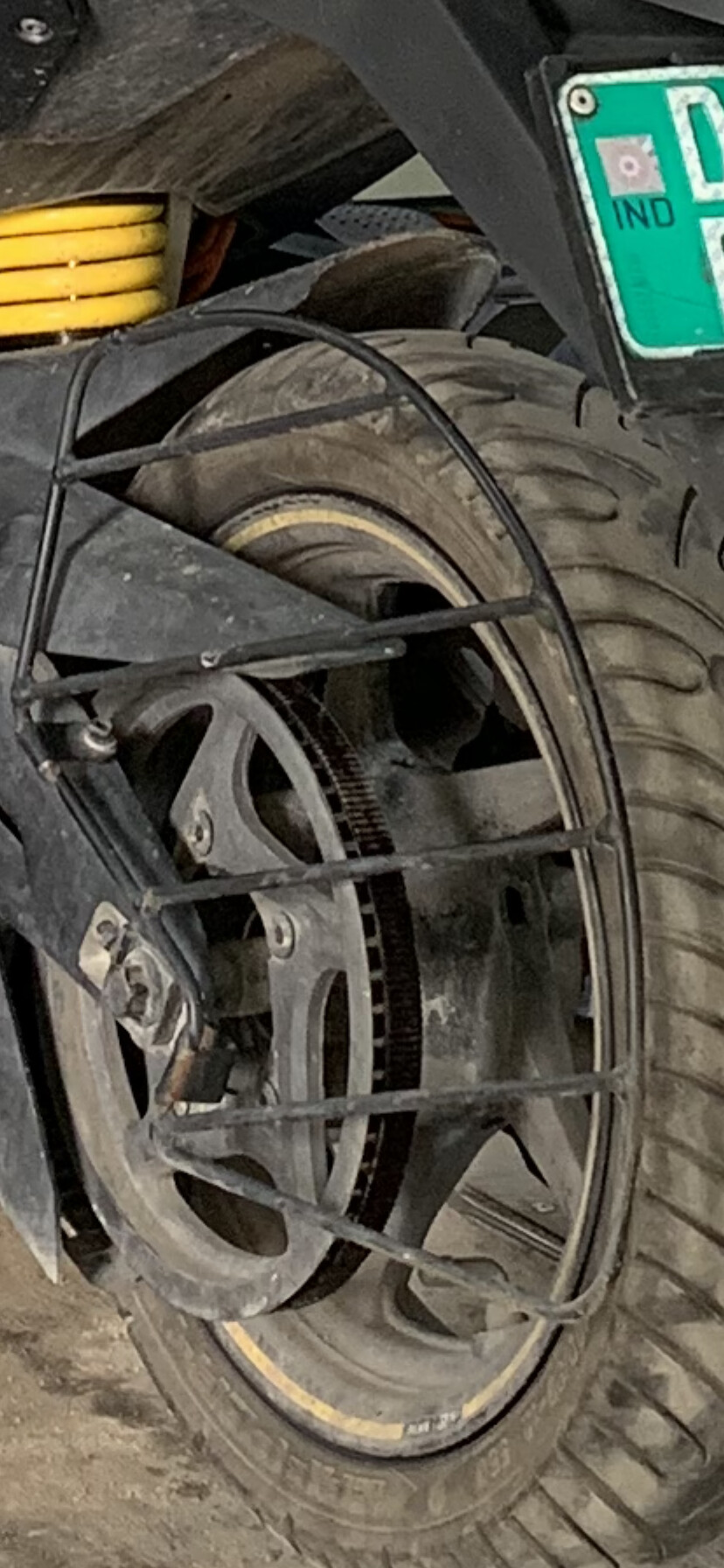

Belt broke down today after 17,906 km and 15 months of regular use of my Ather 450X. Despite showing belt cracks during every service visit and whenever there was noise from the belt, the Ather Nagpur service center and service manager never took it seriously until today. While climbing a flyover, a cutting noise was heard, and the belt broke. I was fortunate to avoid being hit by a car, as everyone was trying to climb the bridge at speed and it was about to rain. I even posted a thread on the Ather community a year ago, when my scooter was 2 months old, about the cracks on the belt, but no response was received from anyone.
Link to my year old post
now i have to give it for replacement tomorrow and to wait fro 2 weeks since part is not available as instructed by Ather nagpur.

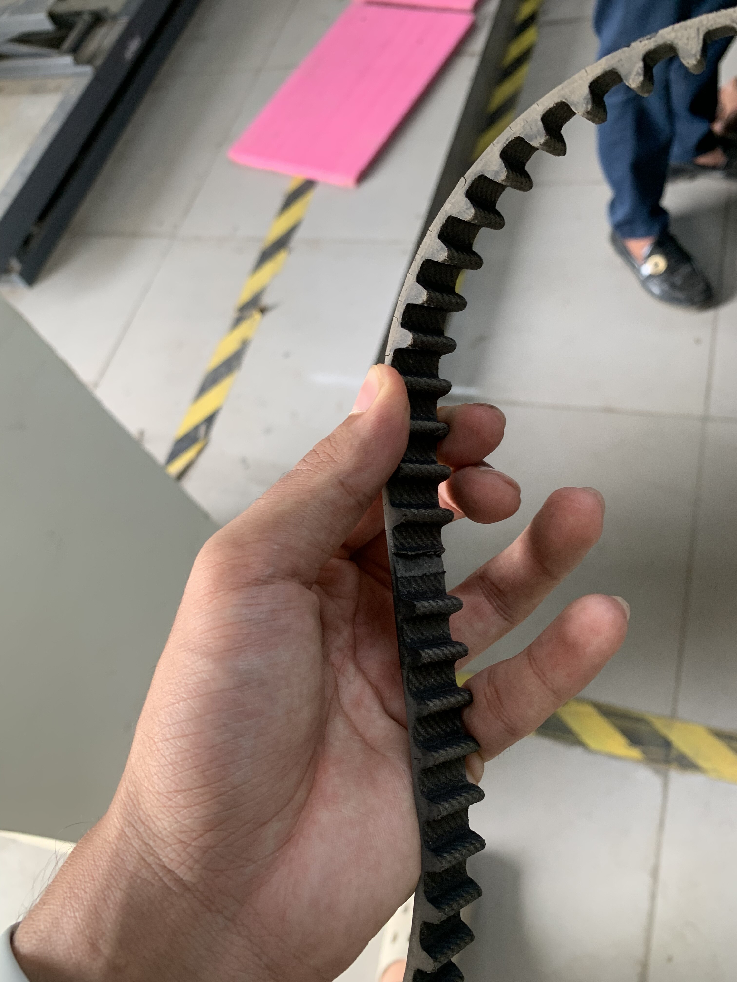

Old belt - broken teeth
New belt -
