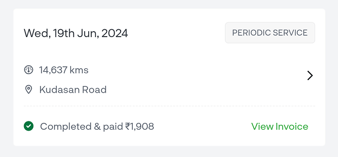

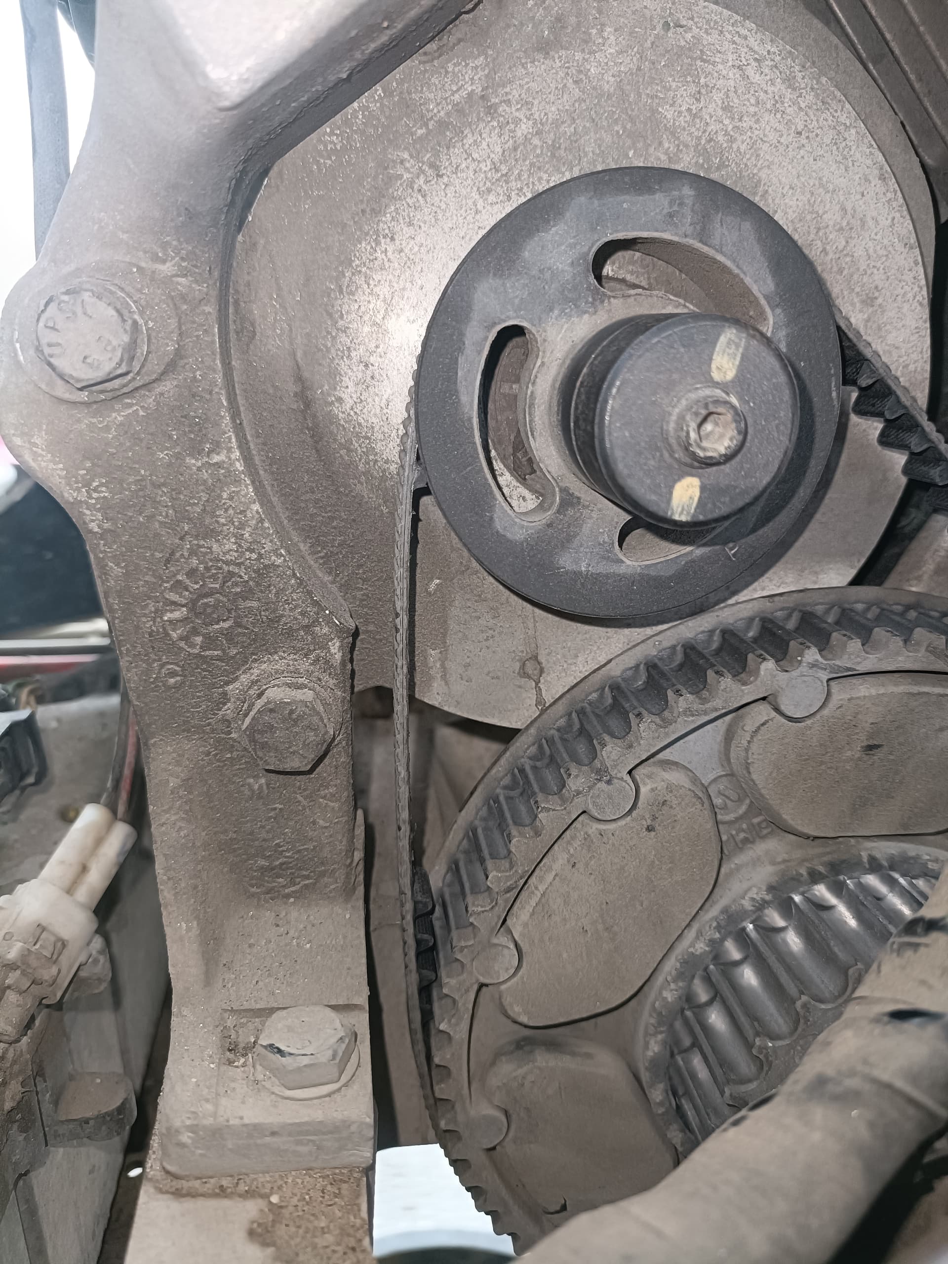

What’s the use of belt warranty when the belt itself is of sh*t quality… I just got my Ather serviced a month ago(15km periodic service) and got the belt replaced…
The new belt was replaced under warranty but it just got snapped into half while I was cruising at 25kmph.
Where’s the quality against what we are charged for?? Thank god I was not in the middle of the road and was cruising at 25 kmph

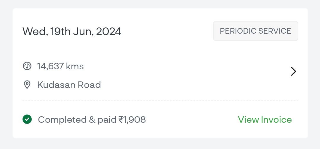

Last service → 19th June , odo: 14,637 km
Current odo : 15,384 km .
Now you can imagine the quality of your new free belts @tarun
It has Warranty of 10k KMs
Change it :thinking:
I had the belt replaced on 19th June…and within <1000 km of driving, it broke.
The belt will be replaced under warranty again… but I am concerned about the quality :confused:
Belt issues are very rare these Days. Hope You get a Quality Belt this time.
Also You check Intermediate Pulley Quality too

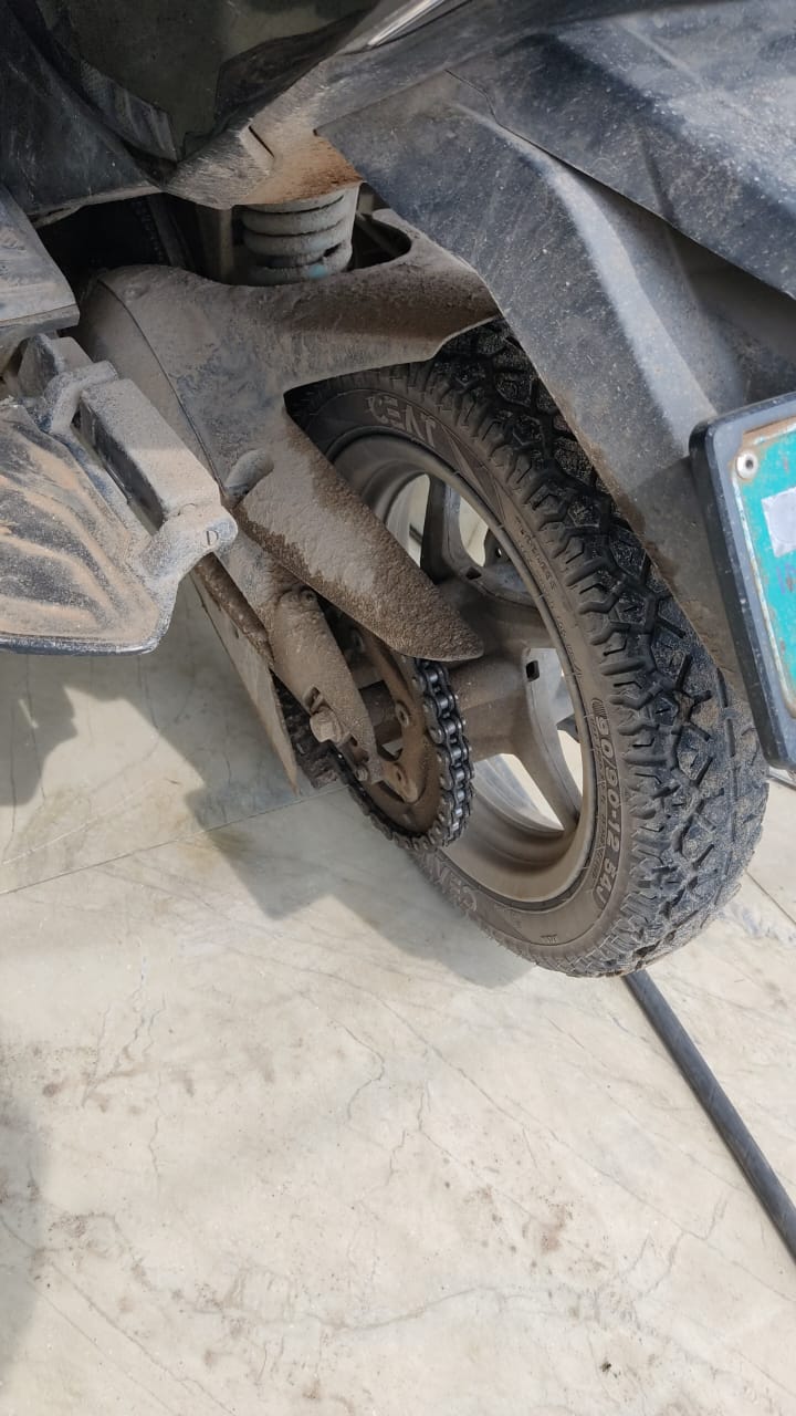

Why can’t Ather Implement this??
One of a Customer from WB (Kolkata) did this Modification.
I didn’t hear anything about Performance or Issues but Company should give a Chain Drive Option too if Belts are not reliable
It could be due to an incorrectly tightened belt. Did the service guys check the belt tension? It could also be debris stuck under while installing.
Make sure they check the belt tension after installing the belt this time.
As Arun said, belt issues are very rare now. No need to worry or doubt the quality, just bad luck it seems. A new belt and you will be fine!

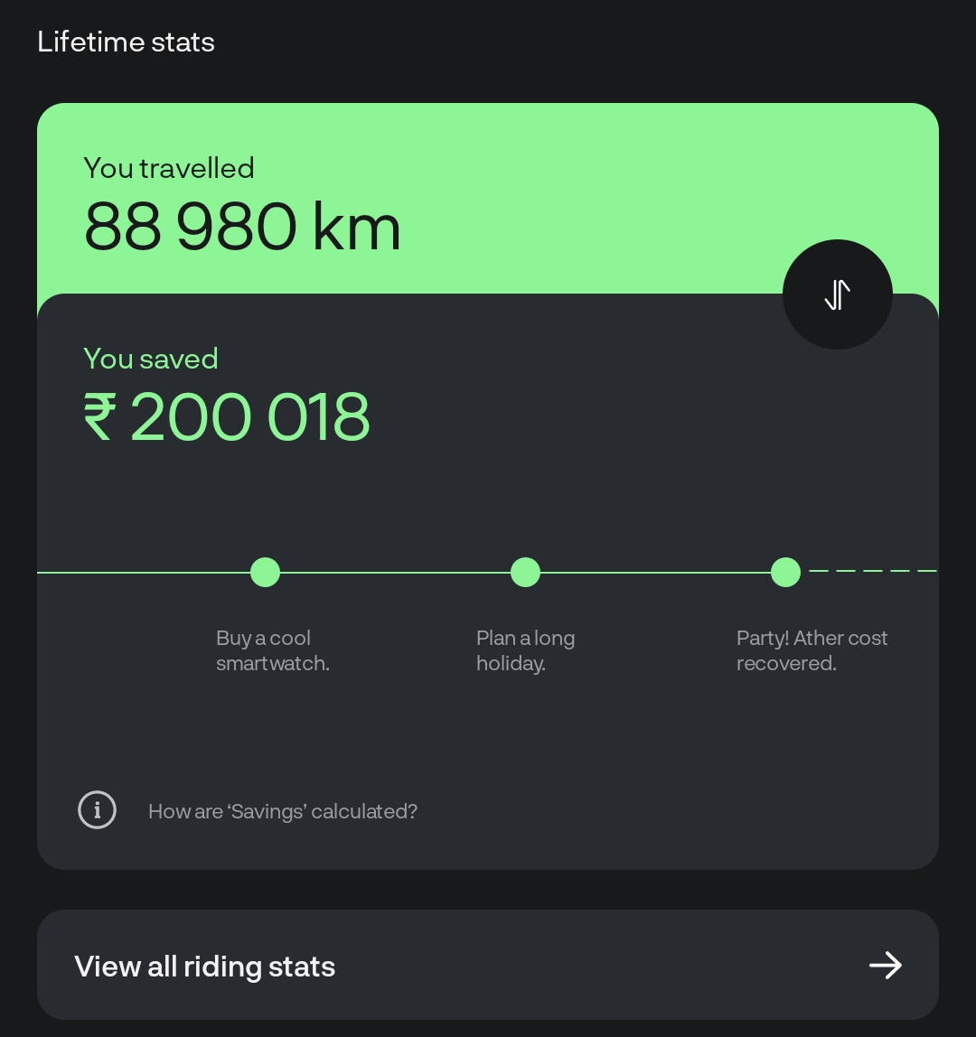

I drove my 450x 32000 km on company fitted belt . I belt tension from myself and teeth is steel looking fine . By Gates Carbon drive App , because service centre is 150 km far from my village.

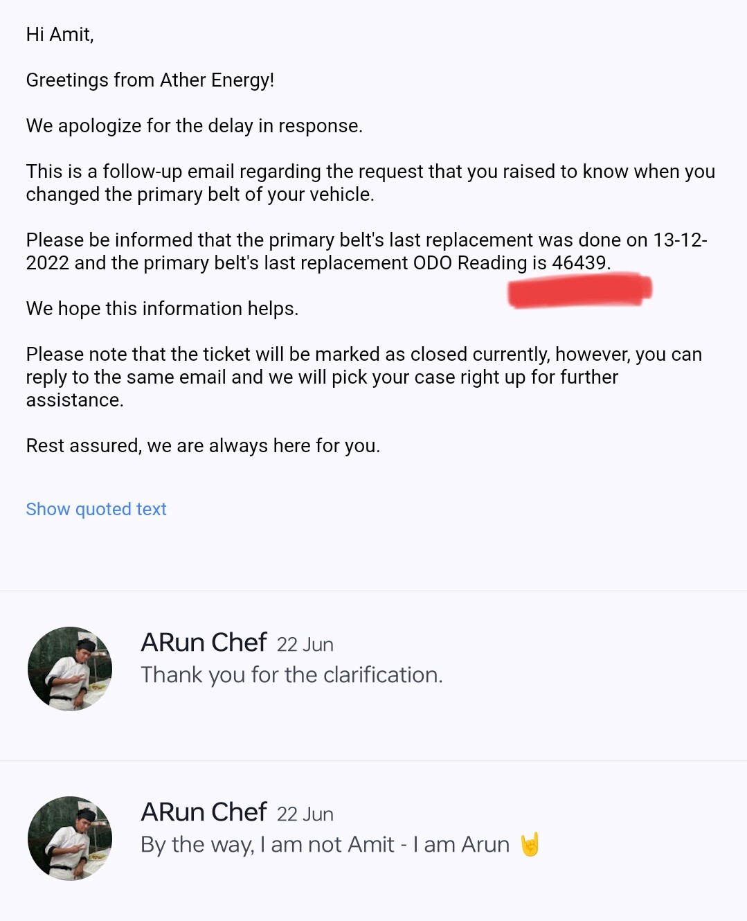

I made this Post for those who mention the Belt Quality is Poor
Fyi
Drove my Primary Belt for about 42,500 KMs

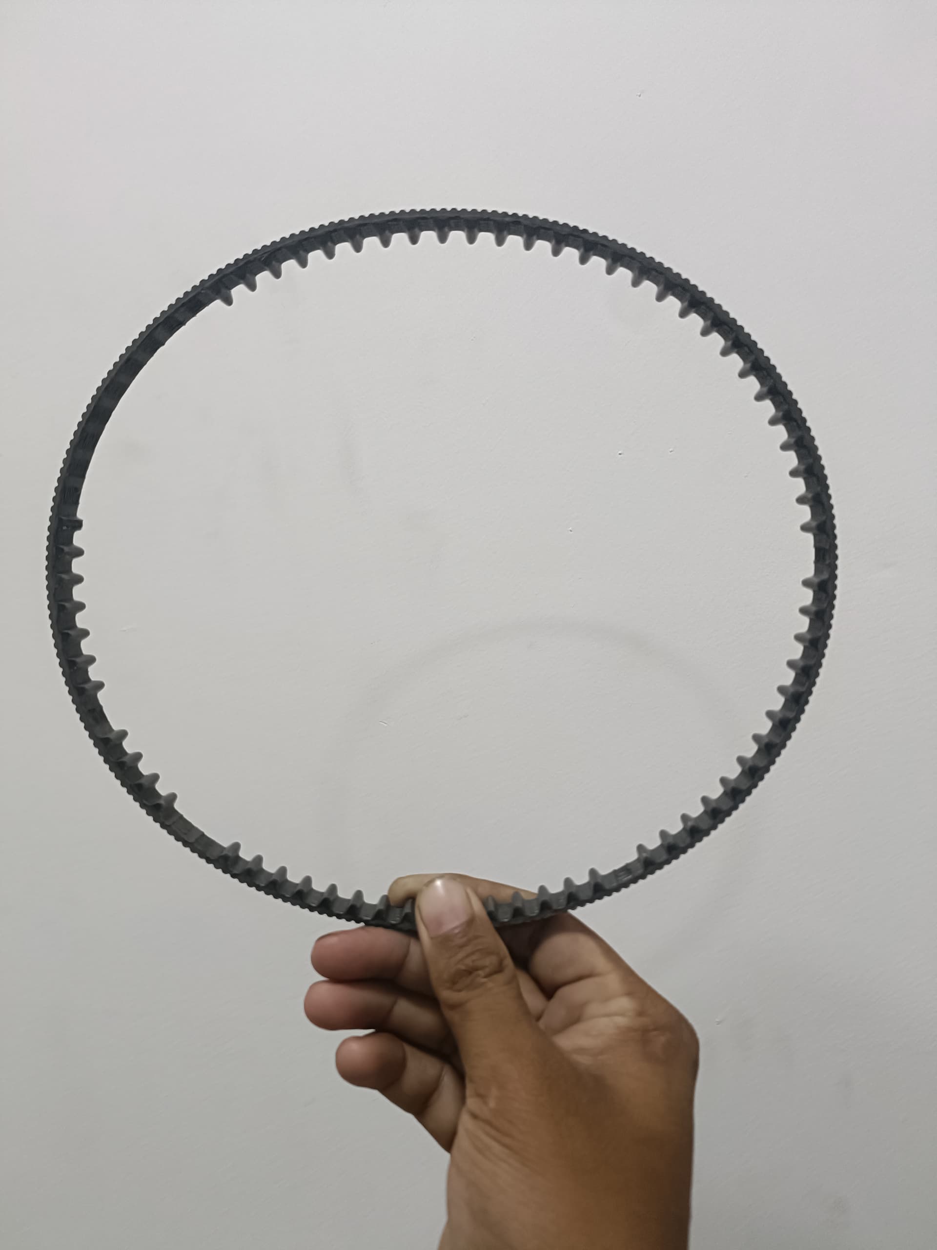

Well,what I noticed that gen 4 have more broader teeth belt,where as gen 3 has narrow one.when I replaced my belt under warranty mine was groove one and yes that one has better quality.But gen 4 was plain one
You Are Right bro. The groove one is gates Carbon Drive belt And its Break very easily ,its very hard so wear off Pulleys as well,
New Belts Are Form Mitsuboshi Brand of Mitsubishi Those belts are Good… :blush:
