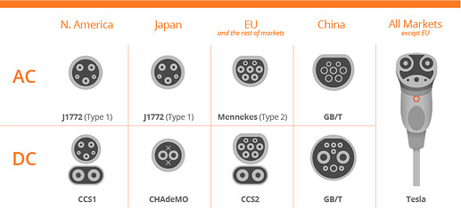

What is name of charging adapter plug in 450x? Is it ccs type? @abhishek.balaji
How much number of battery cells packed under floor board?
It’s a proprietary charger that builds on the existing CCS2 type adaptor.
Here are other charger types in use by EVs today.
