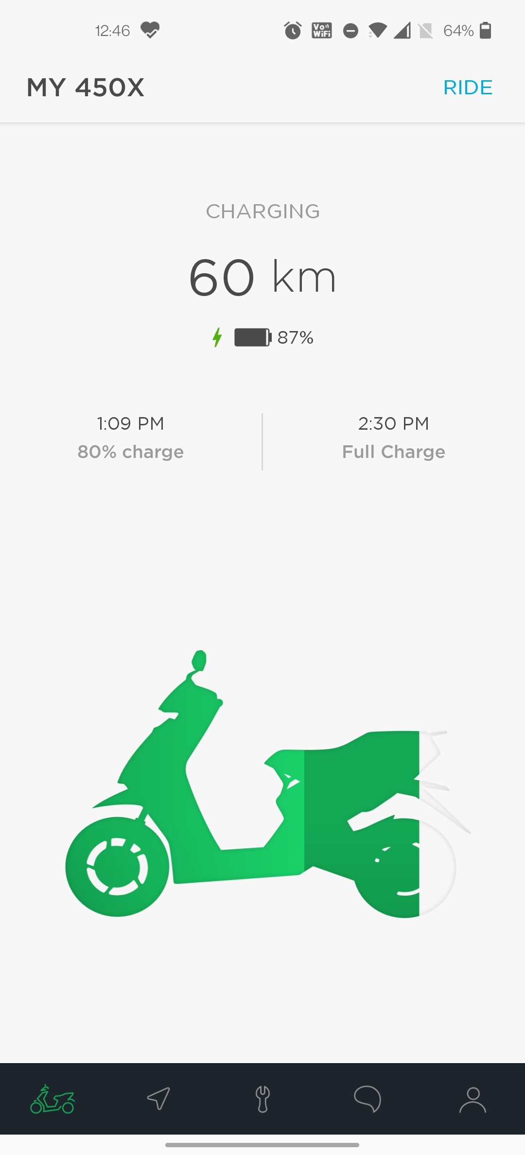

  2. Same as everyone above, the charging time prediction on the app seems to be wrong. I have 87% charge and it’s predicting that I’ll have 80% in another half an hour.

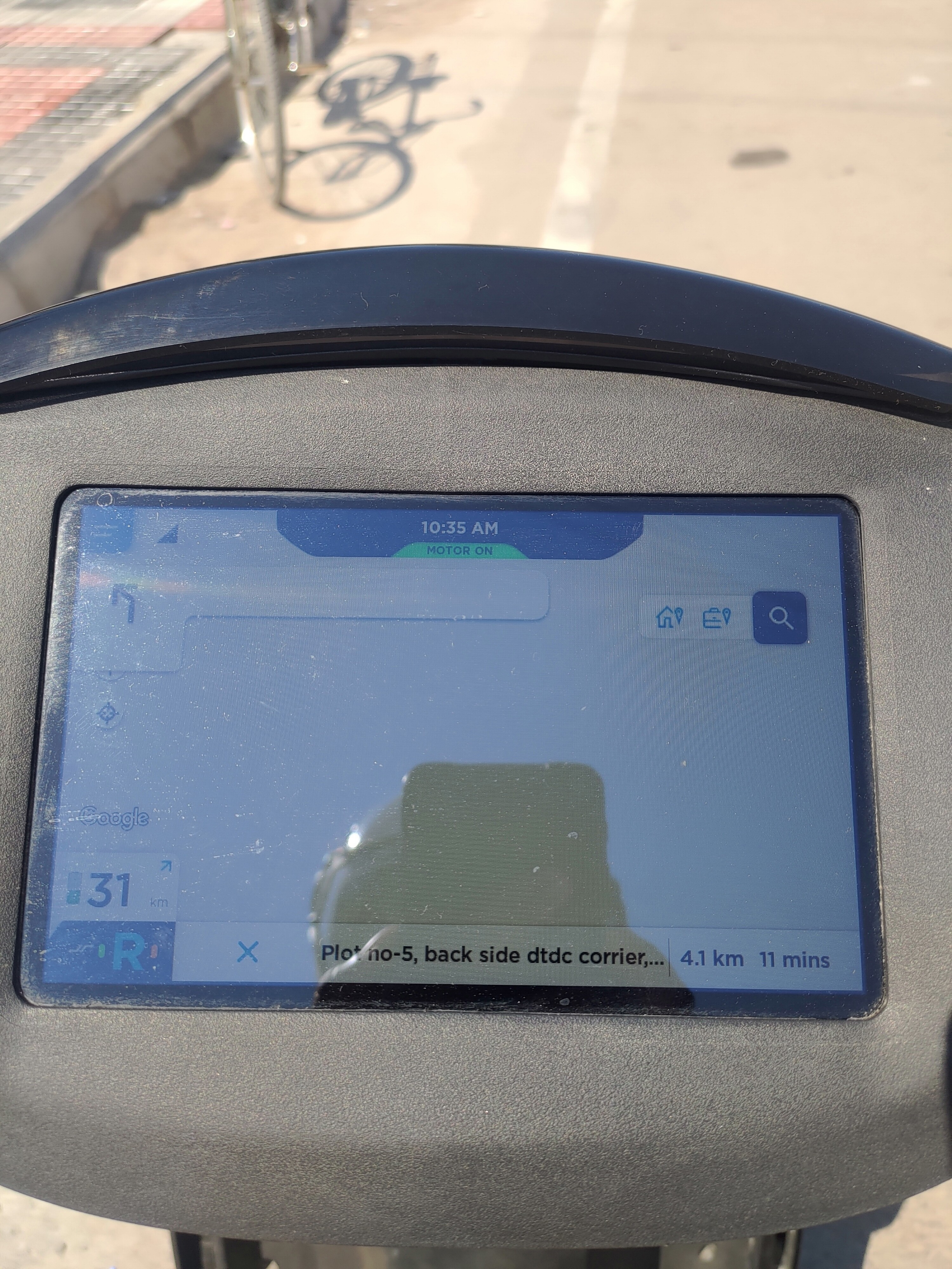

Yesterday while riding in navigation mode, all of a sudden the maps and the directions disappeared. But the basic screen template remained in map mode.
Tried switching the bike on and off multiple times but it did not fix it. I had to do a complete restart to fix it.

  3. Estimated time for 80% of charge shows more than 100% charge - should be reliable if not accurate.

This happened with me last night. I cannot stop my vehicle on a highway trying to figure out if I should take a left or right when I see my dash move from maps to speedometer, that too in heavy traffic. This ain’t a joke guys. If the features are portrayed as brilliant features, please keep up the standards. Earlier updates weren’t so glitchy. I purposefully didn’t go for the beta version of this because I knew it’ll have bugs and I don’t want to ruin my daily commutes. But with the official rollout, that too seems messed up.
