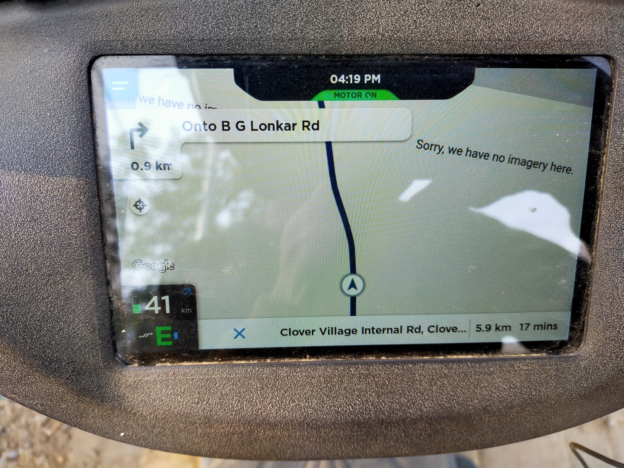

The maps get blank many times i think that the issue is not solved yet and the indicators too it turns off too early before I take a turn. When I apply both brakes to take a turn and the indicator switches off too early before I take a turn please solve these 2 issues at next update it is happening many times

Are you referring to the lack of satellite imagery in the map background? If yes, it’s most likely because of poor network coverage and the bike wasn’t able to download that image from Google maps.

Buts its my daily route it loads everyday suddenly all of a sudden it fails
These are not like preloaded maps stored in vehicle . When ever we give a destination it fetches data from google map API and give you the route and the route gets updated on dashboard as we go forward on the route. As @raghav.srinivasan said this is due to the network picked up by the vehicle. So it has nothing to do with if you are going on a regular route or new route.
This also happens if we are crossing any defence related area as suddenly your network reachability reduces. If we restart maps it loads or works slowly though as we stop aside and refresh it, but while on the go it cannot pick the proper signal in such areas as per my experience in this matter (I faced this and above statements are based on my observation & understanding of the matter).
Maps can be cached on frequently travelled routes, assuming there is enough storage available.
Yes that is true but my point is that here it is not happening like that. We are able to mark favourite places but not favourite routes. I might also be wrong but that is my understanding.
