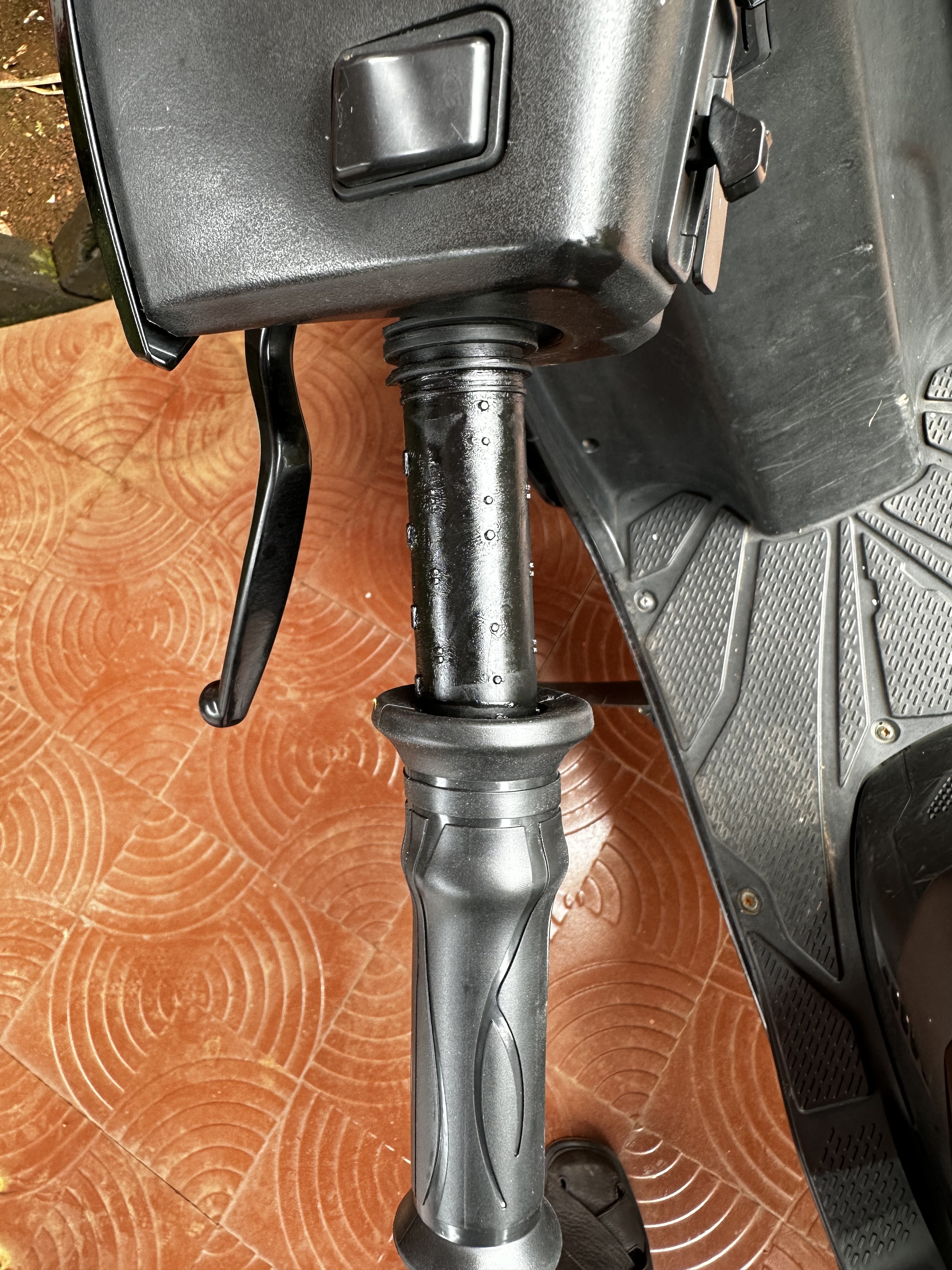

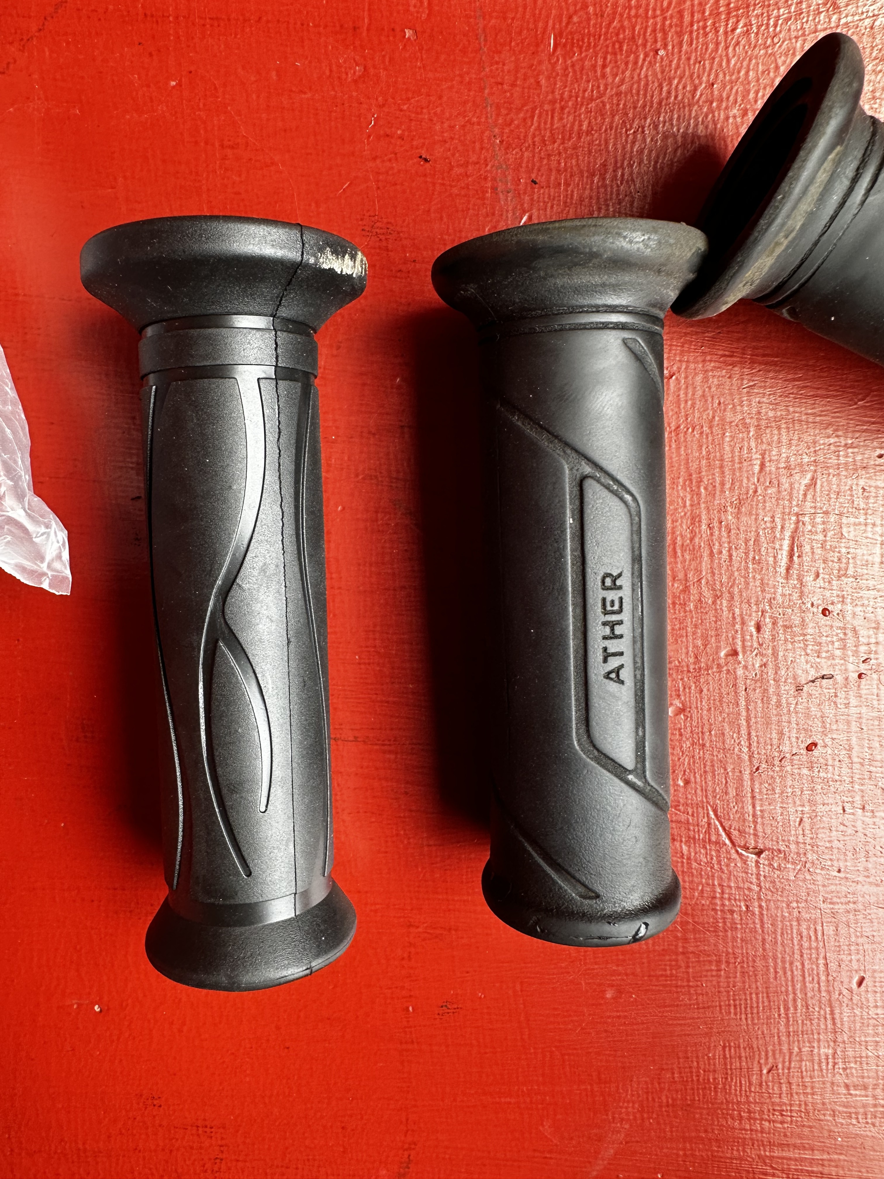

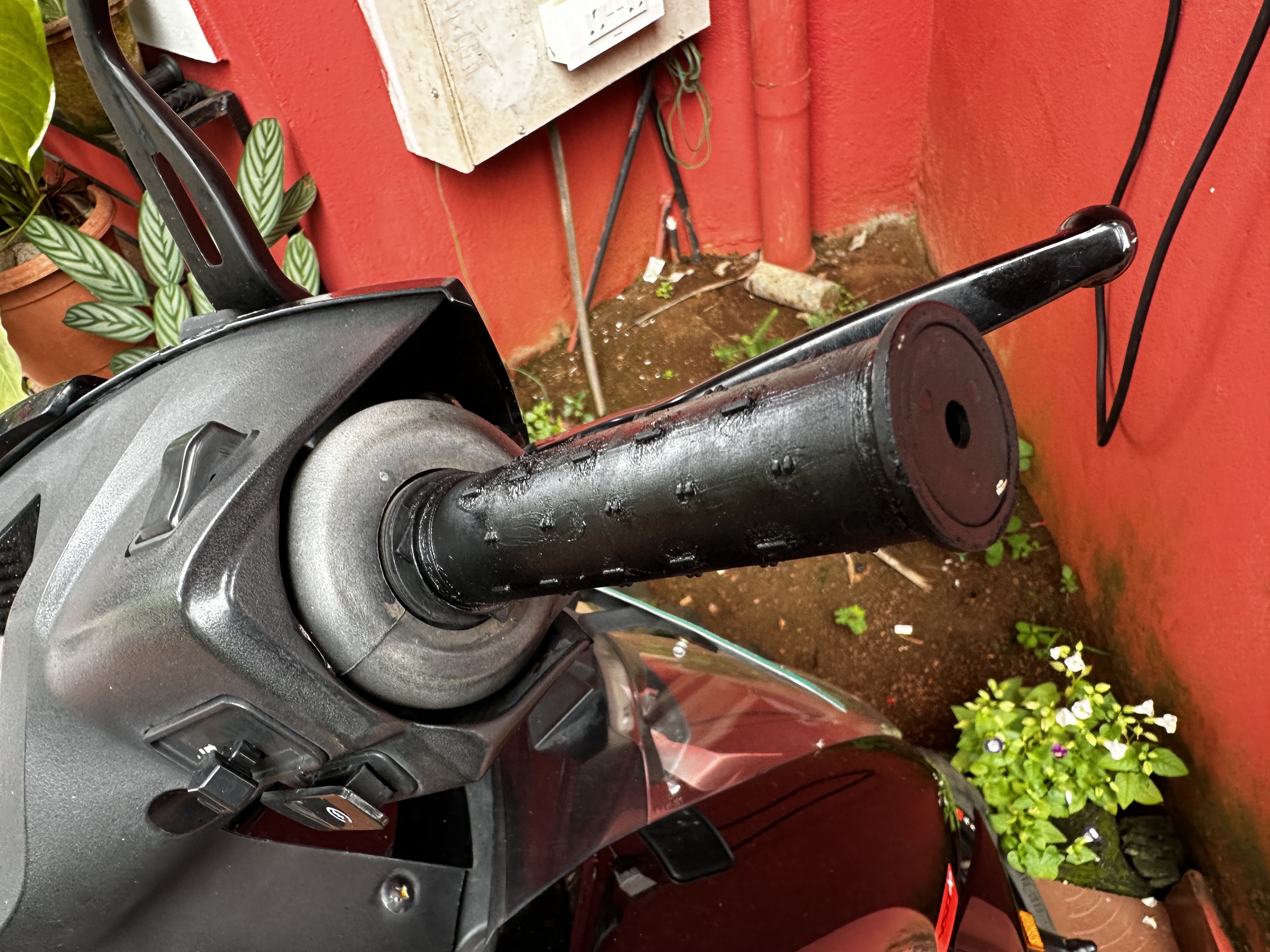

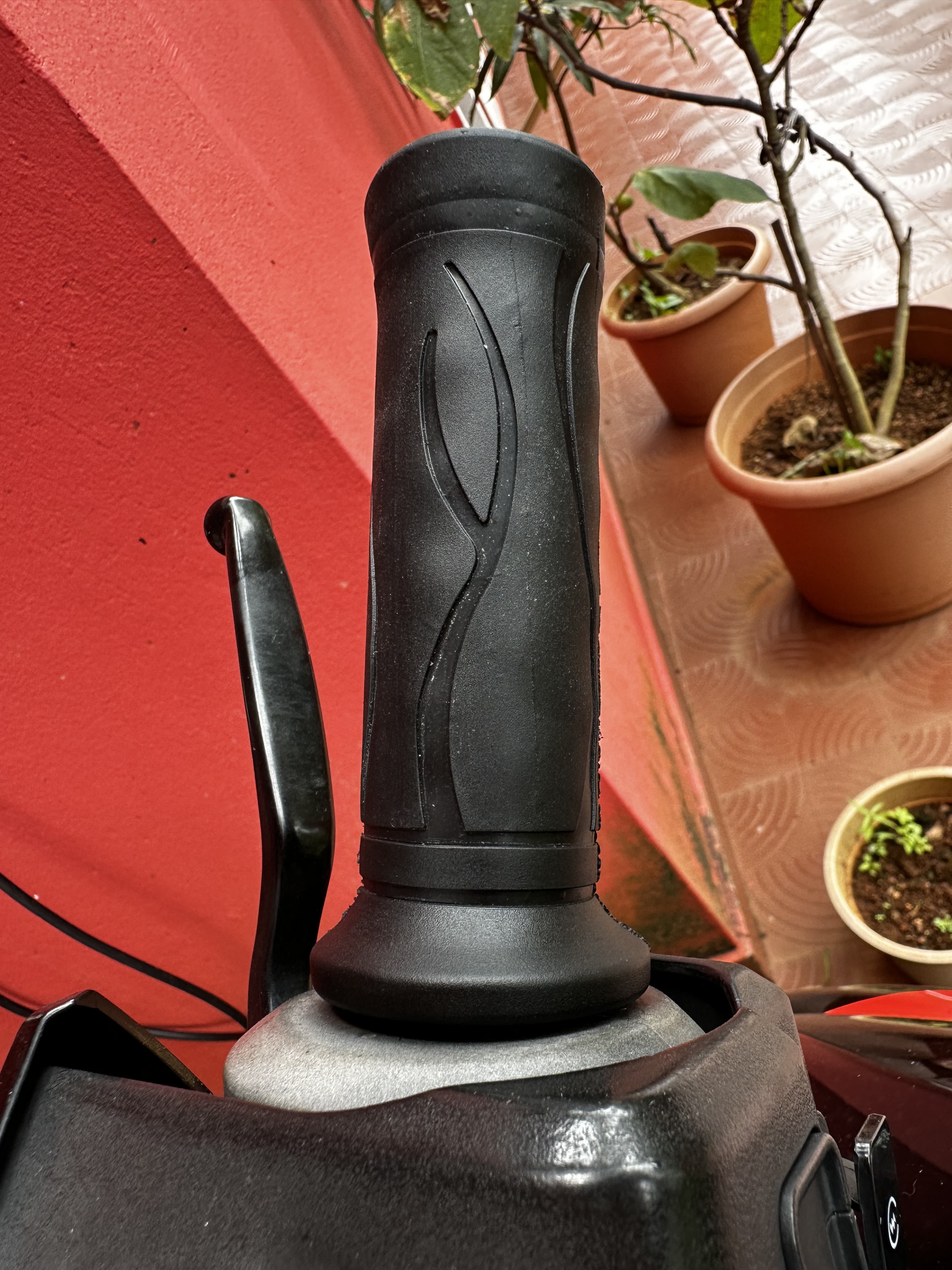

Installed TVS Jupiter grips for Rs.176/-. Saving of approximately Rs.1800/- over original Ather ones.
The grips of the Apache, NTorq, Pulsar NS & Dominar will fit but the outer ends are open because of the bar end weights. The grips of cheaper bikes / scooters are quite hard. Jupiter ones are slightly longer but after fitting they stretch in diameter and length reduces. Finally the fit is perfect.
The original Ather ones on my bike had become sticky.
