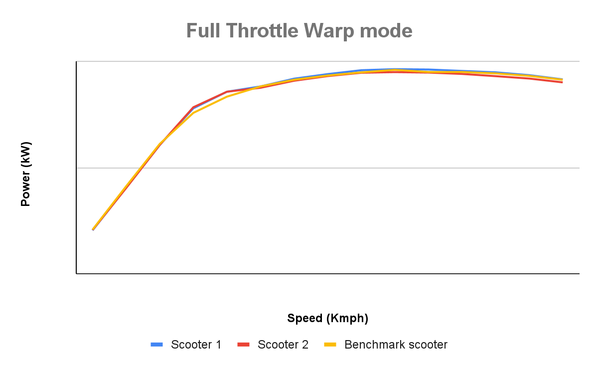

This test sounds fun and involves opening the throttle fully from start, and mapping how the motor delivers the power as the speed increases. Thereās no significant difference in the power delivery between the three scooters - our benchmark 450X, White 450X and Series 1.
As you can see our beloved Warp Mode is still delivering the peak performance levels as expected. This graph should also illustrate for some of you, how the torque delivery happens as the speed increases.

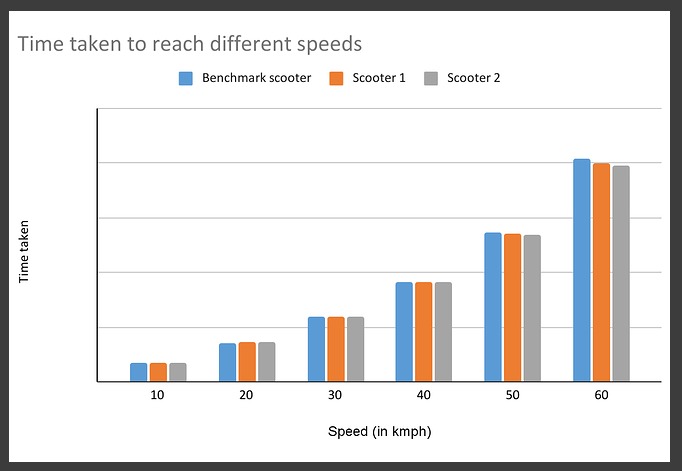

Here again, we compared the time taken to hit different speeds between the three scooters, and thereās little to no difference in the timings.
