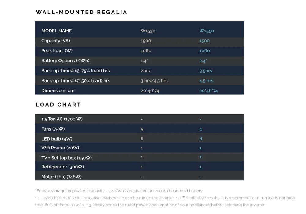

Thanks I saw the post earlier I was looking for official version of the specifications which seem to be missing on the Ather webpage or documentation . e.g. pf is not mentioned so Watt is not the real measure it is only active power reactive power plays a big part and also dictates the inrush current
Most chargers are either pf compensated or PWM for PWM charger it puts a bigger strain on inverter electronics as the fault level of inverter working in stand alone mode is very low . To put simply although normal AC is 1.5 KW a 2.5 KW inverter cannot handle the starting power . If you use an inverter air-conditioner which is soft start and Pf compensated even 1.5 KW inverter will work
same reason if you see above specs a 1500 VA inverter cannot handle 1 HP ( 750 Watt) pump motor

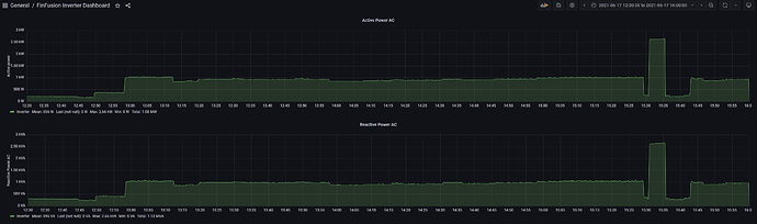

@anil.ghatikar, to anwer your question on the surge of Ather Dot, please find the attached screenshot for Active and Reactive Power. My Home Active Idle Power : 200w Charge Start Time: 12:50PM Dot Power Consumption: between 700-750w You can notice the Active and Reactive power remains constant with charge cycle. Happy to give you more data.
