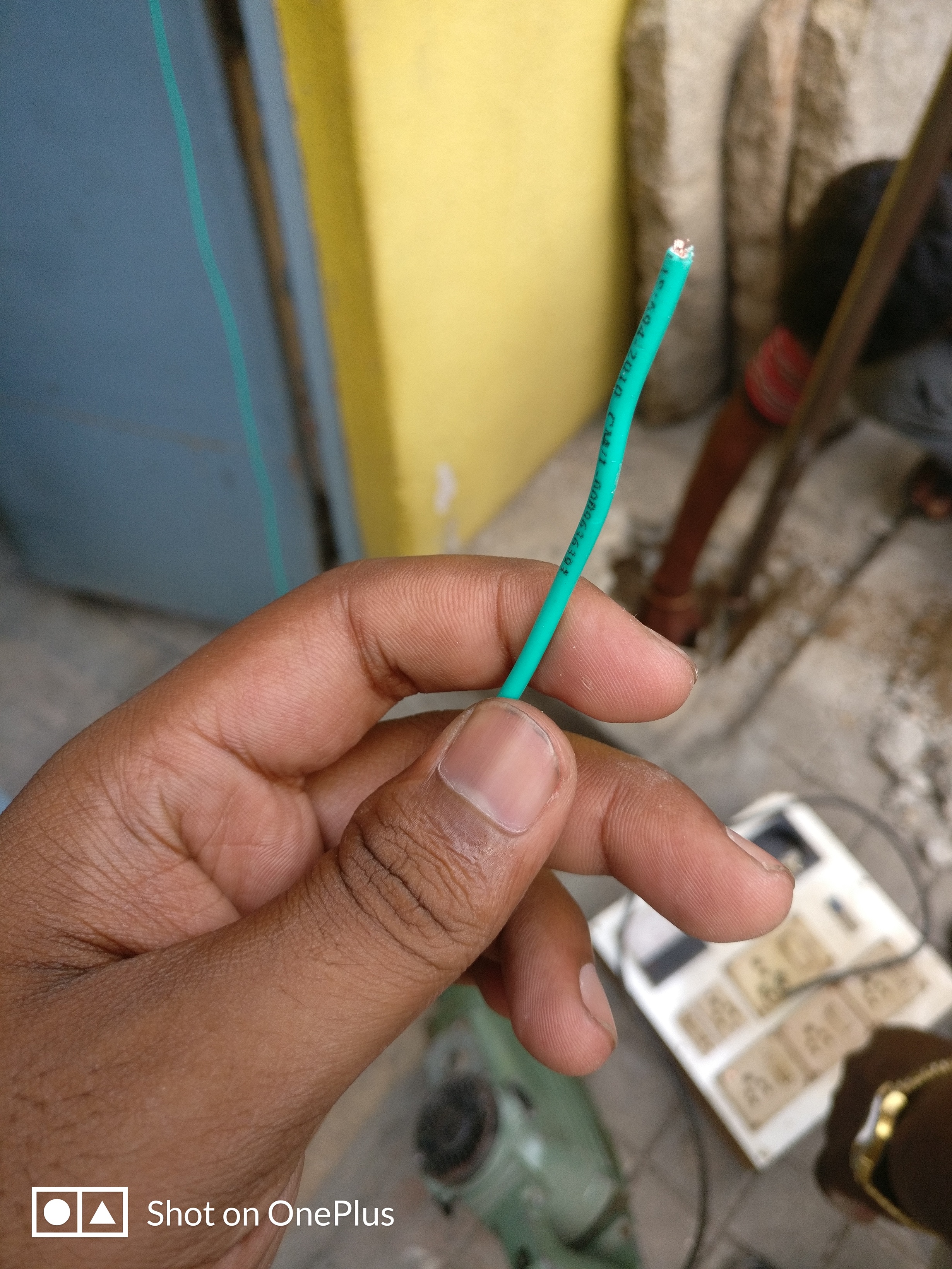

  1. Earthing Copper wire [ Ather Non - Standard wire. I purchased personally ] and Electrical Wire.

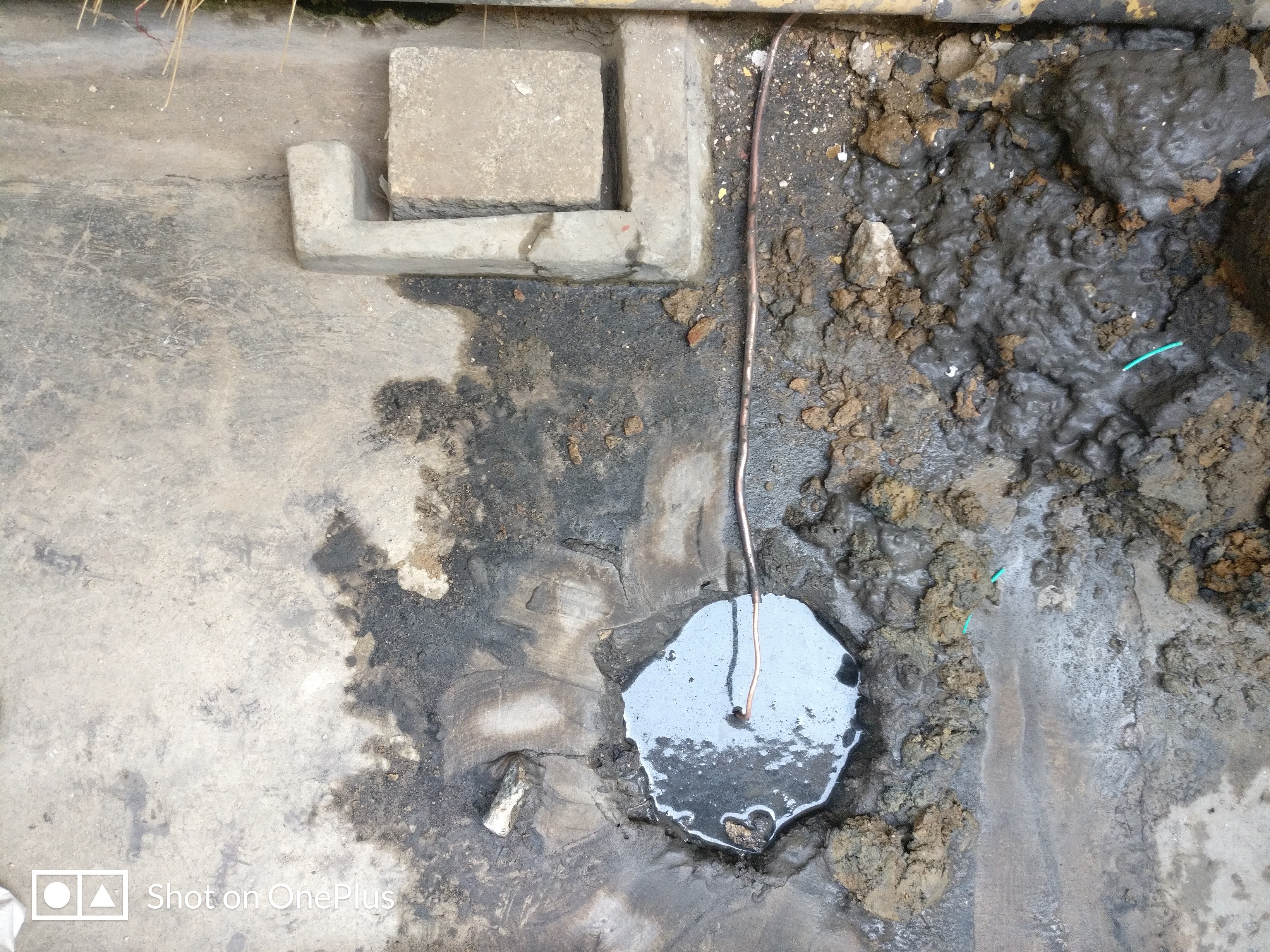

A) Started with Earth Hole digging bar to dig the earth hole. We need to do in 3 places as
1st hole failed due to interior sanitary pipe connection pipe found and 2nd failed to due
to rock came up in middle and not able to proceed further and dig 3rd hole which was
successful without issues.
   To reduce effort of employee and time who was using manual bar for his work. We
   provided machinery equipment to take care of activity.  [ Since my father works in
   construction field so we were having machinery equipment called [Demolition
    Machine ]
B) After digging the earth hole, exactly in middle inserted with Earthing Electrodes [Rod]
and remaining places of completely filled with 25 kg of Ground Enhancing compound
[Chemical] and used water to set and waited until it get dry.
C) Previous places which was digged was closed by vendor and all set his job completed

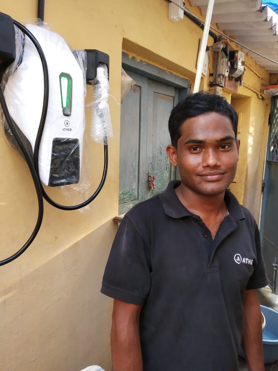

III) Lokesh ensure electrical wire are properly placed in wall and test the connection immediately turned on MCB, The hidden surprise was home charging point started flowing from RED to GREEN
Real happiness is making the things to happen and my sincere thanks to Lokesh in this picture. He was very polite, smiley face and patience he did 2nd day Ather work very Awesome !!!
