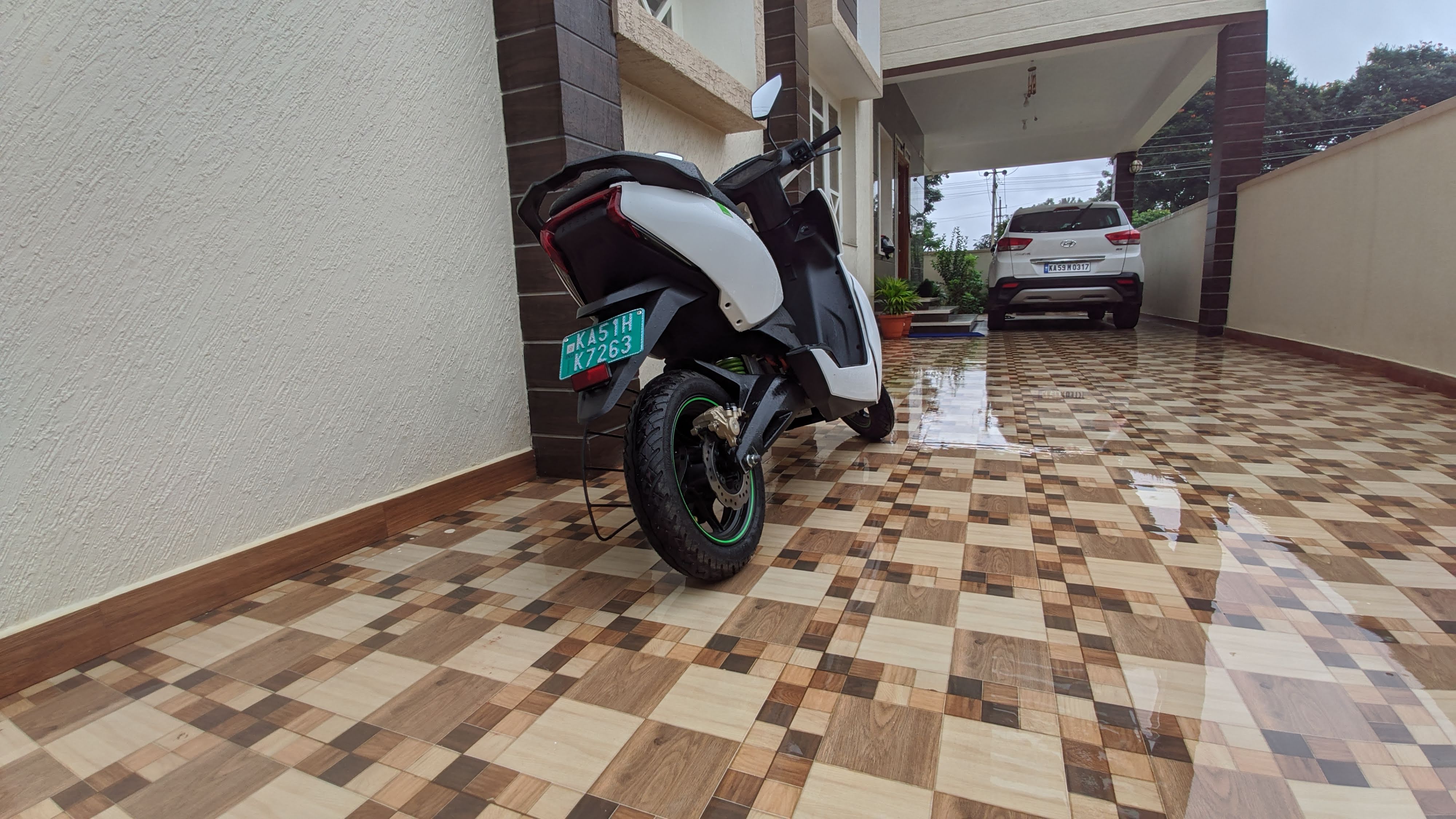

Charging Area
Some pics in different angles
MVIMG_20191130_144318|690x388
