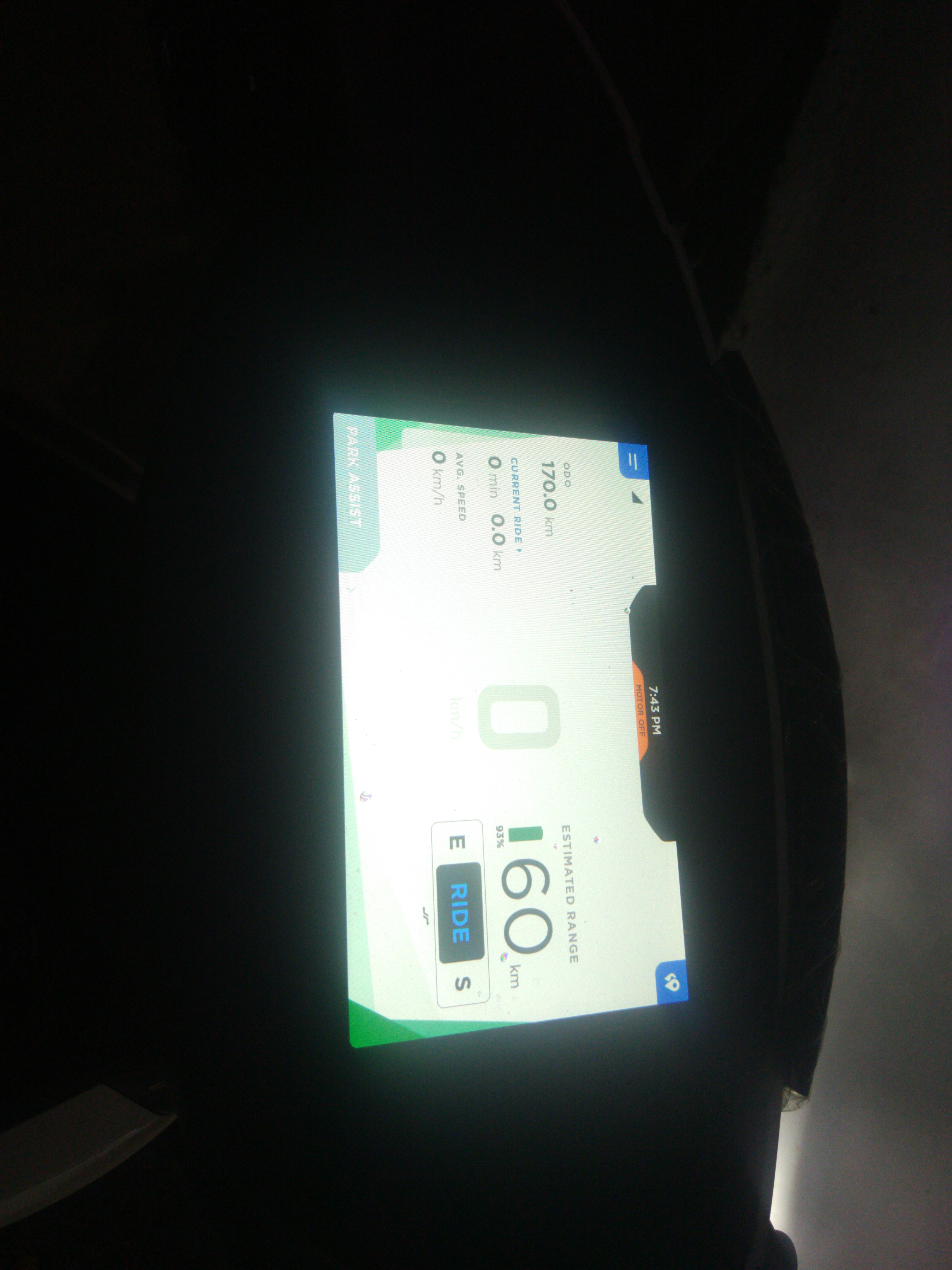

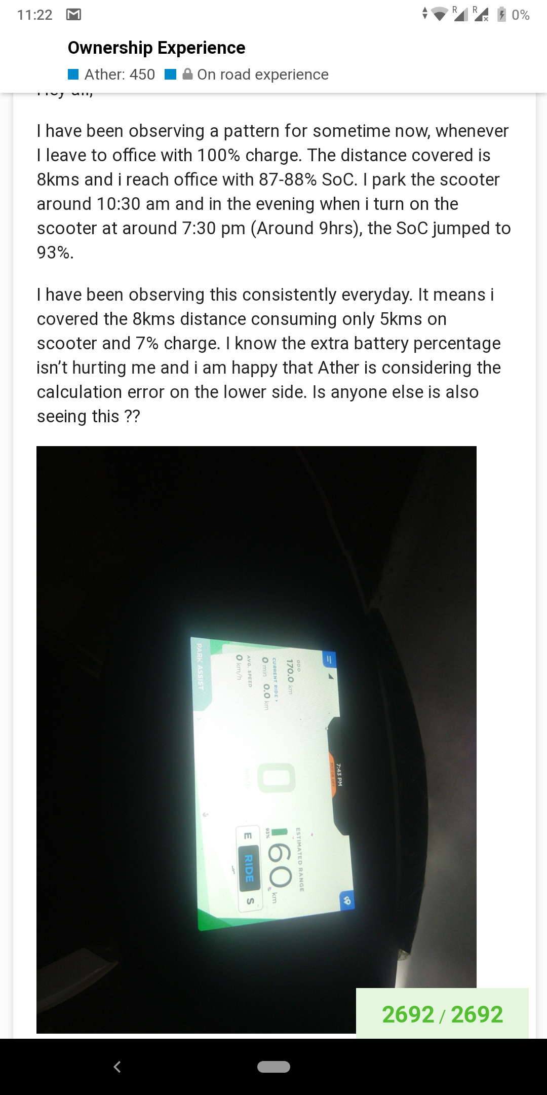

Hey all,
I have been observing a pattern for sometime now, whenever I leave to office with 100% charge. The distance covered is 8kms and i reach office with 87-88% SoC. I park the scooter around 10:30 am and in the evening when i turn on the scooter at around 7:30 pm (Around 9hrs), the SoC jumped to 93%.
I have been observing this consistently everyday. It means i covered the 8kms distance consuming only 5kms on scooter and 7% charge. I know the extra battery percentage isn’t hurting me and i am happy that Ather is considering the calculation error on the lower side. Is anyone else is also seeing this ??
Picture clicked in the evening, left home with 100% and drove for 8kms
i am reading your post with 0%battery on my mobile
joke apart, have experienced this kind of behaviour multiple times
but not very often i see this
since u are observing this everyday mau be you should report this to service team
Haha, @Abhishek, i guess you like to test all your gadgets to extreme !!
Coming on the increasing range and battery, i am actually happy that it’s happening. Will the increasing behaviour not stop if Ather rectifies it ? … And the extra range i am seeing is not just for sometime, i can actually drive the vehicle for 3 kms like the normal range !!
