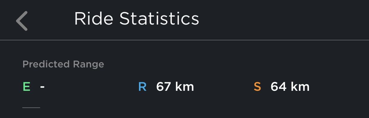

Folks check out the predictive range in the app ride diagnostics, the difference between Ride & Sport mode is just 3kms. What do you guys think? Is this realistic showing right information?
It is very much possible. It considers your last X rides in each mode in calculation.
You go in sports mode but don’t utilize the acceleration much…
You go in ride mode… Got stuck in bumper to bumper traffic. Now sports mode might look more efficient :slight_smile:

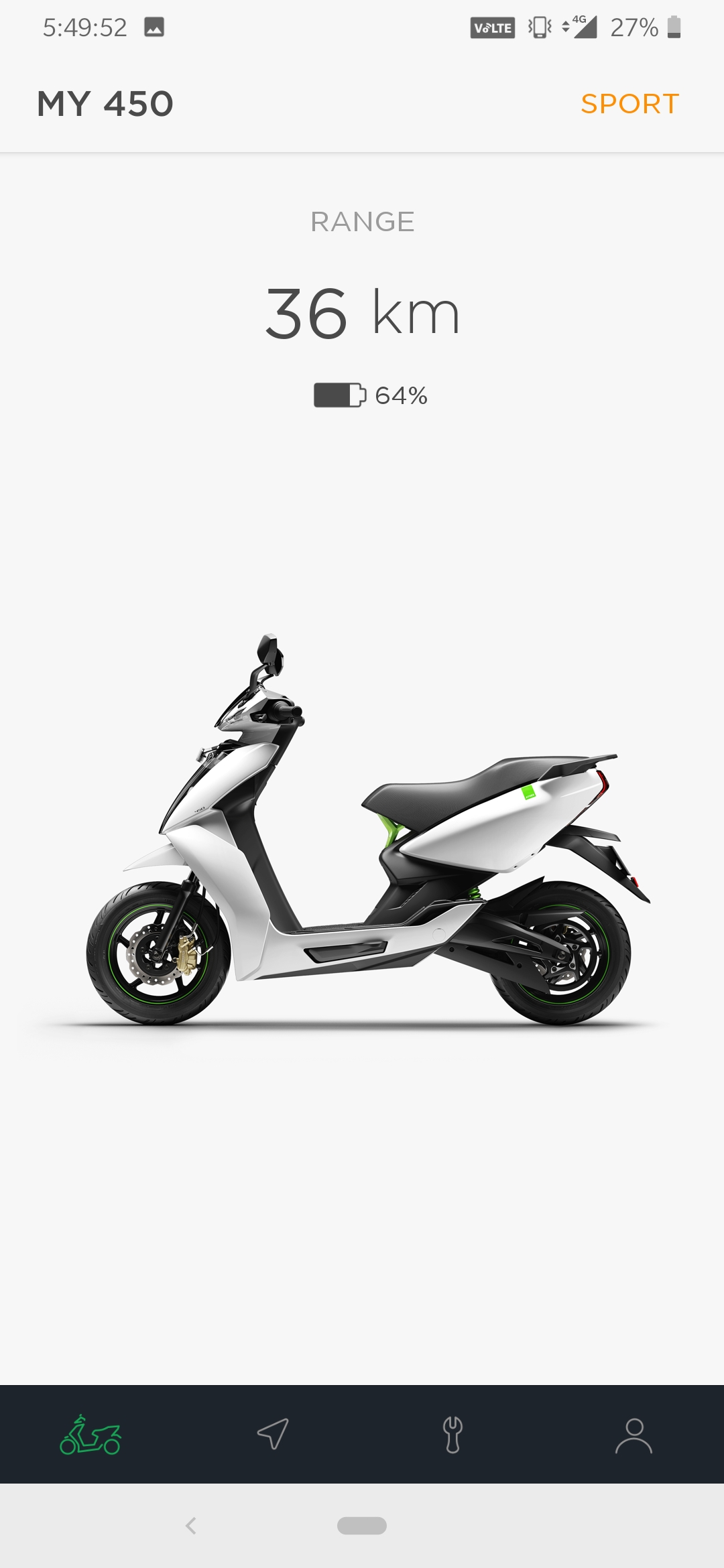

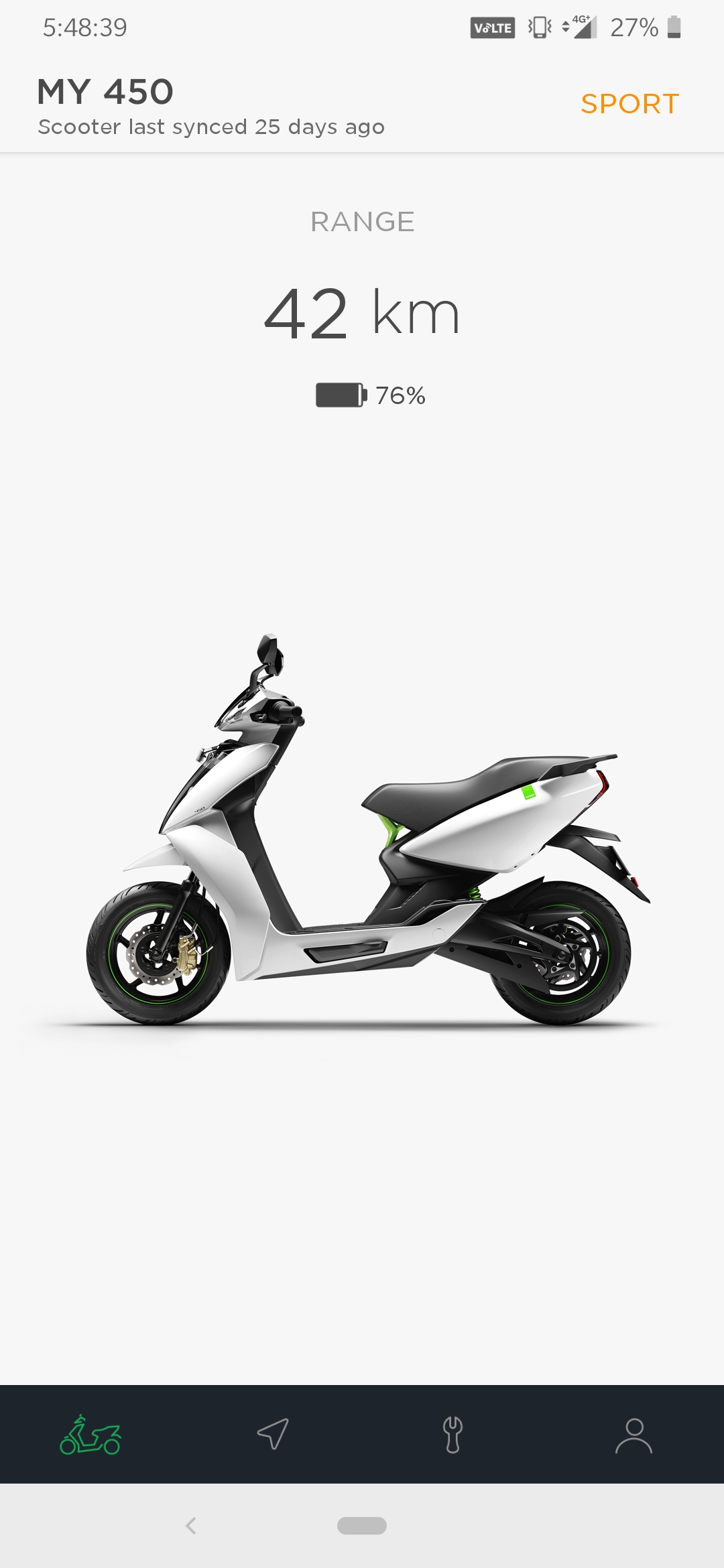

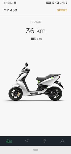

25 days in shutdown mode And 12% battery discharge !
