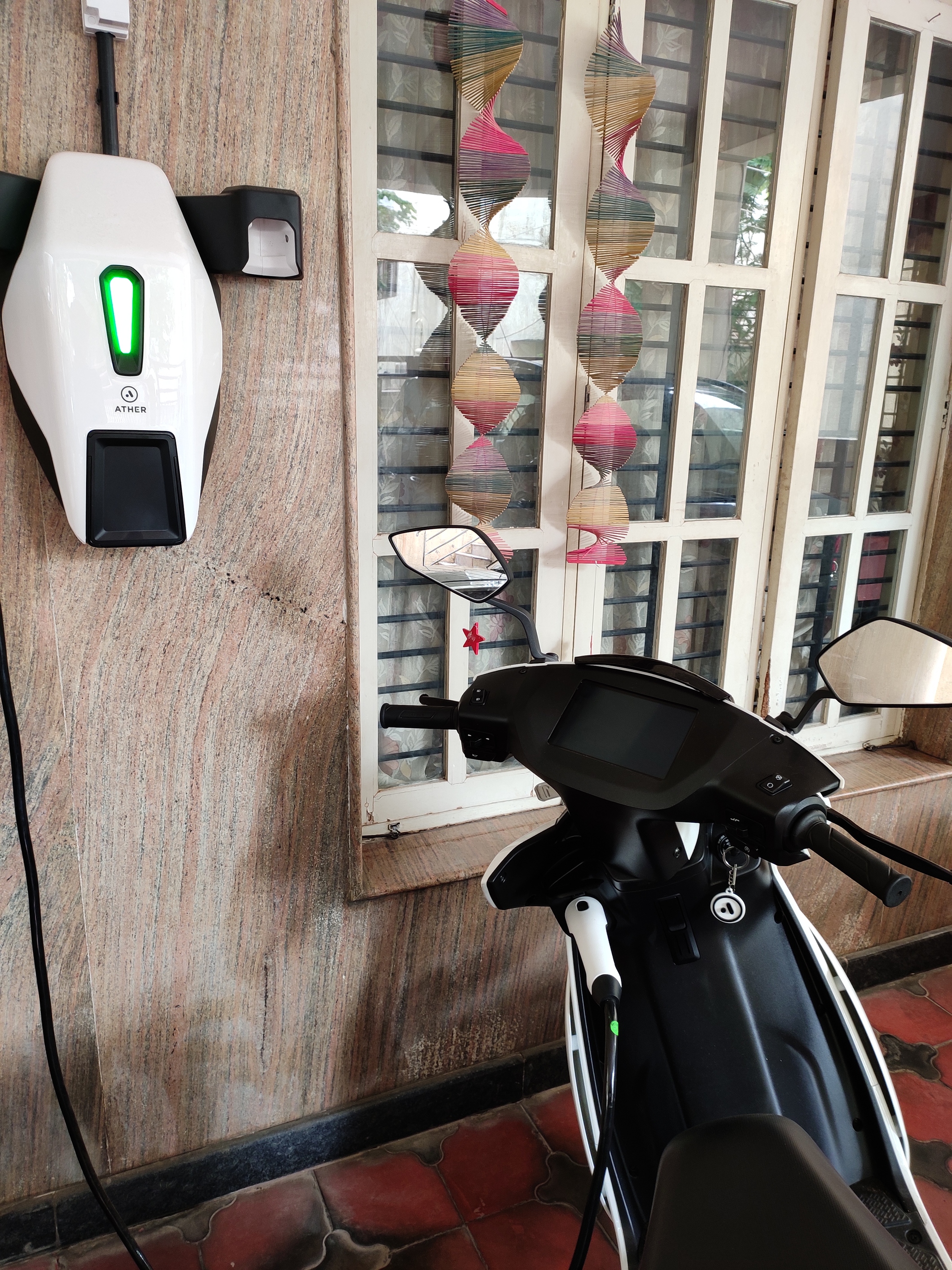

I’m not able to turn on my ather since morning. Yesterday I put if for charge and removed it at 96% and shut it down thinking I won’t be using it for the weekend. Now I need to go somewhere and it’s not turning on. No response from the dashboard. No power on chime or anything. When I connect it to the charger, it starts blinking in red and switches to green after a few seconds. I tried the hard reboot and that didn’t work as well. Any idea about this?
Call support. A few people reported the same at around 96%.
Same thing happened to mine as well I think issue is with bms and battery pcb which were replaced and it took nearly 9 days for them to resolve this issue.
Oooof. Did you get a loaner?
Yeah just a day before they delivered my vehicle back.

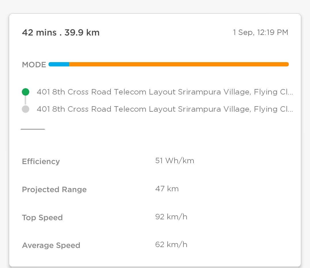

i took experiments to extreme and motor gave up
so they need to replace it
have done quick test to check new motor performance (if it will be any better)
so generally my motor use to give reduced performance when nearing 20km stretch with continuous top speed
new motor was able to deliver top speed until 22.8km where i noticed drop in power
conclusion: aging of motor matters
I would suggest turn on the key and see if you hear boot up sound… If not leave the vehicle for 5 to 10 min it should fix itself…
No luck. Tried everything. Kept it on for 10-15 minutes with and without charger. Not sure what went wrong. It was absolutely fine till yesterday.
For me I left it for over night charging on next day morning when I tried to turn it back on vehicle was dead no response nothing. Customer care after asking me to try to charge through portable charger then took vehicle for service. Maybe you can try with portable charge to see if it turns back on.
