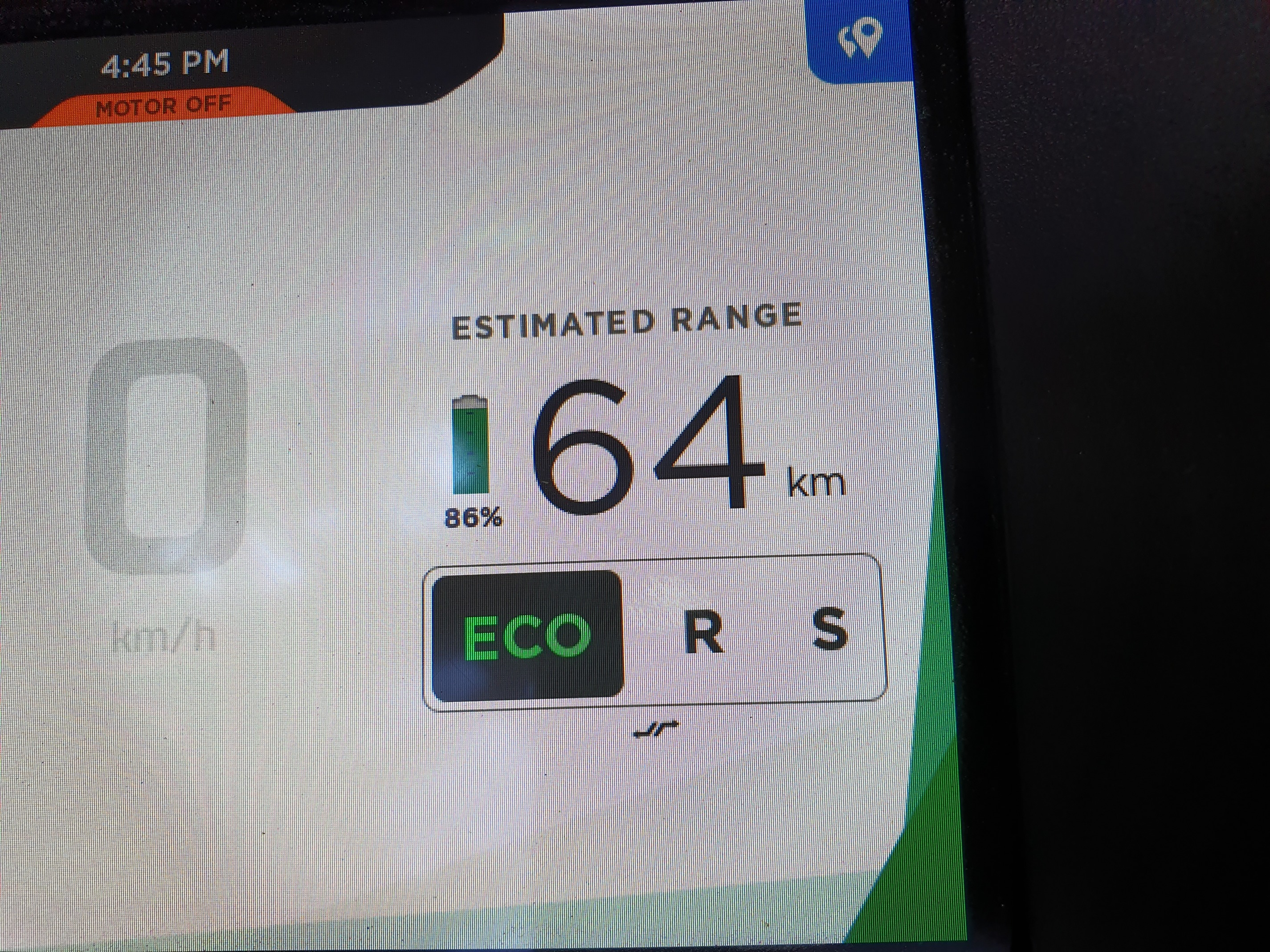

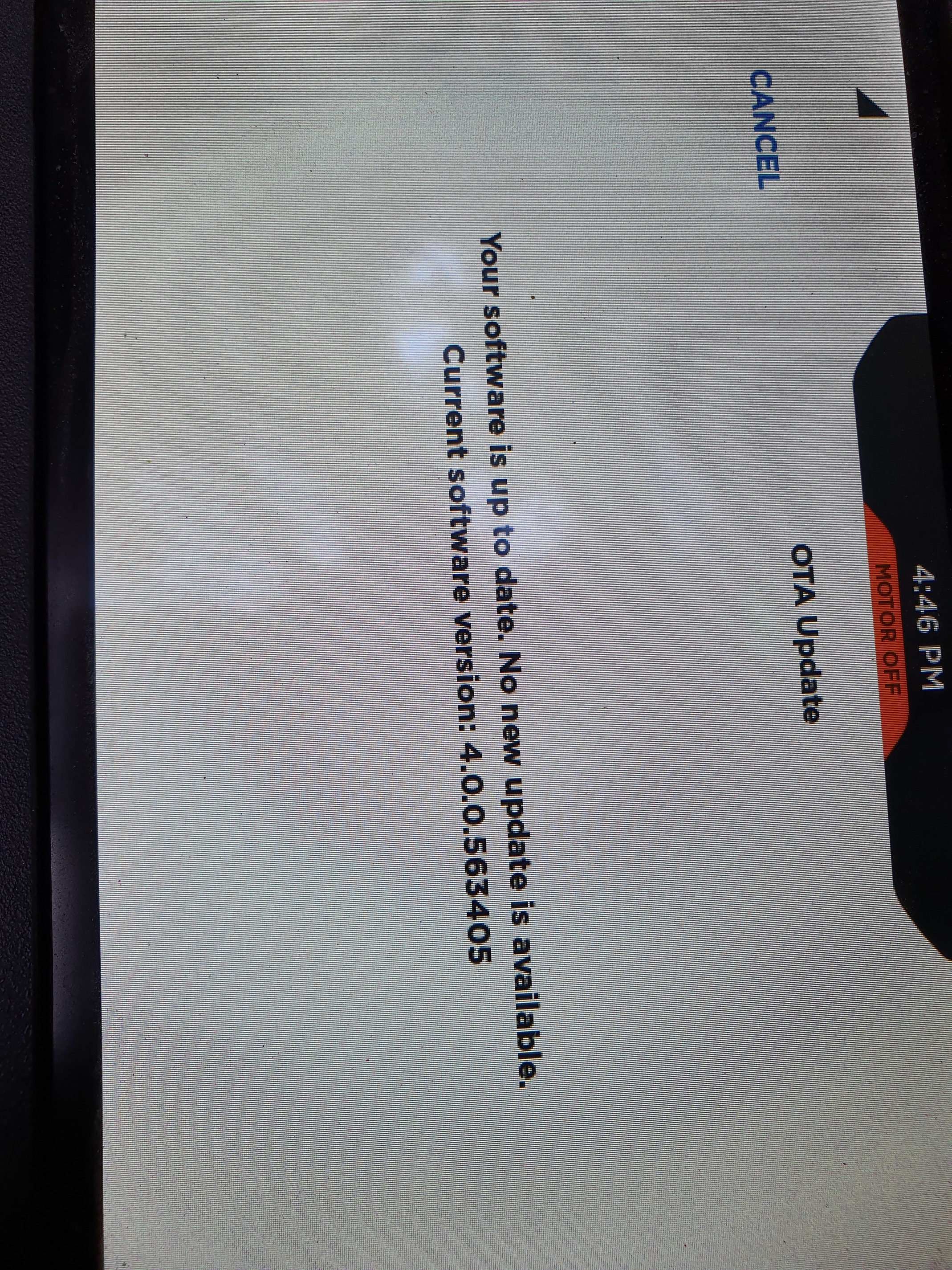

So new OTA is already on their loaner vehicles.Pick Up in sport mode in this 4.0.0 is amazing it is instantaneous no hesitations like my vehicle.

Could you please tell me when this update is released as i am unable to do it though mine is a loan vehicle

He is talkig about loaner vehicle not a loan vehicle. Loan, lease, outright purchase all are same when it comes to OTA updates.
Loaner vehicles are vehicles given to customers when their vehicle is in for some service/repair as a temporary backup. They are generally company vehicles and may or may not be running the normal version on firmware. The new OTA update with Eco mode is expected in September.

hi when and how you got this update. still in my app it is showing Software is up to date! your vehicleâs current software version is 2.0.1.534025
Its loaner vehicle (like replacement vehicle) from Ather so it has update. You can read @hemanth.anand post above
