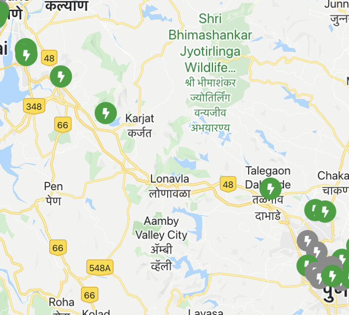

Ather has started to set up grids on highways!! What ride style would optimize the travel time on long rides that require multiple recharges?
Mumbai Pune highway now has three - Panvel, Chouk, Talegaon - see below. The distance is about 160km, but rider will need 2 stops to charge (Chouk and Talegaon), since the exact midway point doesn’t have charger yet.

Interestingly, most optimised time for this journey is riding at 60km/h where possible!! It will take longer time when riding slower or faster.
