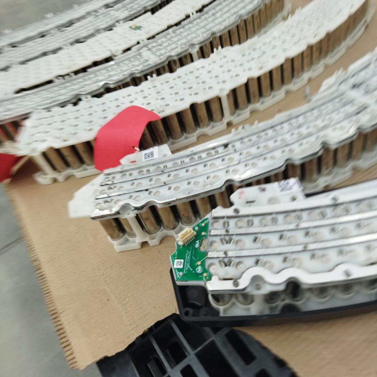

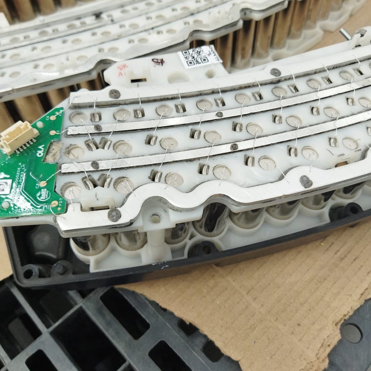

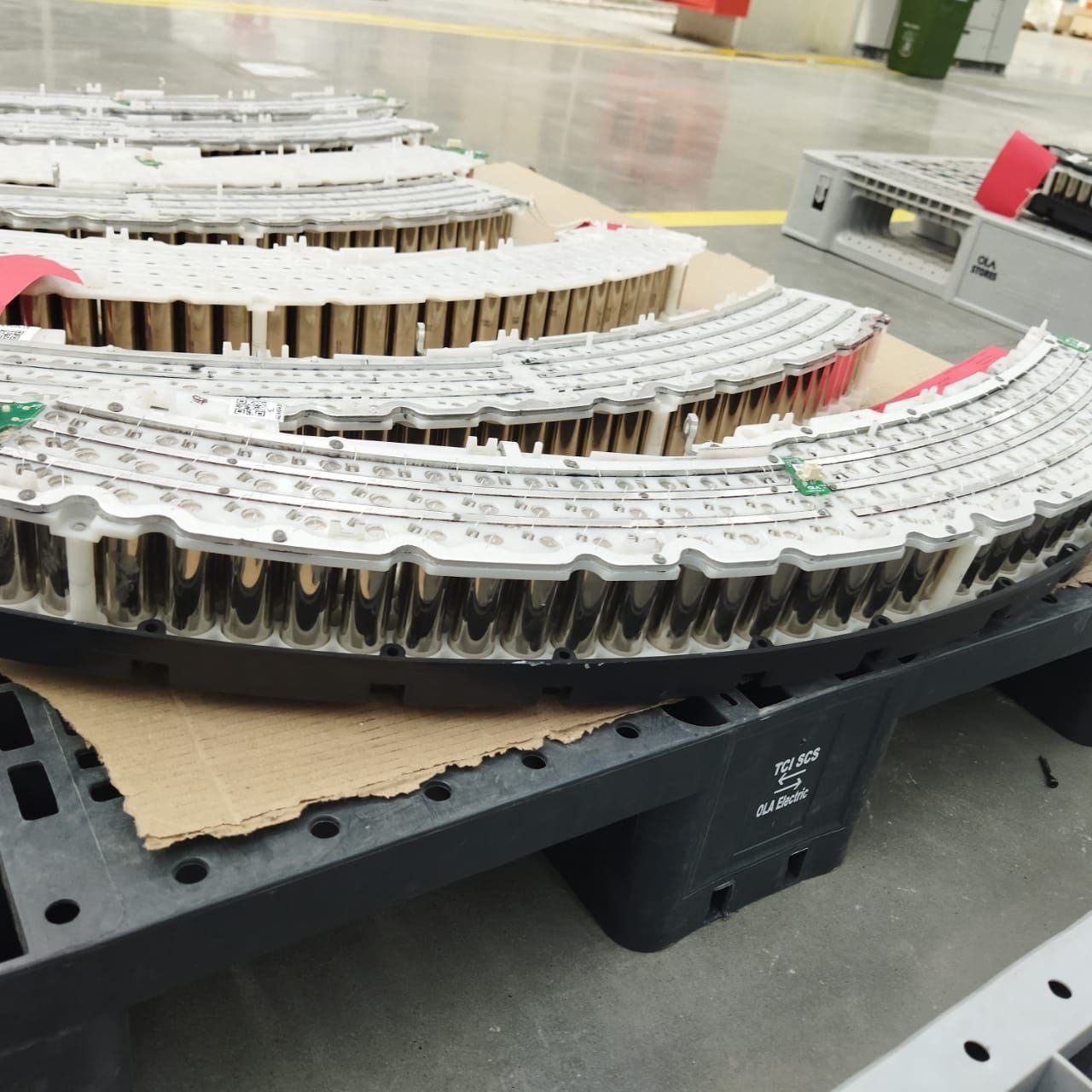

While Ather uses 14s12p (2.9kw @ 51.1v nom) 168 cells in total . ola uses 14s16p pack. (3.9kw @ 51.1v nom) 224 cells in total . Yes they have same voltage battery packs . They expect a the same efficiency of 30 wh/ km as Ather. 3924.48wh(battery capacity)/131km(claimed range) . They both use 21700 li-ion cells. Since they have a big battery they haven’t kept any buffer like Ather. It would be interesting to look what they do with S1 model since it has a smaller 3kw battery. Would they risk using complete battery capacity is yet to be known with their S1 model.

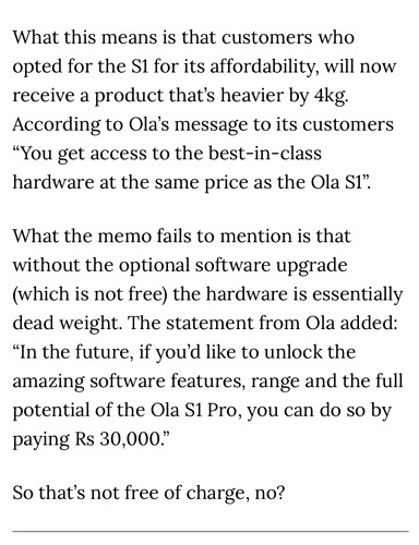

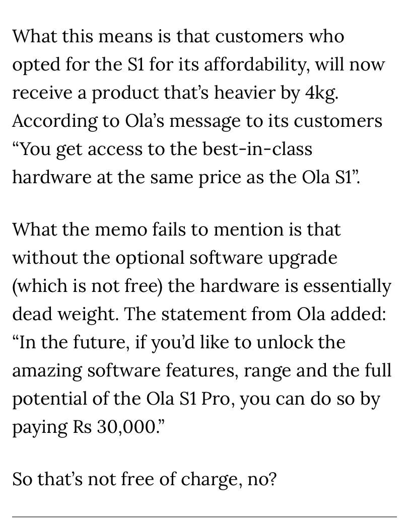

It’s the same battery pack being used for the S1 as well. It is just software restricted to a lower capacity.
That’s mostly not the case because of the price difference between S1 and S1 pro. They have never said S1 can be upgraded to S1 pro at a later point in time.

How much the 4 kg extra weight really impacts the range? At most 1 or 2 km. But it also gives longer battery life and lower degradation as the buffer capacity is now much higher compared to a smaller battery.

Ather does the exact same, 450+ and 450x share the exact same hardware, with software limitation. It makes more sense to lock it rather than to have 2 separate manufacturing lines which complicate things.
I knew Ather did that. since the price difference isn’t much.
Not necessarily since it’s just the no of cells in parallel that is different. The same BMS would just work fine , they would save a lot of money by this.
It isn’t, considering that they may take up to 2p of cells out, so 14 * 2=28 cells which might cut the cost 28* 250 to 350. ea which is somewhat 7000-9800, now if they are both on a single line of manufacturing they lose this much but they ramp up the production and don’t have to bother with storage, a separate line for low demanding 450+ and separate storage unit of it.
To put it in simple terms A single line of manufacturing
Same battery-Same hardware-Same Storage- just final software lock will do
a different line of manufacturing just to save 10k

. They can duck the 4kg dead weight issue (if it grows too loud) by updating the software to increase battery capacity proportionally to counteract that 4kg.
