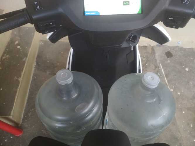

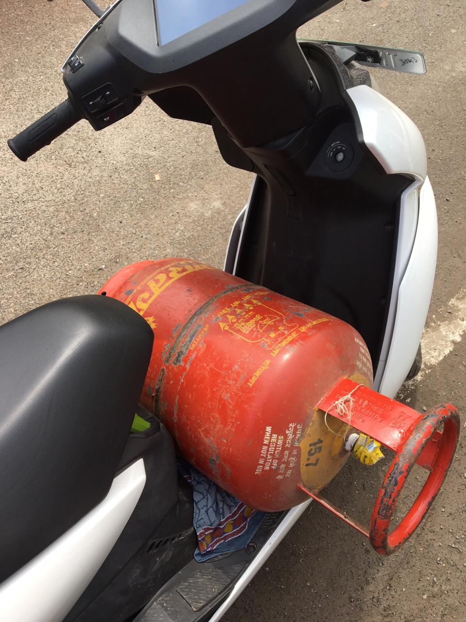

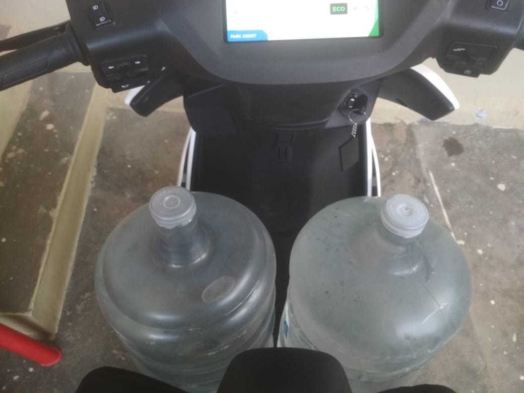

Photo @HarshaVardhan
Photo @frozenprakash
Photo @muthu_km2001
yes absolutely but the weight of LPG is around 18-19 kgs avg it wont affect but it will ram the plastics and inner plastic panels so our scooter is mercedes like in 2 wheeler so we can handle it luxury
