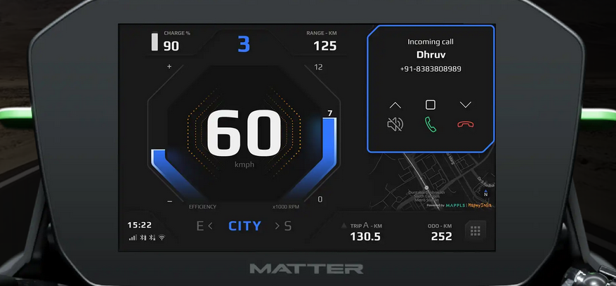

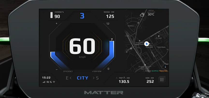

  • Interface looks years and years ahead of Ather and app looks great.

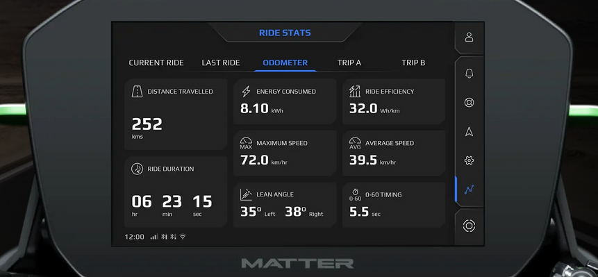

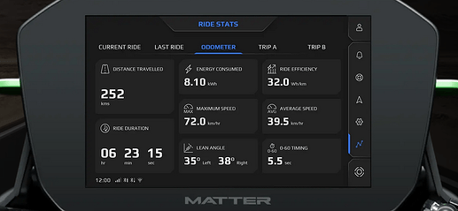

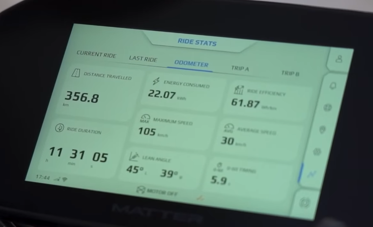

  • More data on ride logs like lean angle, G-force, energy consumed, ride efficiency, 0-60, Trip B. And all this on dashboard. The things we crying out loud but Ather team won’t give. There is so much data but team has no way to show us?
