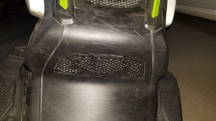

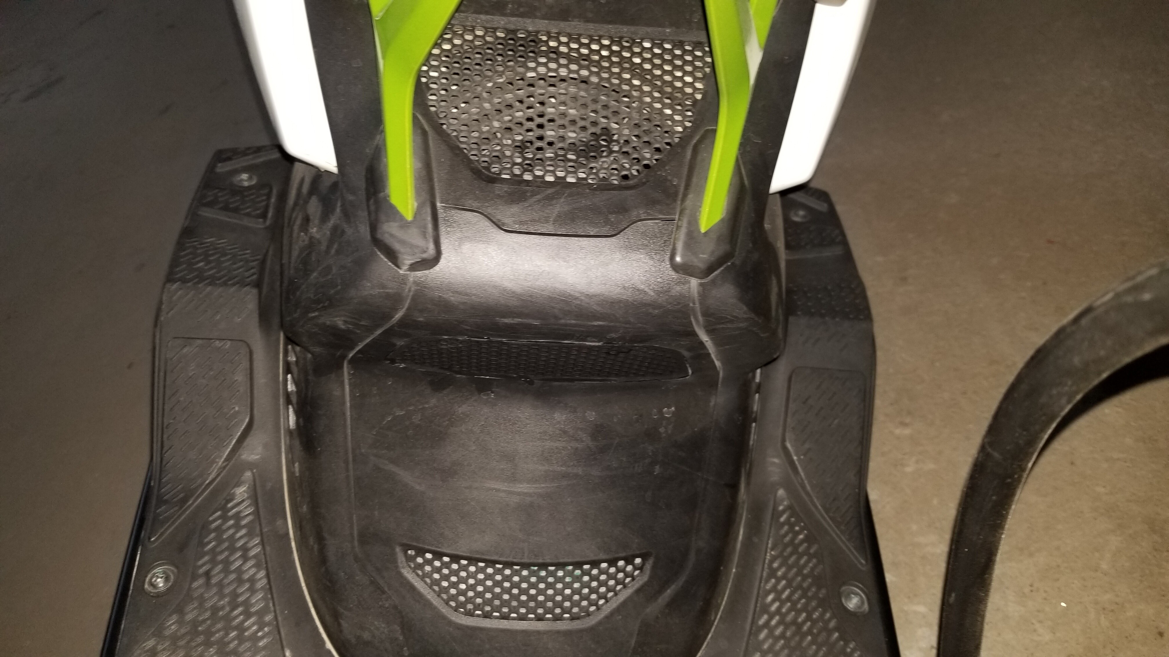

Today, when I returned home, I observed that the piece of plastic covering the motor fan has fallen off somewhere on the road.
Had I known where it fell, I could’ve fit it back but I don’t know where it fell down. So, I called the customer care and asked them to install a new one. It’ll be done on Monday. The Executive told me that he’s however unsure whether it’ll be chageable or not.
It was not a very nice fitting piece from the beginning and it gave up finally. This was the exact observation made in Team-BHP’s official review too
it happened multiple times during my long rides
but most of the time, i was lucky to find it stuck between stuff i place on floor board!
even service team couldn’t help as it is due to cheap plastic Ather choose in that area, so they end-up placing adhesive like feviquick to secure it
but Ather should consider improving plastic quality and design in this area covering motor, controller and the fan…
Been there, done that. I was not charged for the replacement.
Actually they have changed that plastic part with bigger clips to hold it more securely. And instead of using fevi quick if you use silicon paste which is used in making aquariums it will adhere more securely which I used.

The service technician came on time as scheduled. It was a mere 2 minute job.
Exactly my thoughts about the quality of plastic. The service technician put the piece and used fevikwik to hold it.
To be frank i didn’t see any improvement. Hopefully the fevikwik helps.
No charges for me either
Couple of pictures.
Fevikwik sometimes melts plastic, be careful
