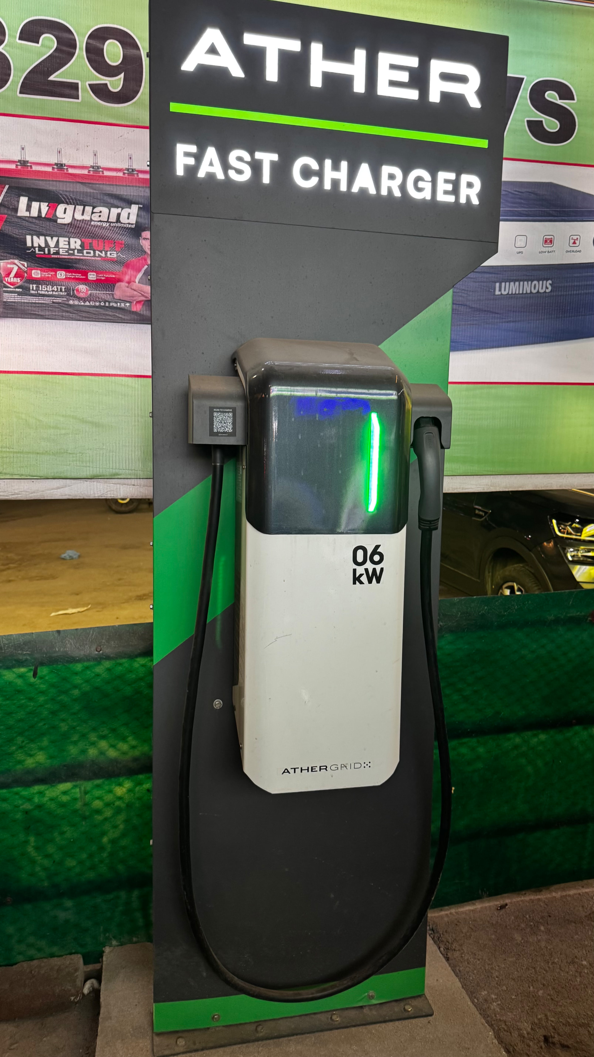

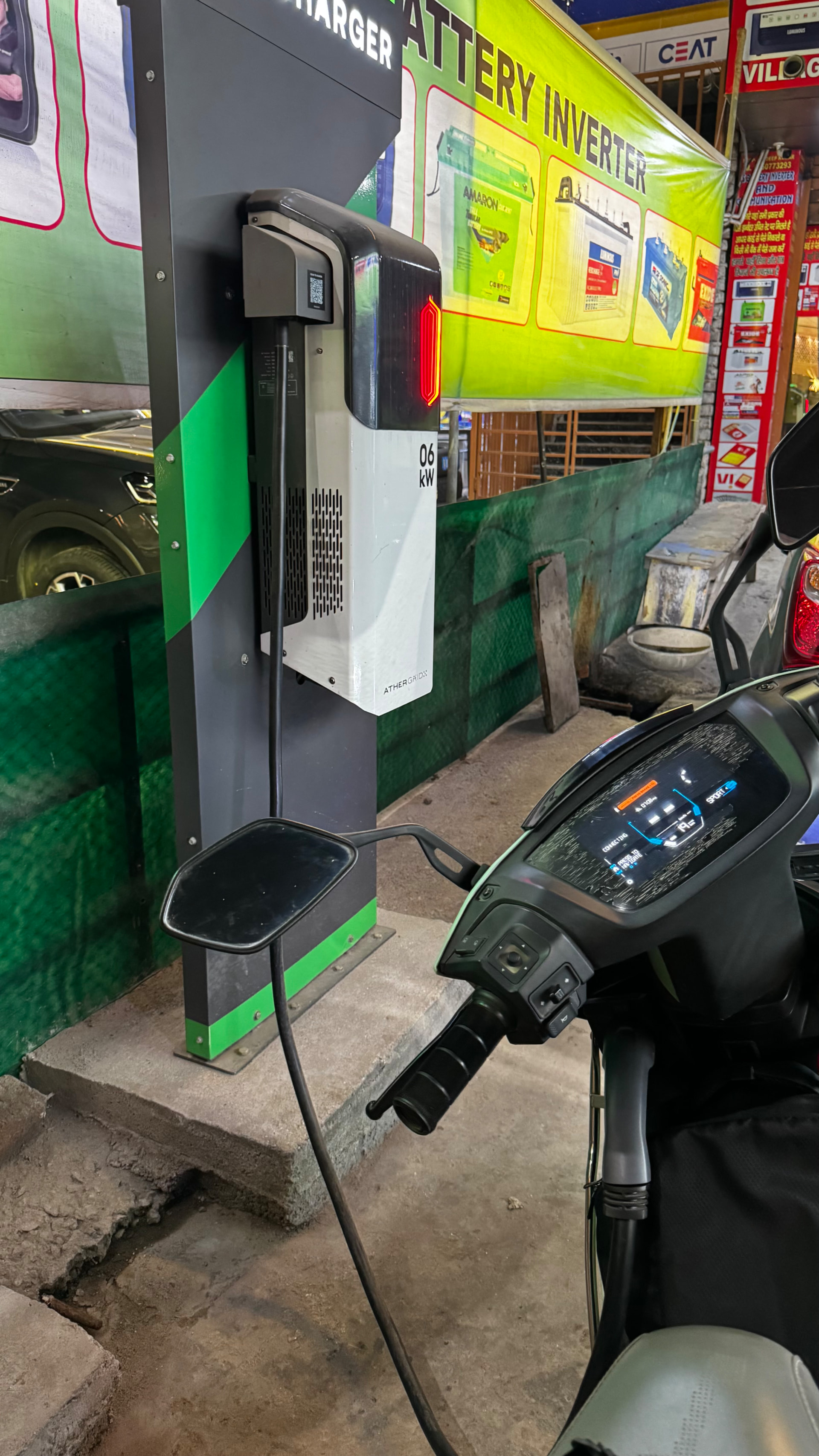

Hi,
I recently tried charging my 450S at a 6kw fast charging Ather grid, but as soon as I would put the charging gun in the socket, the charger would turn red. It didn’t even start charging, just putting the gun in the socket would turn the charger red.
Hence I am wondering is it compatible with 450S scooter? I know Ather treats the S model as a step child and hence the is

FYI.. Ather replied on Twitter finally saying that only models after Aug 2025 will support the 6kw fast charging
Ather Grid 3.0 is optimized for vehicles sold after August 2025. For earlier models, these points will continue to provide reliable charging at standard Grid speeds. Hope this clears things up!
Small Correction, 7th of Jan 2025 and after will have 6 kW Charging specially 450 series and X variant specifically :high_voltage:

450 S Model not support 6KW (3.O version) Ather grid … fast charger only 3KW (2.O version) …
Both 450s and 450x purchased after August 2025support 6kw charging
