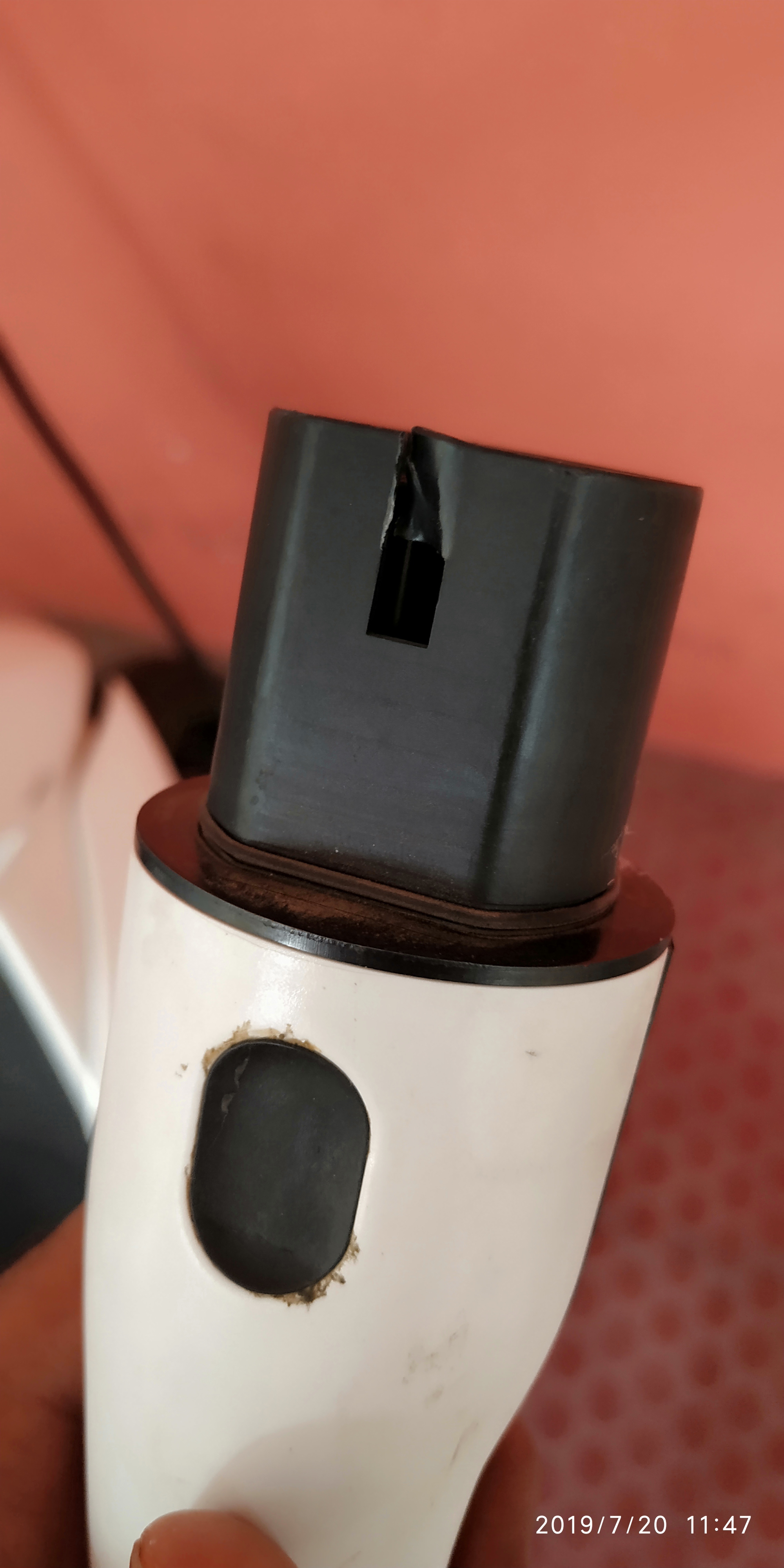

not sure who and how
but my charging pod plug is looking bad
i suspected this would happen when i got to know about this feature in update which am not interested about
so i didnā€™t bother when i havenā€™t received the update by default
this is one of those reasons am asking team to provide options to customer atleast on appā€¦
Did someone without knowing selenoid lock, Tried to remove charging plug and damaged it?

as i said not sure who, how
am guessing they didnā€™t know about it and tired to remove it hard way

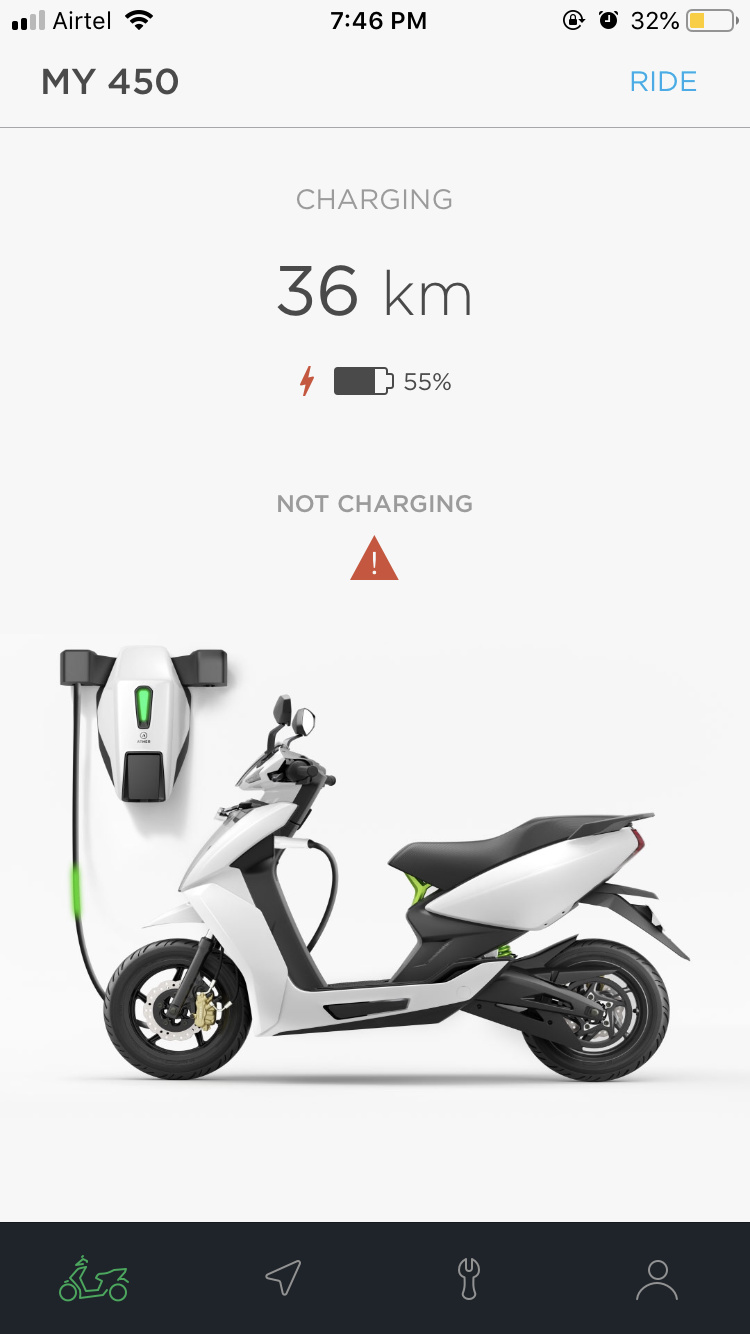

Today I got my ather delivery
But I am not able to charge using home pod
The home pod is green when not connected
As soon as I connect to the vehicle
It turns red
And vehicle says not charging
What would be the issue
Pod not mapped yet or try doing a reset (hold both brakes + ignition switch for 10secs).
Not mapped in the sense???
I didnā€™t get you
I tried to reset still no go
