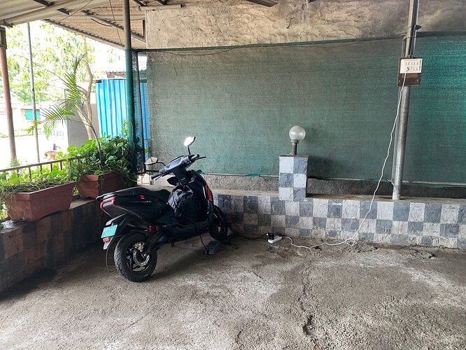

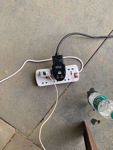

You can use 1.5 sqmm three core wire with socket and switch , that should do the job, I also use extension board with my portable charger, works like charm.

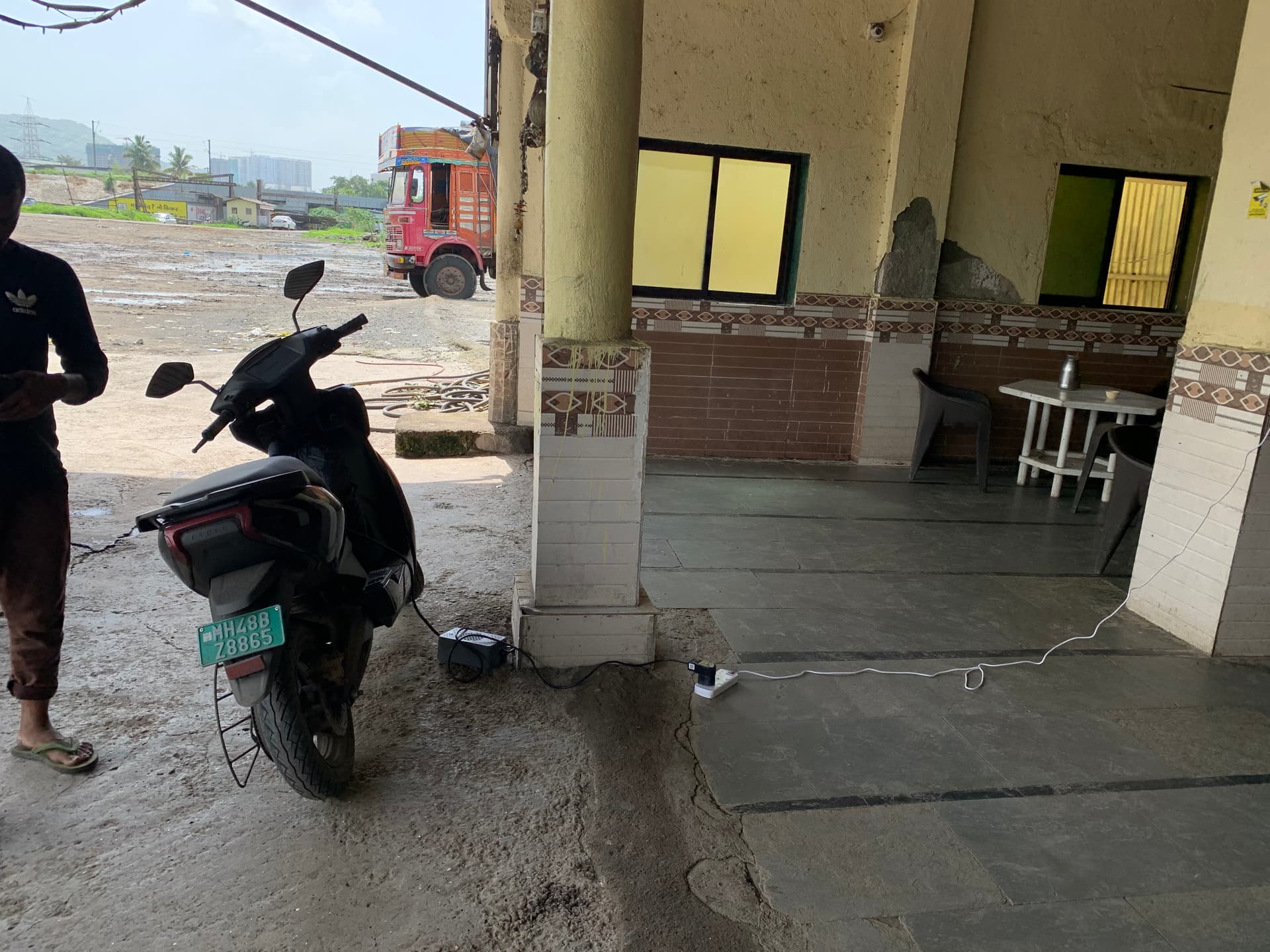

I am using a normal extender that we use at home.m & it works perfectly fine. I always keep the portable charger and the extension board in my boot. You see, I love the long leisure rides on my Toothless. :blush:

Just check if wiring is proper and the socket from where you are taking power has proper earthing.

The charger is good. You don’t have to worry about earthing. I have used it in some of the most remotest places in Maharashtra. Yes, boot space is enough for charger and a compact extension board and will still have some space left for lill stuffs. :blush:
