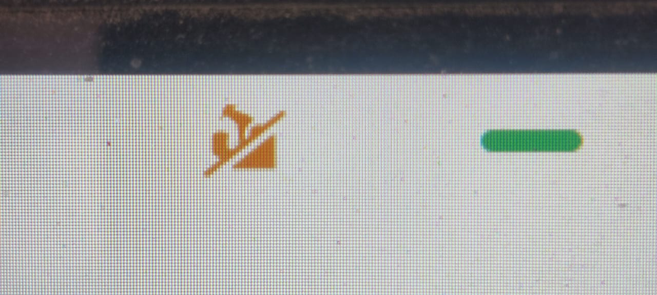

My guess is this icon means auto hold unavailable or can’t ride inclines due to motor heat or other issues
This icon popped up once in normal ride and once while park assist reverse was engaged
Rizta user manual doesn’t mention about the meaning of icons shown on dashboard.
Internal error codes meaning need not be disclosed but icons meaning should be communicated.
Yes, it is autohold disabled. Should not have issues climbing.

I am getting the “no hold” always when I engage reverse, after OTA update. :thinking:
Autohold always get disabled in parking assist mode. Cause, Motor is already limited to certain power level in that mode
