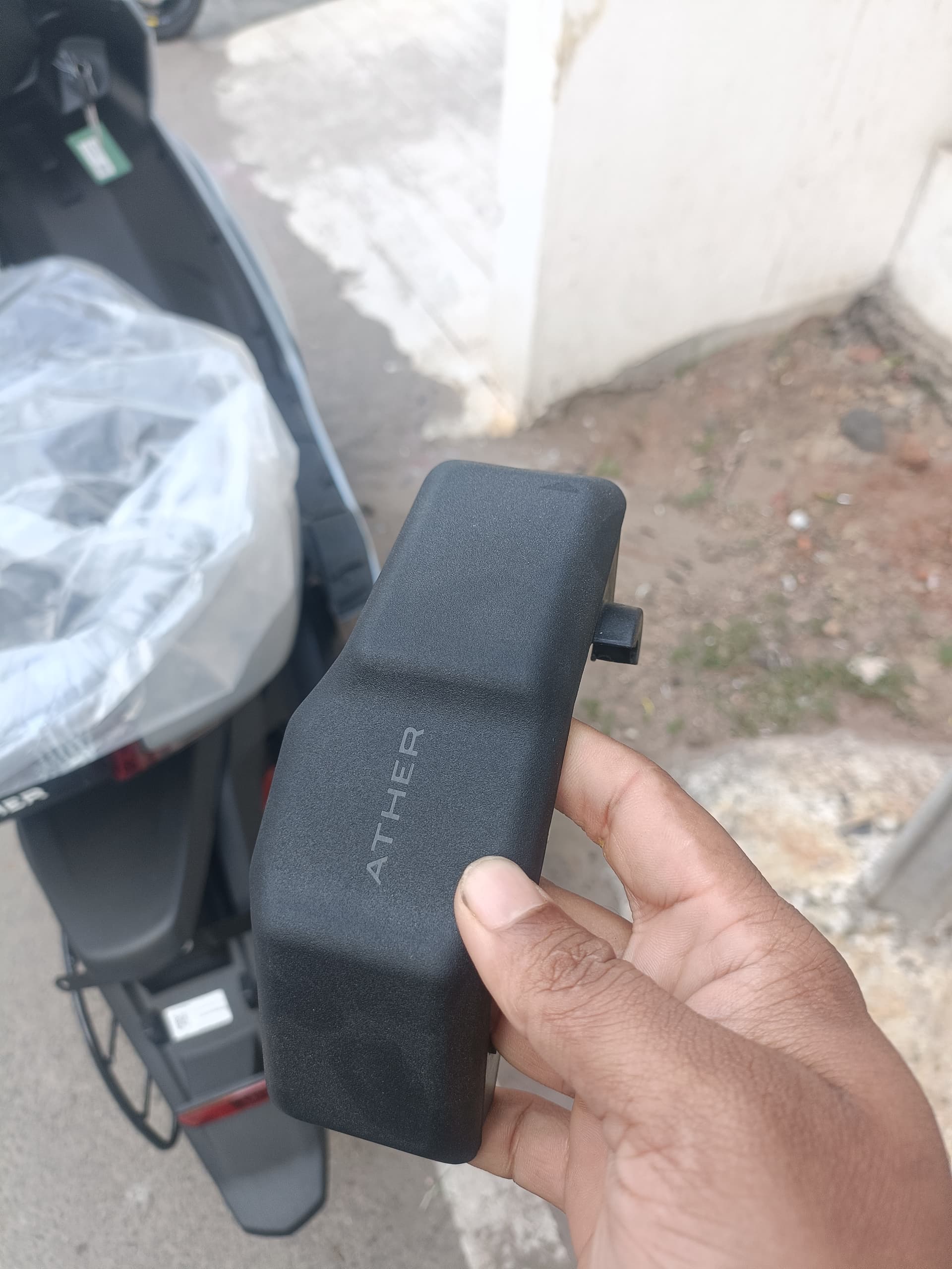

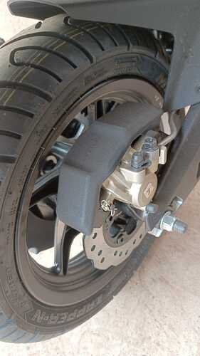

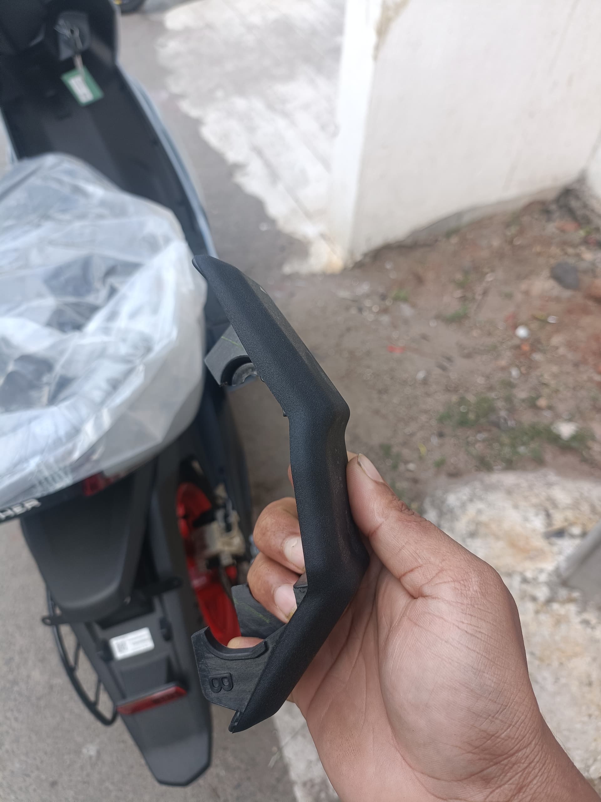

Is this supposed help with gravel entering in between the caliper & the disk and making those screeching noises? Secondly is this rubberized plastic or a normal hard plastic like the mud guard.
Who comes up with these stupidity @tarun
So who pitched this idea
Yes It will prevent that
Yesterday my Brother Car Faced this Issue and end up visiting Service Center for Repair that Keech Keech Noise ![]()
It feels like the Mudguard’s Plastic Material, Unpainted Parts Quality
But Sturdy Material
