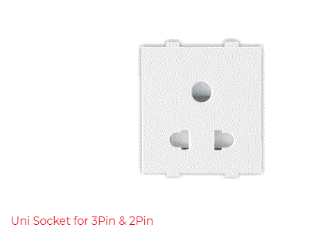

For home charging point, 5 A wall socket is sufficient (similar to laptop charger with three pins) or do we need 15 A socket like the one meant for washing machines and Air Conditioners.

As for the requirement, a 5A socket should do, however, if you reside in an apartment complex, and there is no charging socket in your parking location, we will get the home charging point installed by routing the wiring from your electricity meter.
In case of 340 purchase, we will install a 5A charging socket at your parking location.
