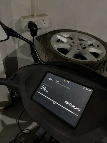

Put the scooter on charging for a few hours, and at 90% it suddenly halted charging. I was around the scooter the entire time so I know nobody messed with it and there was no power cut. And yes, optimised charging was off.
I removed the charger, unplugged from the wall, left it for a min and reconnected it, still the same Not Charging screen. Repeated the previous step once more and it finally resumed charging.
Could be a battery related issue? Or charger? Or a software bug?
The exact same thing happened to be yesterday. I think it’s a bug
Pls check what colour light is indicating on the charger. The charger gets OTA updates every once in a while which takes couple of mins to complete
