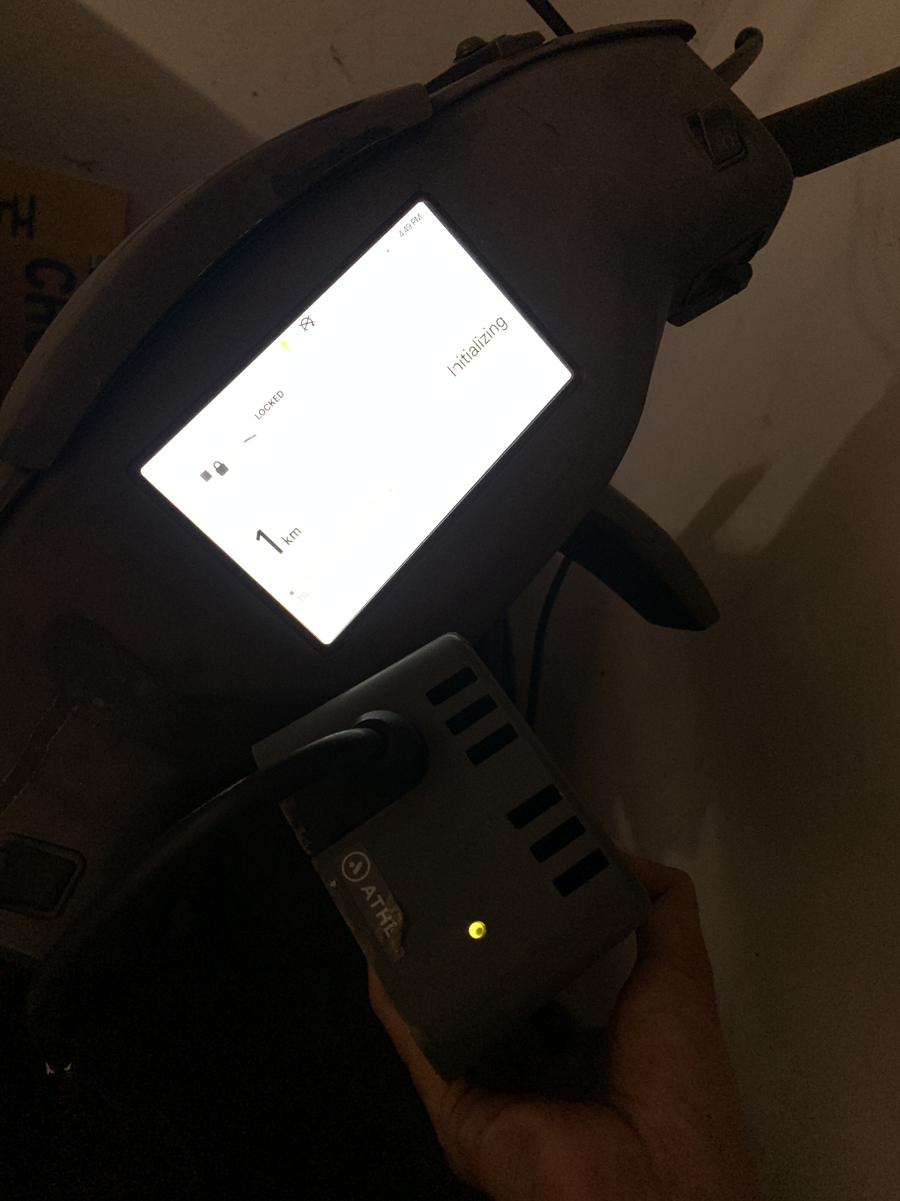

Screen stuck at initializing
Charger stuck on orange/yellowish light
Fan constantly running even with scooter unplugged
Whats the issue?
I just hope charger is okay.
charger f/w might be updating.
If your charger isn’t working right give it some time to update if it still doesn’t work properly after a while take it to a service center. Sometimes it can take a long time but if you still think something’s wrong go to the service center they’ll either fix it or give you a new charger.
How charger downloads the software?
Scooter downloads it and upload it to charger when connected.
Via scooter when connected to charge. Happened second day of my purchase and asked showroom guys to explain what is going on.

Its not :frowning: I’m charging with someone else’s charger atm and will take mine to (the horrible) service center soon
I wish that was the case, but the just glows orange the moment it’s plugged in, even without connecting to the scooter. The fans also blaring at full speed.
I left it connected to the scooter for 5-6 hours in this state but that didn’t help either. Some other issue I guess :confused:
Are you gen2? They’ve really been cheaping out after that. When I was getting my Gen3 delivered I also questioned. Where’s the paperwork? User guide? maintainancr booklet?
Maybe the ota failed in between and now it would have to be done manually or something. These are the same symptoms that happened to me I left it connected overnight and in the morning it was green again.
Nope, I’m Gen3.1, purchased Jan’23. Just got this brochure and a bag with charger inside, maybe old stock or I got lucky.
Oh interesting. I’ll have them manually update it.
