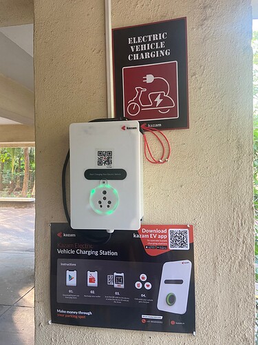

Societies / Apartment complexes can use third party solutions that allow connection to charging points from society meters, charge the users per unit usage based on app. One such solution is Kazam - see picture below. There are other providers in market as well.
This is a good option for societies / apartment complexes because:
Members don’t have to set up wiring from their meters - can be extended from nearest point Society already has
Society has to set up few points for small cost. In my society, I paid for the cost and negotiated usage of electricity units till that cost is recovered
Society retains control of charging points - keep it private for residents or public; Change the cost per unit
If society gets solar roof, input cost would further plummet by (since Discoms allow solar setup with net metering up to 90% load).
