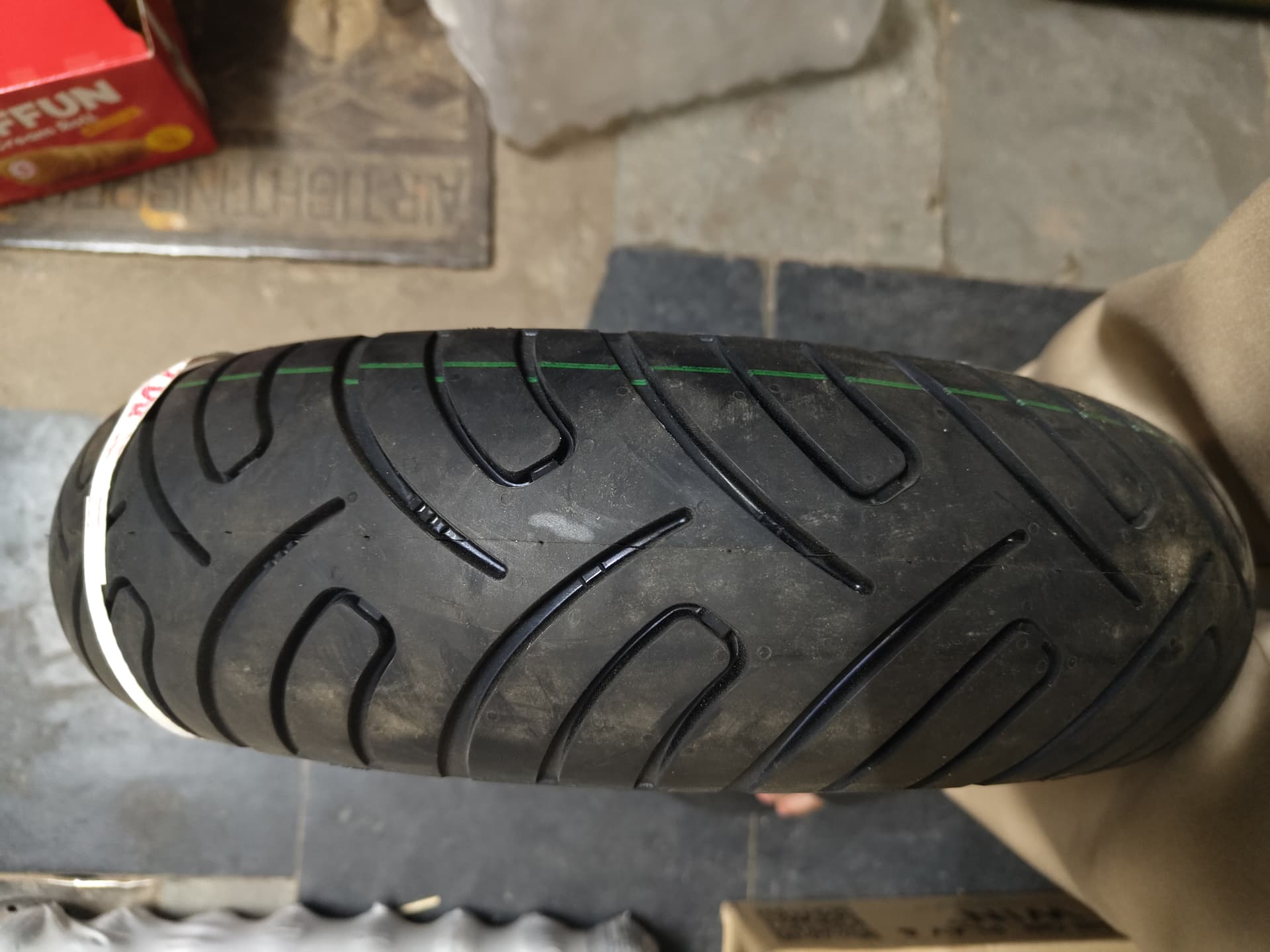

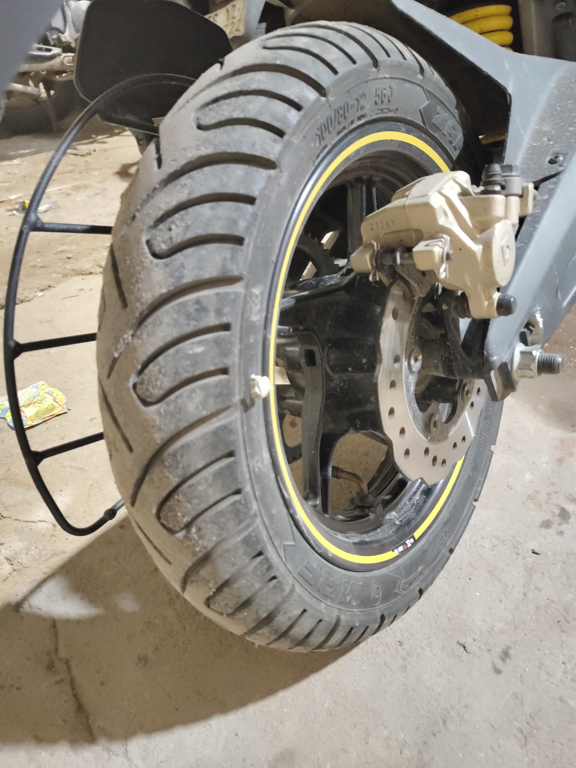

I have Ather 450X Gen 3 I got MRF Zapper Tyres which they introduced with Gen 3 and same tyres now can be seen with Other EV 2W also like OLA and TVS , I have clocked 6K Kms till now and my Rear Tyre got 7-8 punctures till now and front one is still safe , What i noticed is , The Grooves which these Zapper Tyre has are very deep and outer portion is hard and never got puncture on the outer portion , but and portion inside those grooves are probably thinner and can be pierced easily and all of my punctures are on these grooves only everytime.

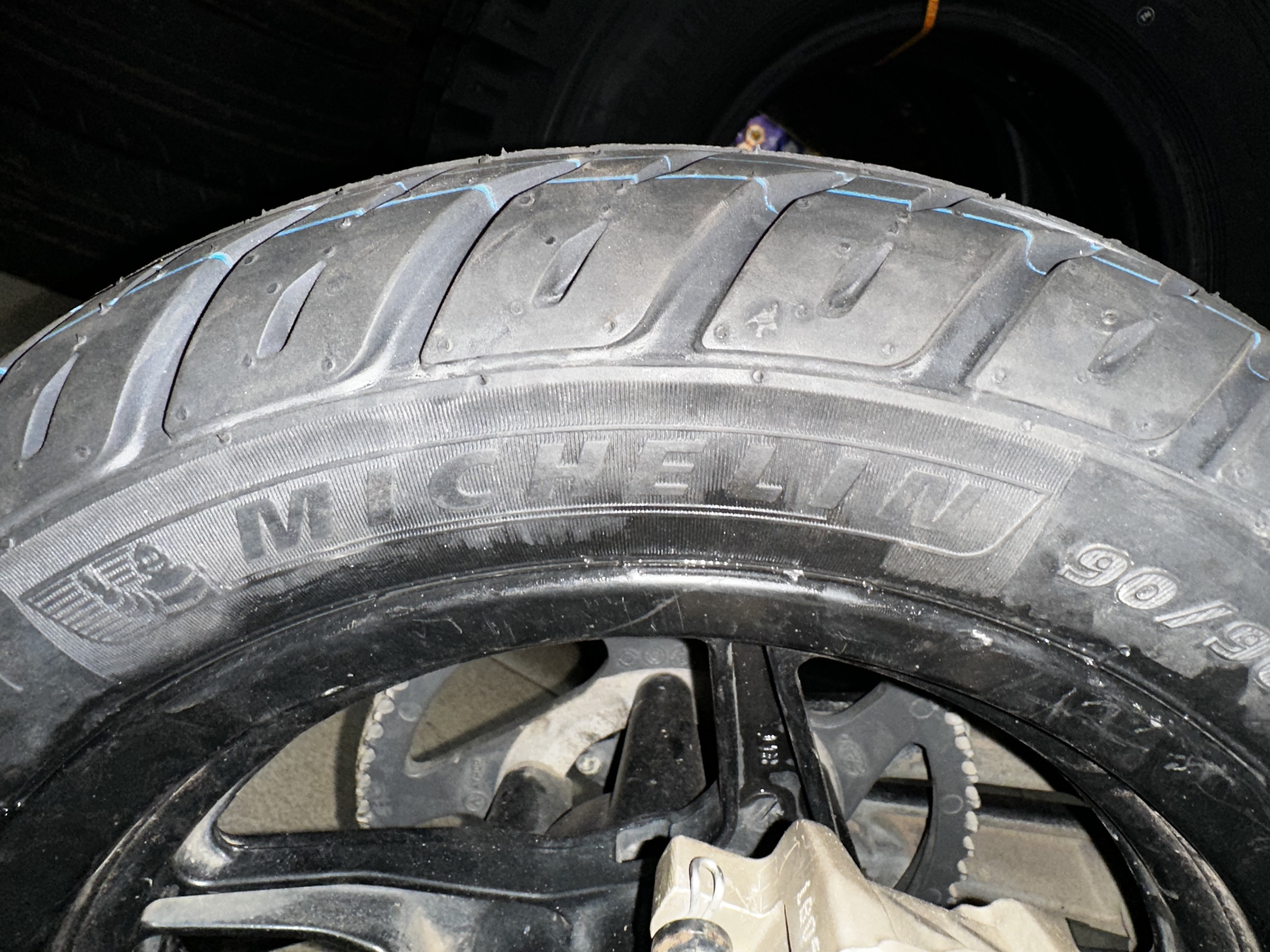

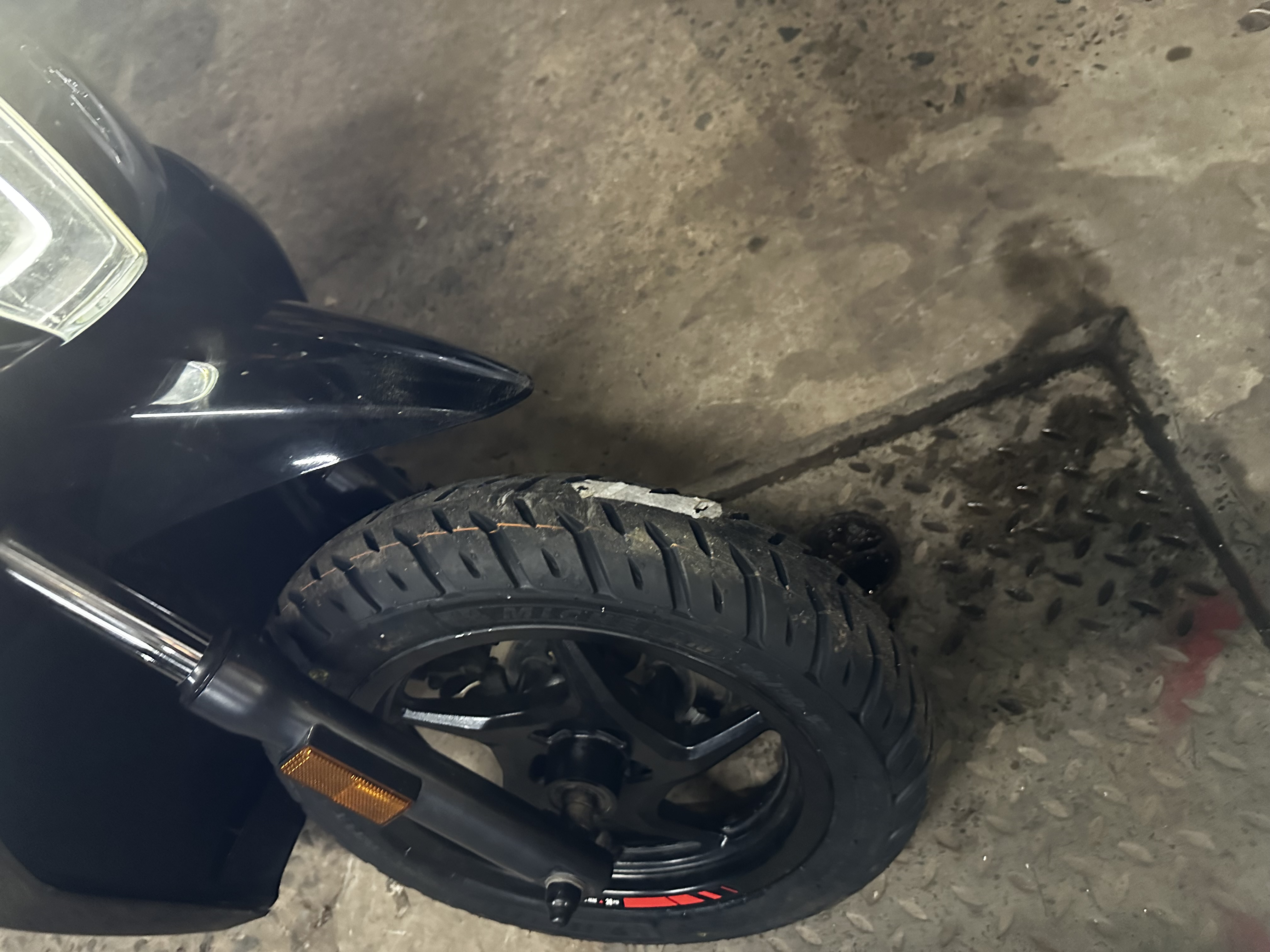

Changed my tyres to Michelin Pilot Street 2 yesterday.
It’s been a few days on the new Michelins. The ride and handling is definitely better than my old set up (Stock MRF done 29.5K kms in the front and a Michelin City Extra on the rear. No idea how many kms on the rear). I’ve only done a test ride long back on a scooter with both stock tires so difficult to compare.
I think the Michelin Pilot Street 2 are a good upgrade and I’ll definitely recommend the same. I wish these tyres were available in 100/80/12.

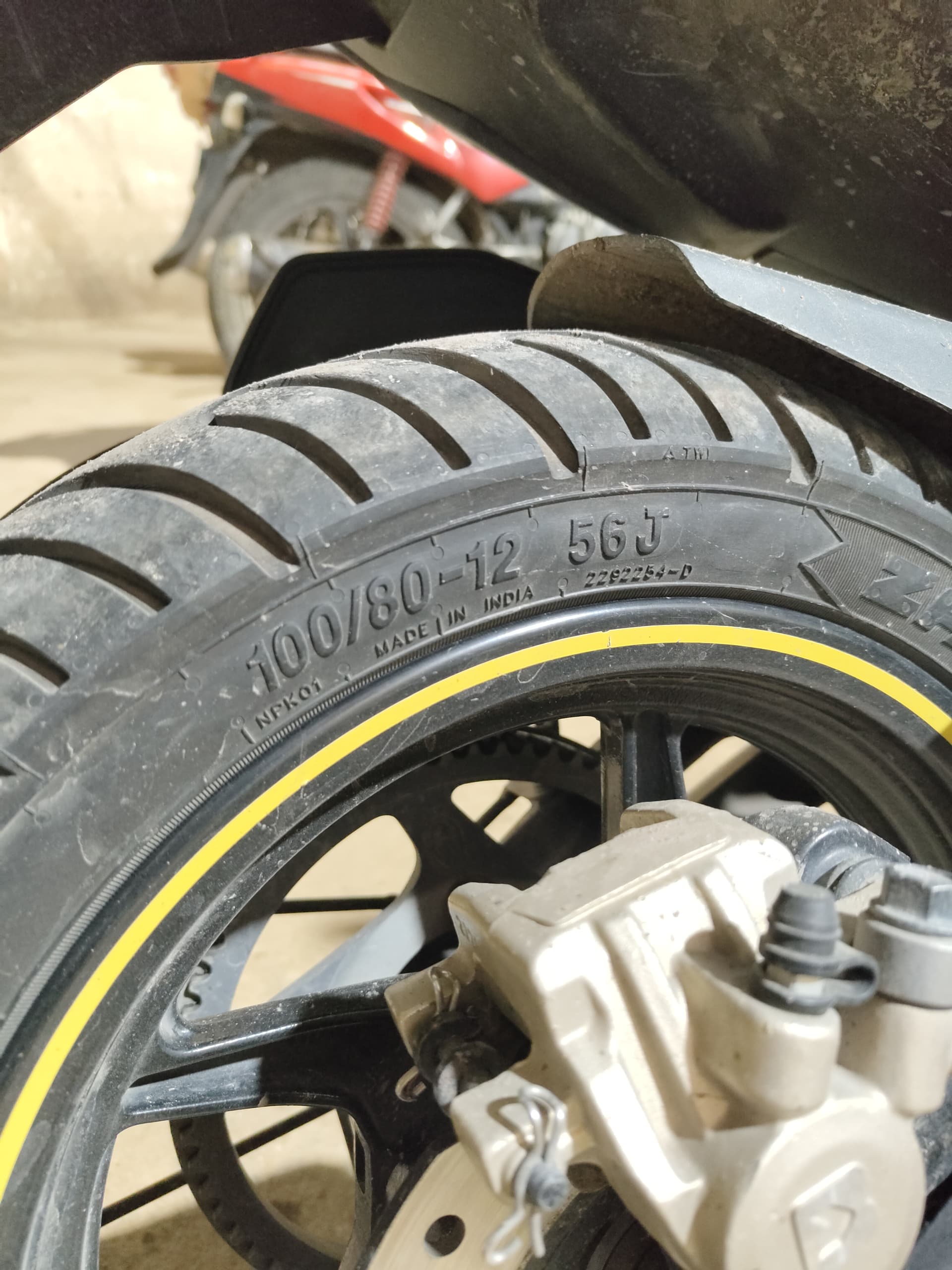

I have MRF Zapper N 100/80-12 56J fitted in the Rear of my 450X Gen 3

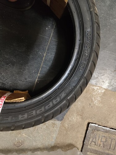

My front tyre didn’t get puncture even once but rear got 7-8 punctures till now and old punctures are loosing air soo thought of changing the tyre , only ridden 8K kms on it , In the Market I am getting MRF Zapper FN 100/80-12 56L
I am confused about Zapper N & Zapper FN and also 56J & 56L
