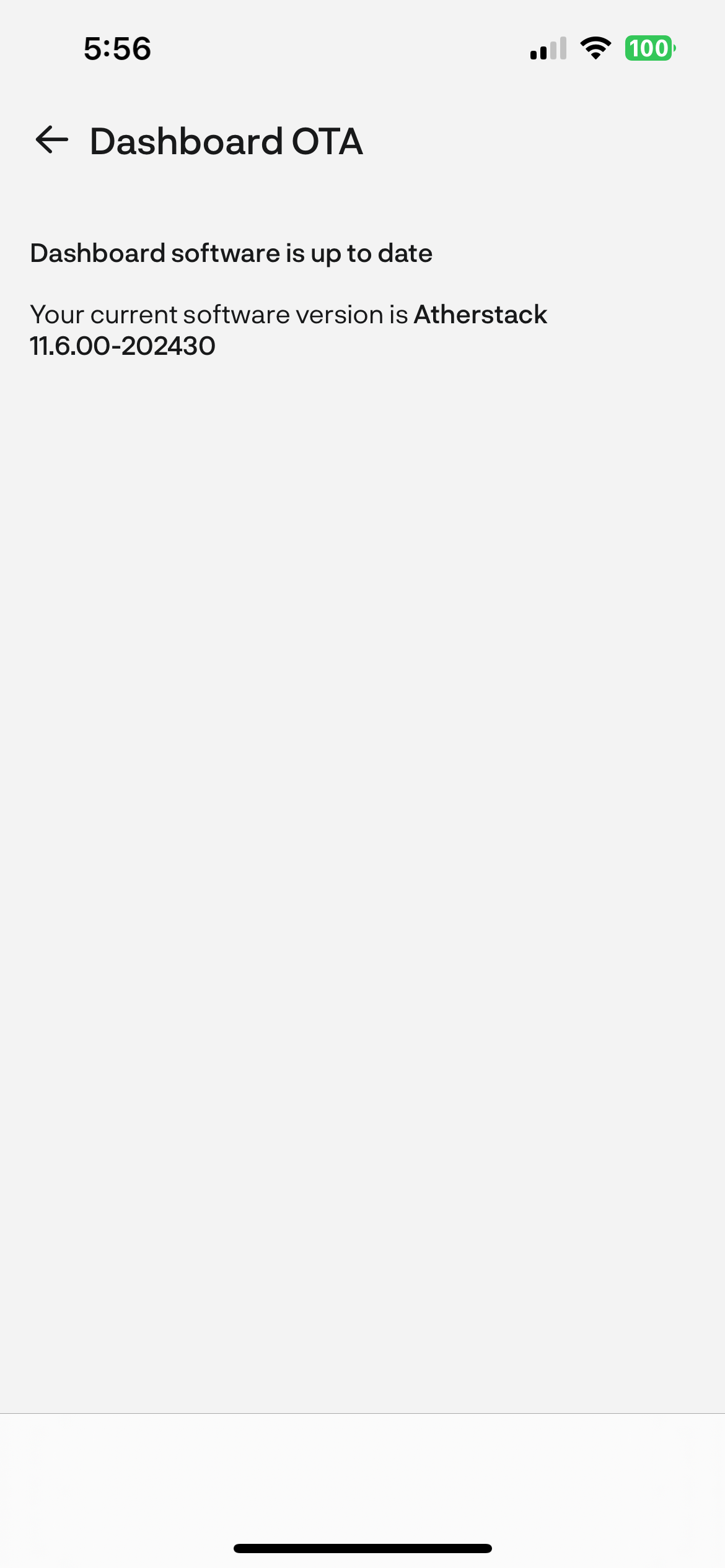

One small point I waan make to all the testers out there can u also mention ur AS built number too
This is for gen 3.1 450x (mine)
