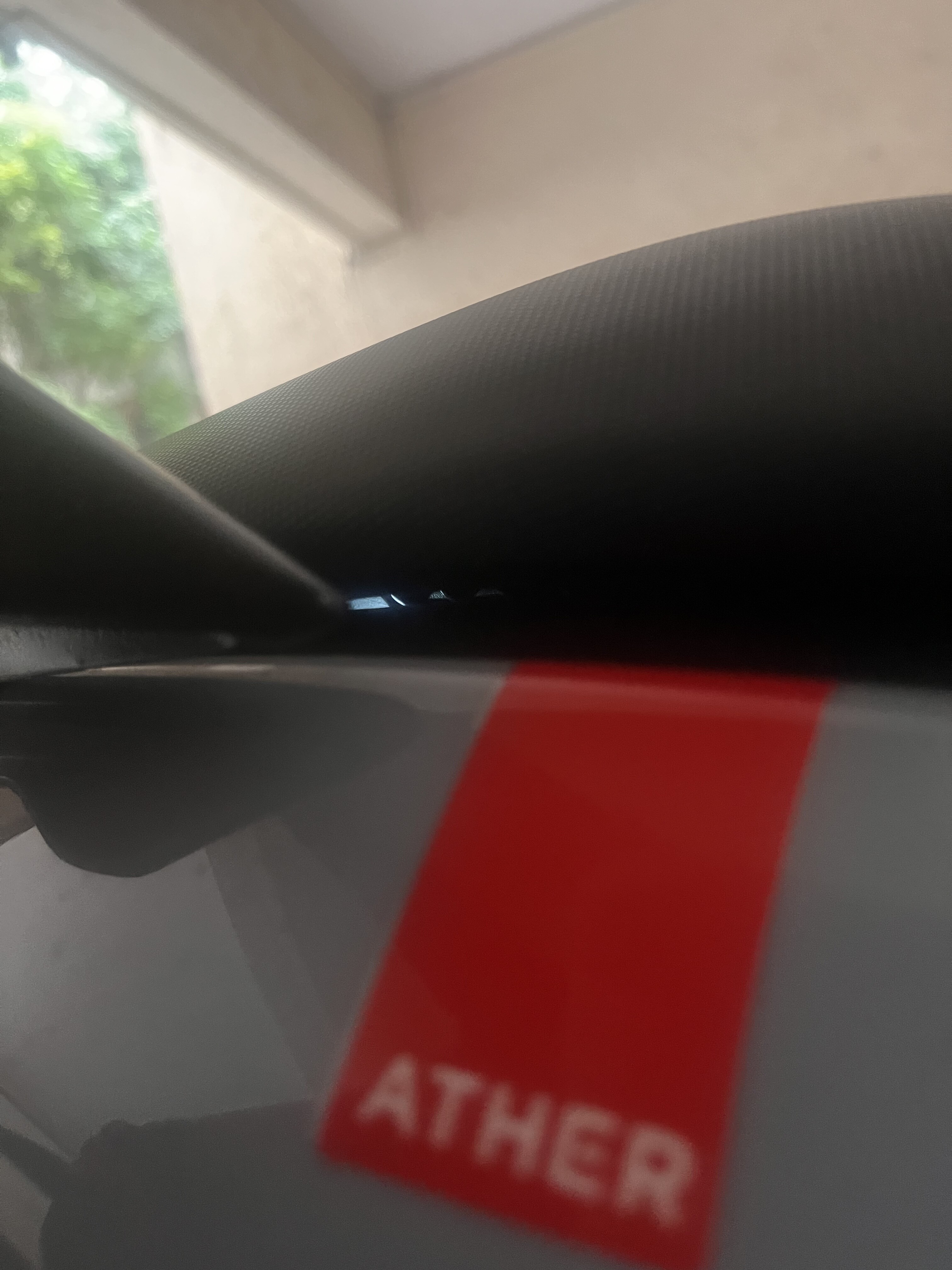

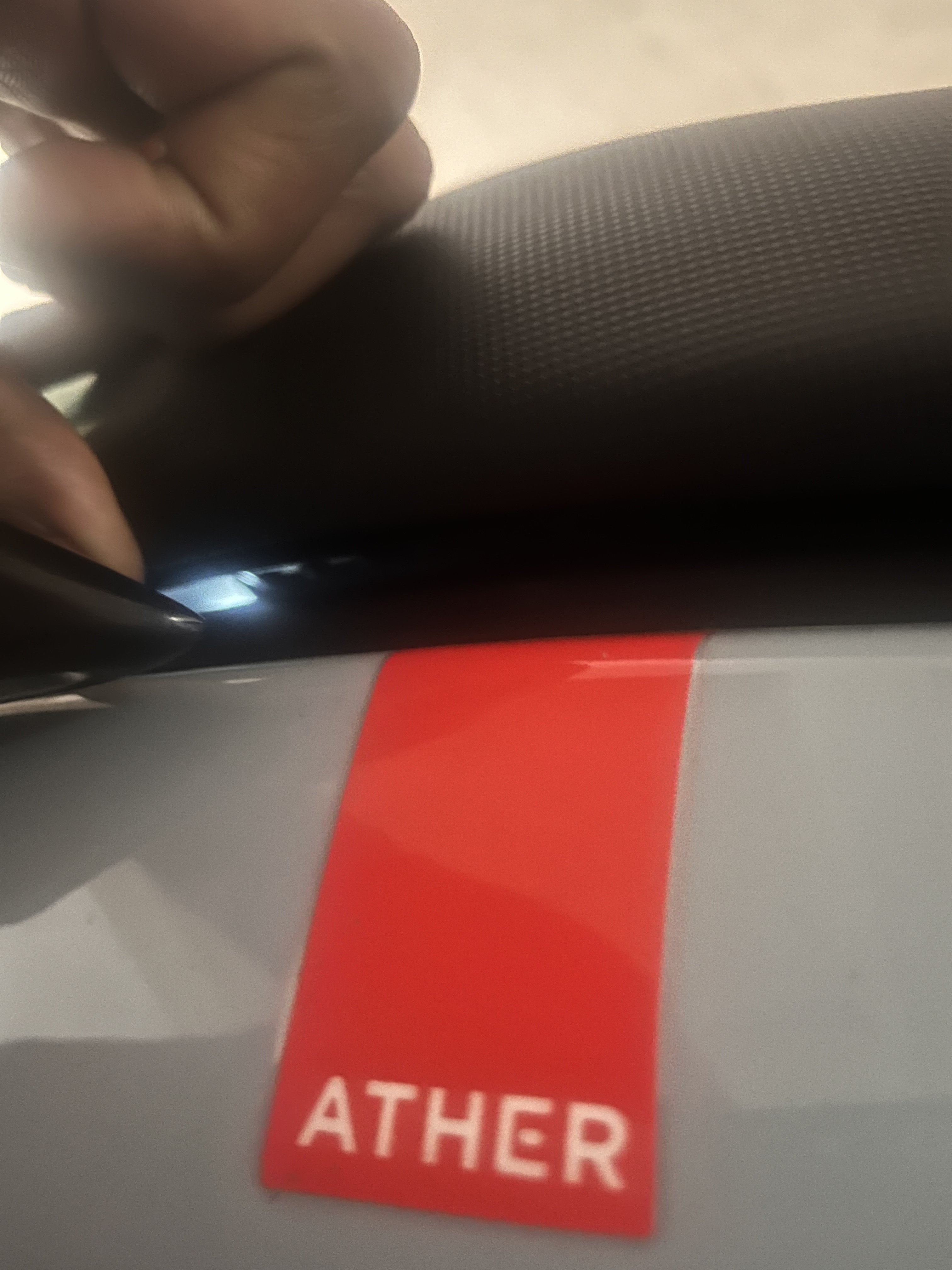

Hi,
I also have the 450x purchased 3 months ago.
Faced the same situation for battery percentage. Last night coincidentally i forgot the Ather key inside the under seat storage. when i was trying to pull out the key from storage by pulling seat, I saw the light under seat is on :bulb:. so its a reason for battery :low_battery: drain while bike is in standing position. the under seat light always on
check urs also. i ll post the picture of it
light is also turned off even if you open boot while shutdown.Are you sure scooter was properly powered off?
yes it is turned off. key removed
its nt about shutdown. its after removing key from Ather. shutdown is the another process. its about in standing position
