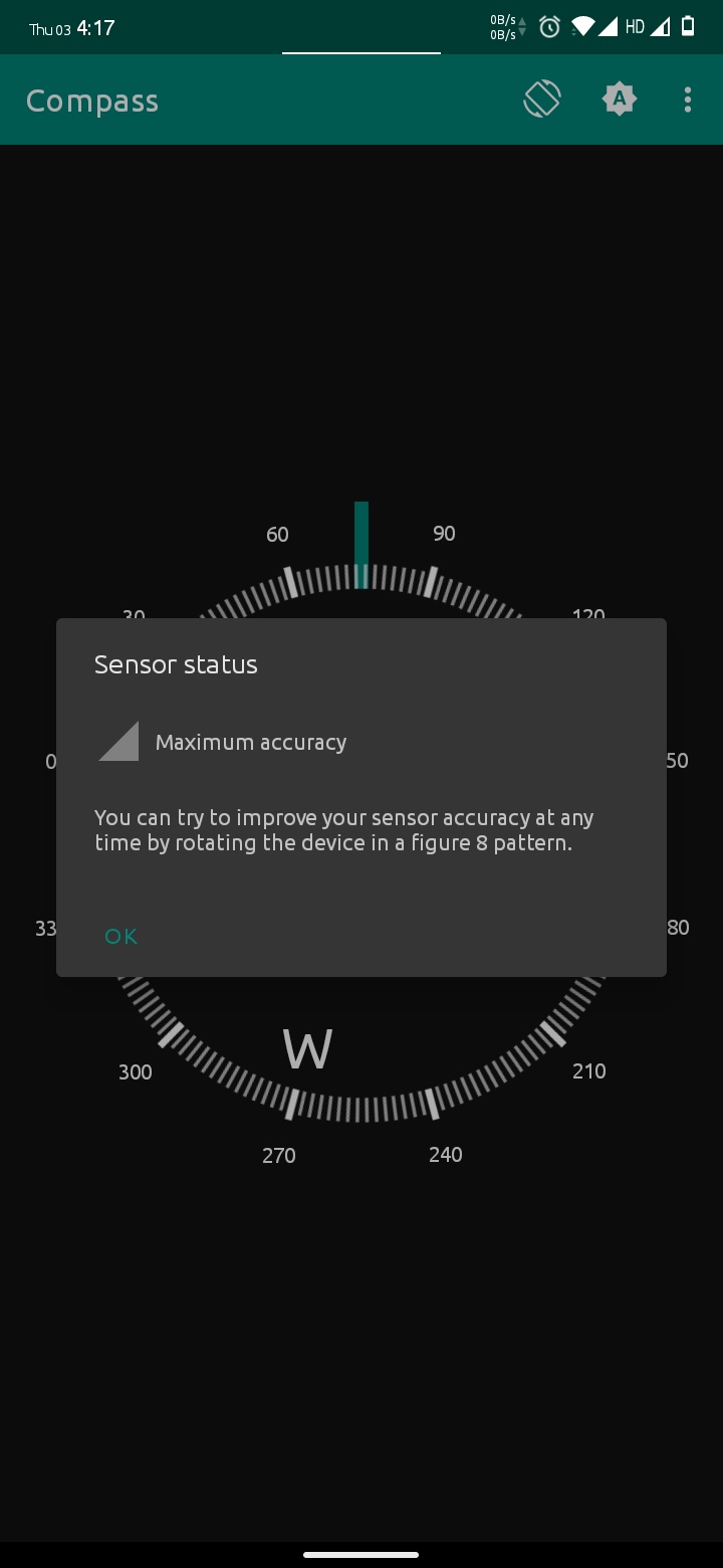

Oh yeah, GPS is accurate only for a few meters, so sometimes when standing at a signal it might think you’ve now taken a U turn and hence rotates the map. This doesnt happen with your phone since there’s a compass built in as well, the scooter dashboard does not have a compass though. It’ll fix itself as you start moving once the signal clears.
Then, compass should be part of scooter on priority😎
Is it a hardware element? If yes, why isn’t it already part of the dashboard?
Yes, the compass is a hardware element and usually embedded in the main board or sometimes even the soc (read as system on a chip).
I suppose adding a compass is cumbersome on the dashboard because it needs occasional manual calibration routines. Try opening the compass app on your phone, and ever other time it asks your to move your phone in a pattern of eight till it calibrates. I do not know how that can be done with a scooter having a fixed dashboard.
If this works then can the scooter be moved around in a very tight eight pattern ?
