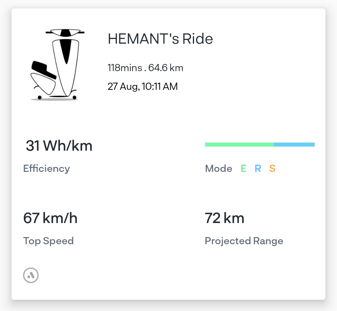

Today I started my journey in smart eco mode with 100% juice, scooter is drained to 0% after running 64.6 kms, dashboard shows 31 watts per km efficiency & app shows 72 kms range
Almost 8 kms less than projected range & 6 kms than true range
@tarun @abhishek.balaji can you plz explain???

Was the entire ride continuous or were there any breaks in between and 64km is all achieved in a single day or single ride or was that over the days or with multiple rides?
It’s a continuous ride of around 118 min.
Your’s half of the ride is almost in ride mode then how will you get the true range. To achieve the true range the entire ride should be in smart eco mode only, but you have switched to ride mode whenever you need.
And also can you tell what’s your odo?

My point is not the mode
Why aren’t you getting the simple mathematics
I m just saying 2200 wh :heavy_division_sign: 31 wh = 70.96 kms Then why battery reach 0% in 64.6 kms ???

M just wondering if the usable battery capacity is actually 2200 watt or what ??
My odo reading is 2207 kms only. & If battery is degrading why so fast ??
