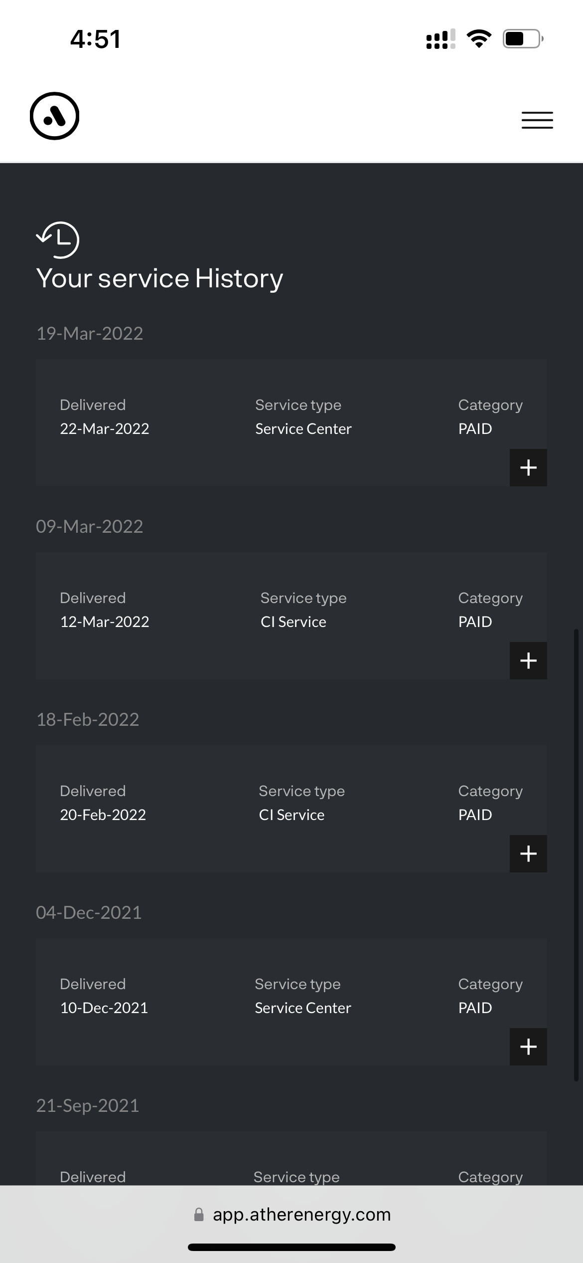

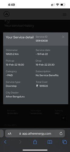

M00 errors I’ve had quite a few of these and most of them in 2020-21. The main wiring harness has been replaced 3 times in total and all 3 times was under warranty and I was told it was a manufacturing defect.

If I had to rate Ather service out of 10 I’d give them a 15 I’ve had just such a good overall experience with the service. Except a few niggles about my motor overheating and Ather just not understanding what’s happening. The Experience has been with no complaints. I’ve been on Service pro for the majority of my ownership and really good communication from the team and management. This boosts the already reliable scooters reliability. Unlike the OLA service which is just a horrendous experience. They really should learn a bit from Ather. Only and only because of the service of OLA - I , in my good conscience CANNOT recommend the OLA Over the Ather 450

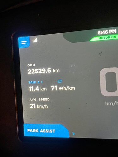

I didn’t upgrade to the 4G modem so I’m stuck at 2G and the maps is just too slow for my liking. Even at 3G back when I got the scooter. It wasn’t as quick as it should have been. I haven’t really seen much change in the dashboard since I got my scooter. Other than the ECO mode. I really wish we had more stats about real-time efficiency and ability to regulate regen and custom ride modes. But after the 450X I guess Ather just stopped working on software for the 450. All that being said the present software running on the 450 is the most stable version I’ve seen. When I initially got my scooter the dashboard used to reboot 5 times a week. Now it almost never does. Maybe once in 2-3 months it might but it’s as stable as it can get. The SOC indicator has never let me down. Down to an indicated 0% it’s always been accurate and reliable. (Ola needs to learn to do this ). The standby drain is quite a bit but at least it’s accurate.
