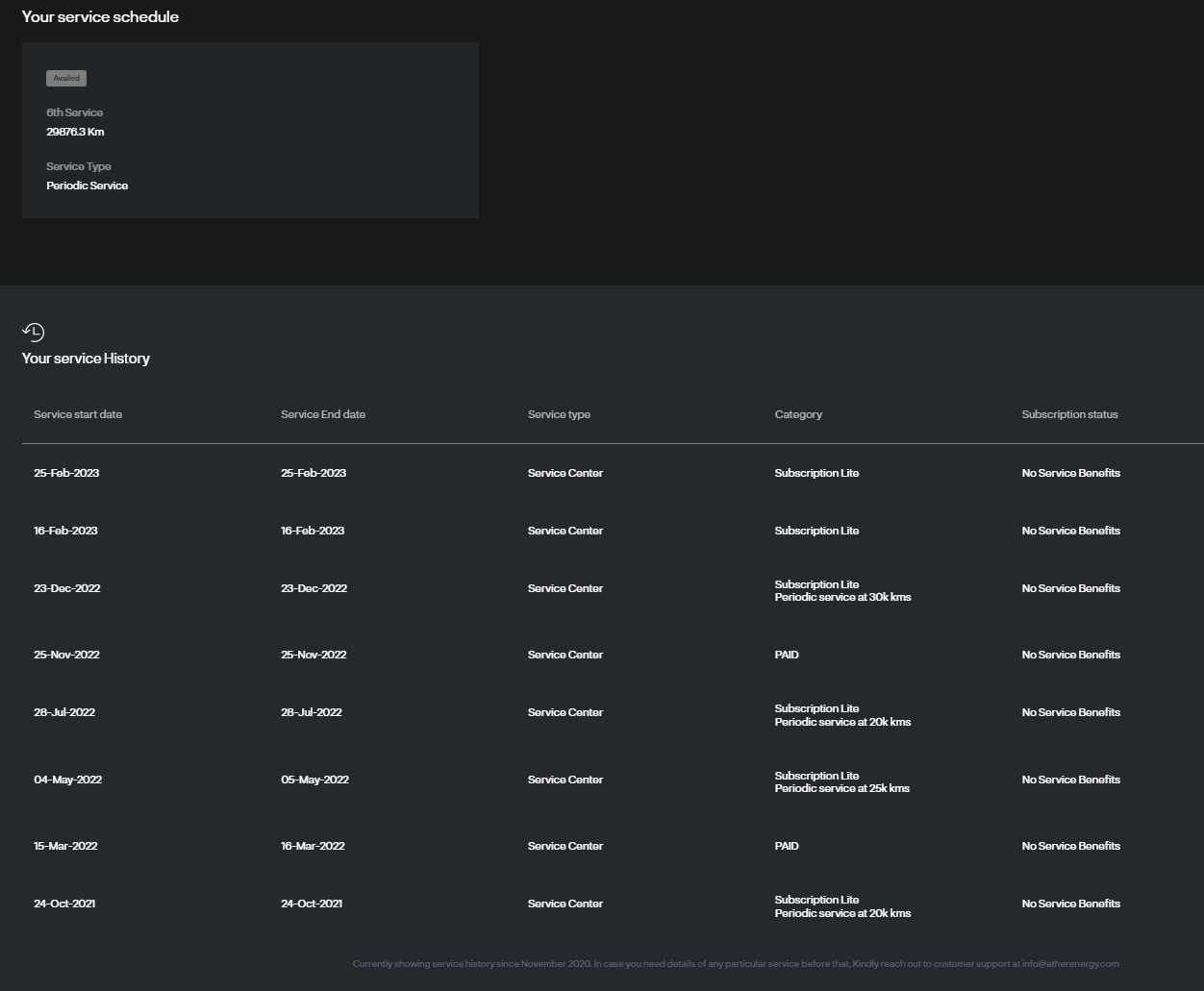

My Ather’s 30k kms periodic service was done at 29876kms. Which means it falls between **800 - **200 kms as you have mentioned. Still the Service Schedule shows the 30k periodic service is overdue.
Also check the history it shows on 04May2022 Periodic service at 25k kms completed but in Service Schedule it shows as missed.
And service history shows that the 20k kms Periodic Service done twice.!! Which is how possible .? The Service Schedule shows 4th service availed at 27046.7km…!! How come 4th service (20k kms) can be done after 5th service (25k kms) at 27046.7km.??

Ather system is a miss on a lot of time, but if the system is showing that a Service is missed then kindly shoot a Mail to info@atherenergy.com so that they can update the service logs
Hey Vasanth, Our team is working on your concern. You will get an update soon.
Not only Mr.Vasanth facing the issue , Most of the Customers are facing brother
Hey @melvin.wilson ,
Thanks for taking it into the account. Now the portal shows 6th servcie(30k kms) availed. But the 4th and 5th service went missing from service schedule itself.!
Only the 6th service is showing now.
Also the service history still shows 20k kms service done twice. 24Oct2021 is the actual 20k kms service. The 28July2022 is not any periodic service.
Hey Vasanth, Please refresh the page and let us know, if the issue persists.
