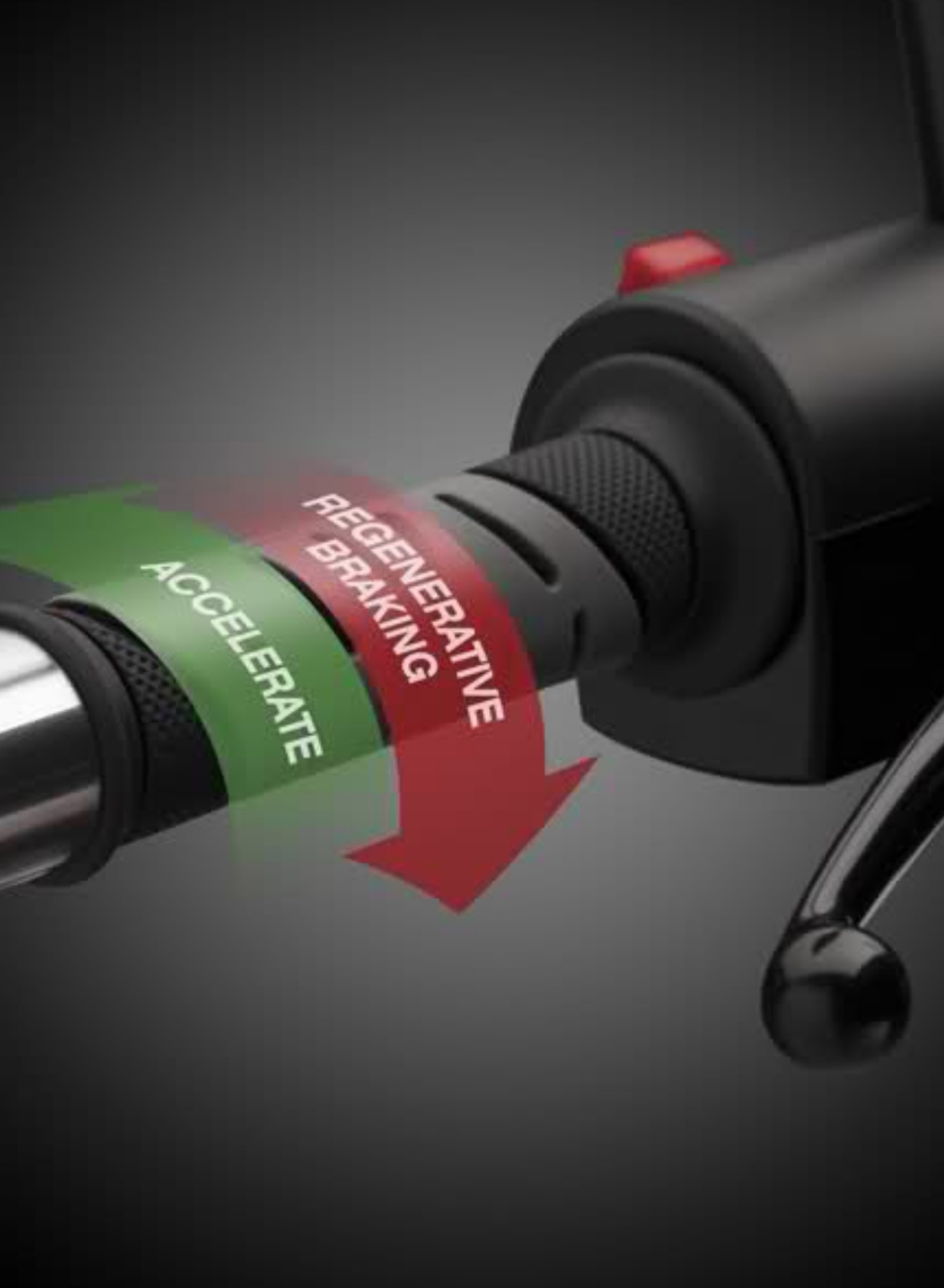

The regen braking in the vehicles can be engaged by twisting the throttle grip in the opposite direction. This dual-direction throttle allows to engage only regen without deploying brakes.
At this point though, the regen torque is low and there will not be a very noticeable deacceleration in the vehicle and we wouldn’t recommend to rely only on regen to slow down the vehicle.
Also, the regen alone cannot bring a vehicle to a complete stop as regen works only when the vehicle is in motion, as the vehicle slows down, the brake force also reduces.
Regen torque is a function of speed, just like air drag.
Moreover, with the 450, the regen gets disabled at speeds lower than 20kmph.

I was not aware of this throttle function
Am only thinking regen is activated when brakes were deployed or when we let go accelerator…
Haven’t tried this on test drive, will try if I get a chance
Thanks for letting us know
There are multiple ways to engage regen. Unlike engine braking, engaging regen is electronic and not mechanical.
While some manufacturers engage regen as soon as you let go of the throttle grip/accelerator, the Ather 450/340 do not engage it and start to coast freely.
Regen can be enabled by twisting the throttle grip or by applying brakes.
Just to confirm, by twisting the grip in opposite direction, you mean the same as closing the throttle right? Not that the Throttle has a zero point with +ve throttle and -ve throttle on either side of it.

Okay. Just read this answer of yours. Interesting. This wasn’t told by anyone during the test ride though. So then you do have a zero throttle position with negative and positive sides.

Yes. The throttle can be rotated in both +ve and -ve direction, it rests at a zero point if you let it go. The +ve direction allows a full angle of twist, while the negative direction only has ~5° of play.
We haven’t spoken much about it because the intensity of regen is low, and it might not be perceivable during a short test ride. Given the curiosity you guys have shown in this, I’ll communicate it to the Ather Space team. We’ll start talking proactively about it ![]()
Oooo…like the vectrix scooter throttles but without reverse function. Ok. But is it really that intuitive? Somehow, I’m not able to believe it’ll be intuitive but then most vectrix riders did find it so. Looks like I’ll have to take another test ride and find out i guess.
