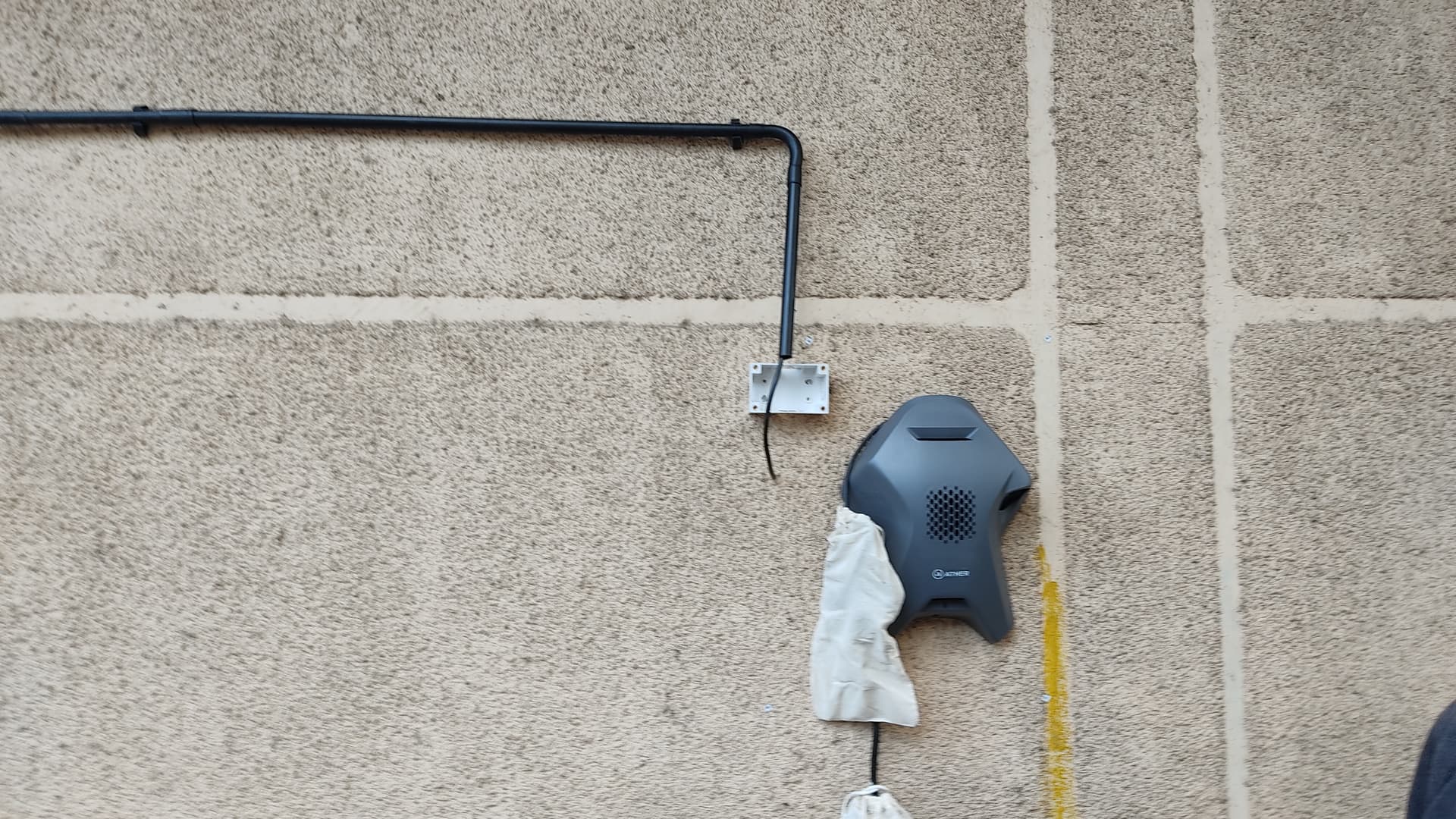

Quick glimpse of the scenario around my home and why I found it important to take a call on this. A regular mid-rise apartment with few flats in it and no security guards appointed. The building located in a commercial area that becomes deserted after 9pm, and adjoining areas happen to be all slum. Rising theft cases of EV mopeds and their batteries was a primary concern.

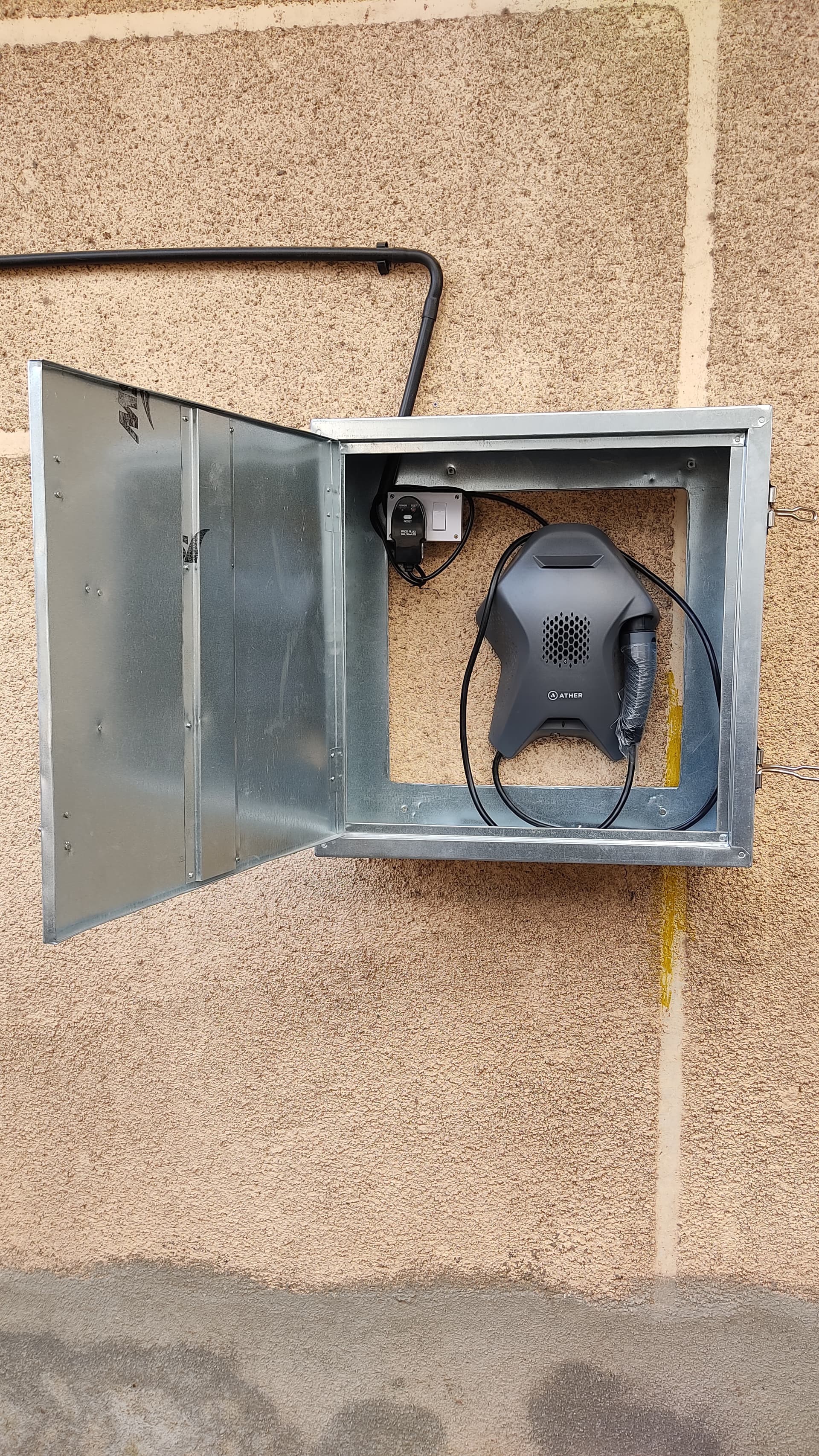

Soon I started thinking of a closure for my Dot Charger which only I had an access to, something that wouldn’t rust and would stop people and children from fidgeting with the Charger.

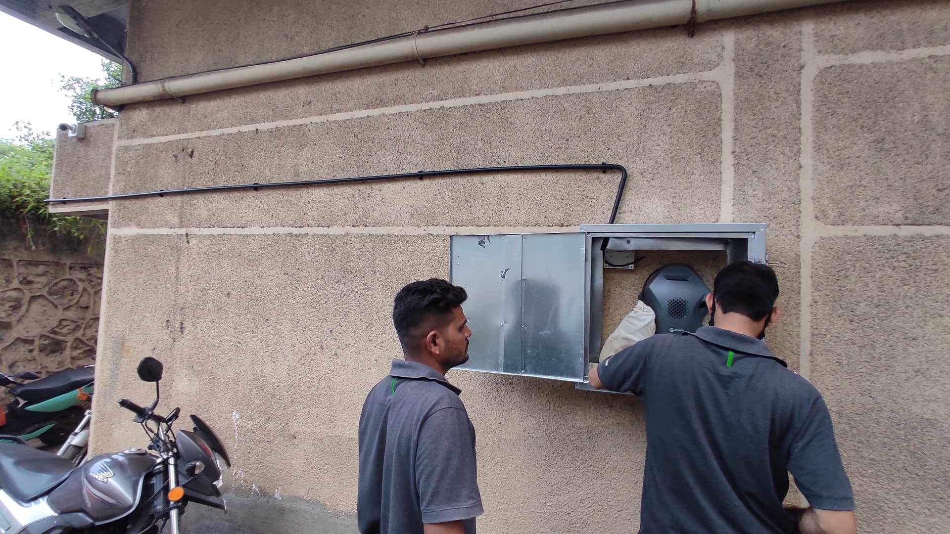

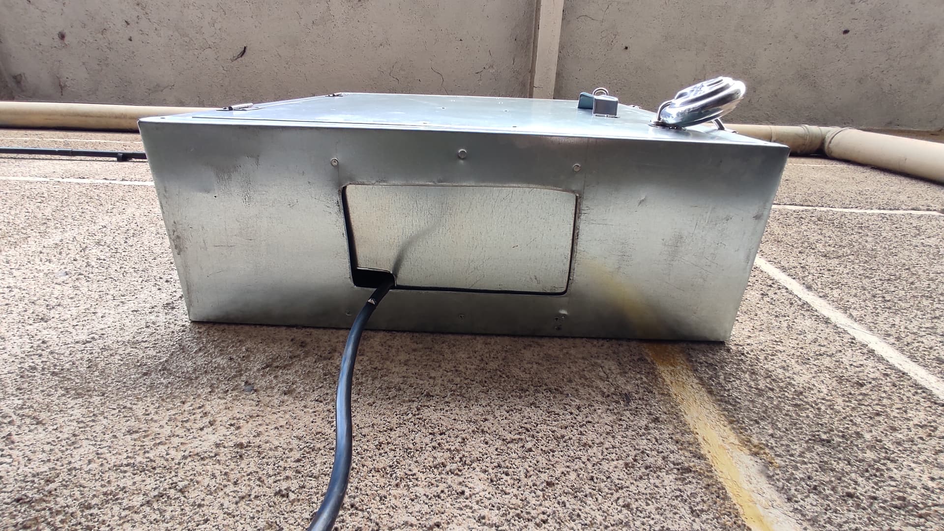

Fast forward - A day prior to the delivery. I went to the market and after a proper discussion, I placed an order to make a galvanized box with a hollow back to avoid compromising the fitment of the Dot Charger on the wall.
3 days post delivery, I collected the galvanized box and the guys from Ather arrived to fit the dot charger. I showed them the basic idea of how I wanted it to be and they were all good to go. I’m glad how post delivery I was told that the box fitting won’t be done by Ather’s team, but on the day of fitting, they voluntarily asked to fit the box. Kudos to Ather Nashik- Patwa Auto Drive Team.
Happy with the box size, I can also store the body cover I’ve got for my 450X.
Box dimensions - 2ft x 2ft x 8in Hollow cut-out dimensions - 1.5ft x 1.5ft
Wow, this is super amazing, I was exactly thinking the same think but in wood. I’m planning to get the box installed after the charger is fixed, I would like some space and additional socket too, for my pressure washer. Super neat finish
This is as good as a bank vault :sunglasses: superb! How much was the costing though?
Costed me approx 1100 bucks :grin: :grin:
How much did your Acrylic case cost you. I pretty much fancy it. Might even go for it. Aesthetics over functionality :heart_eyes:
The exact same 1100/- ! But was a HUGE pain to install. Since it was one time installation, I took the pain! Else I wouldn’t have…

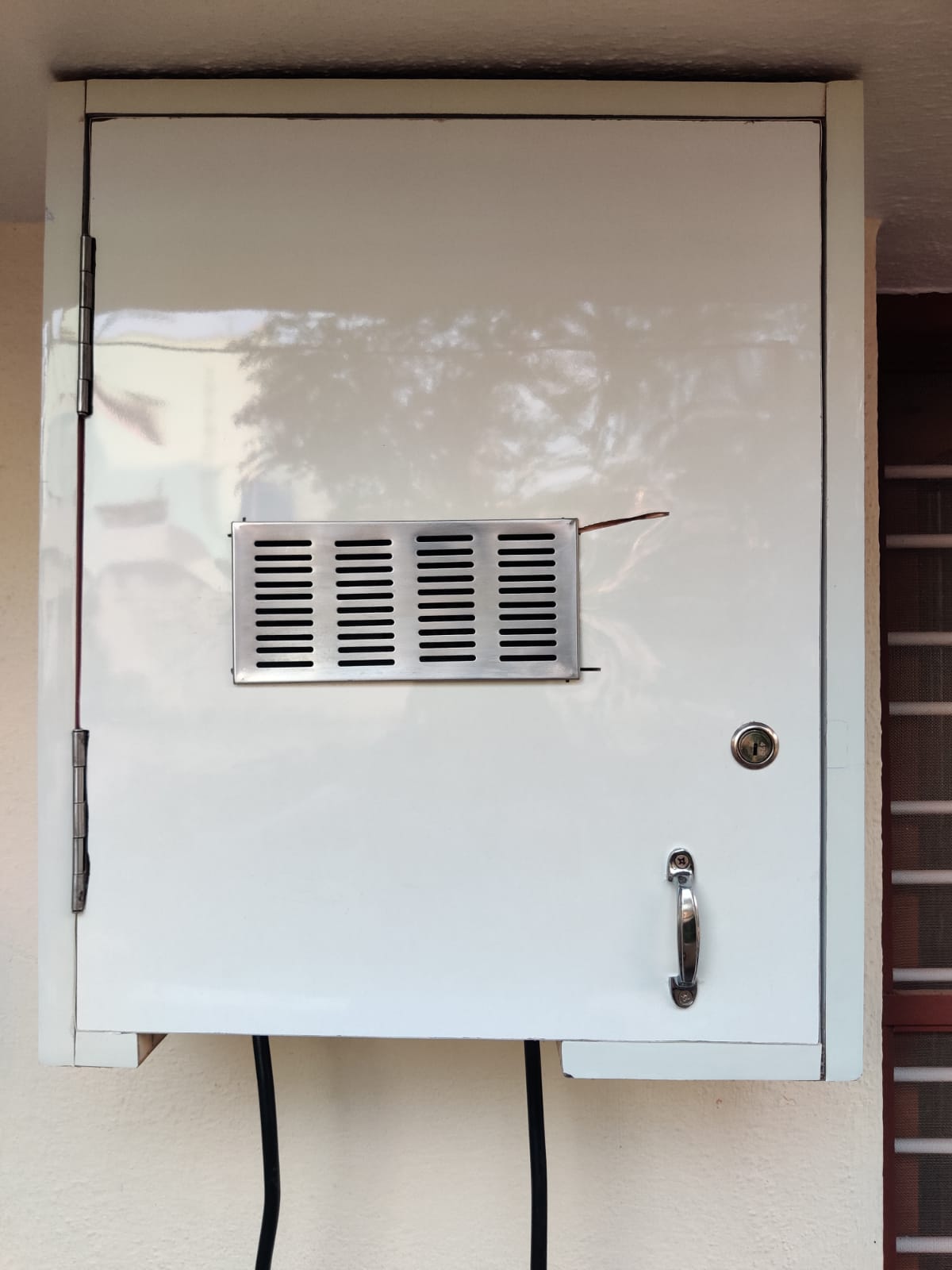

This is something that i recently got it done to protect my Ather dot from dust, rain and also from theft. Costed me around 1.2k. made this done with waste woods that i had in my store.
