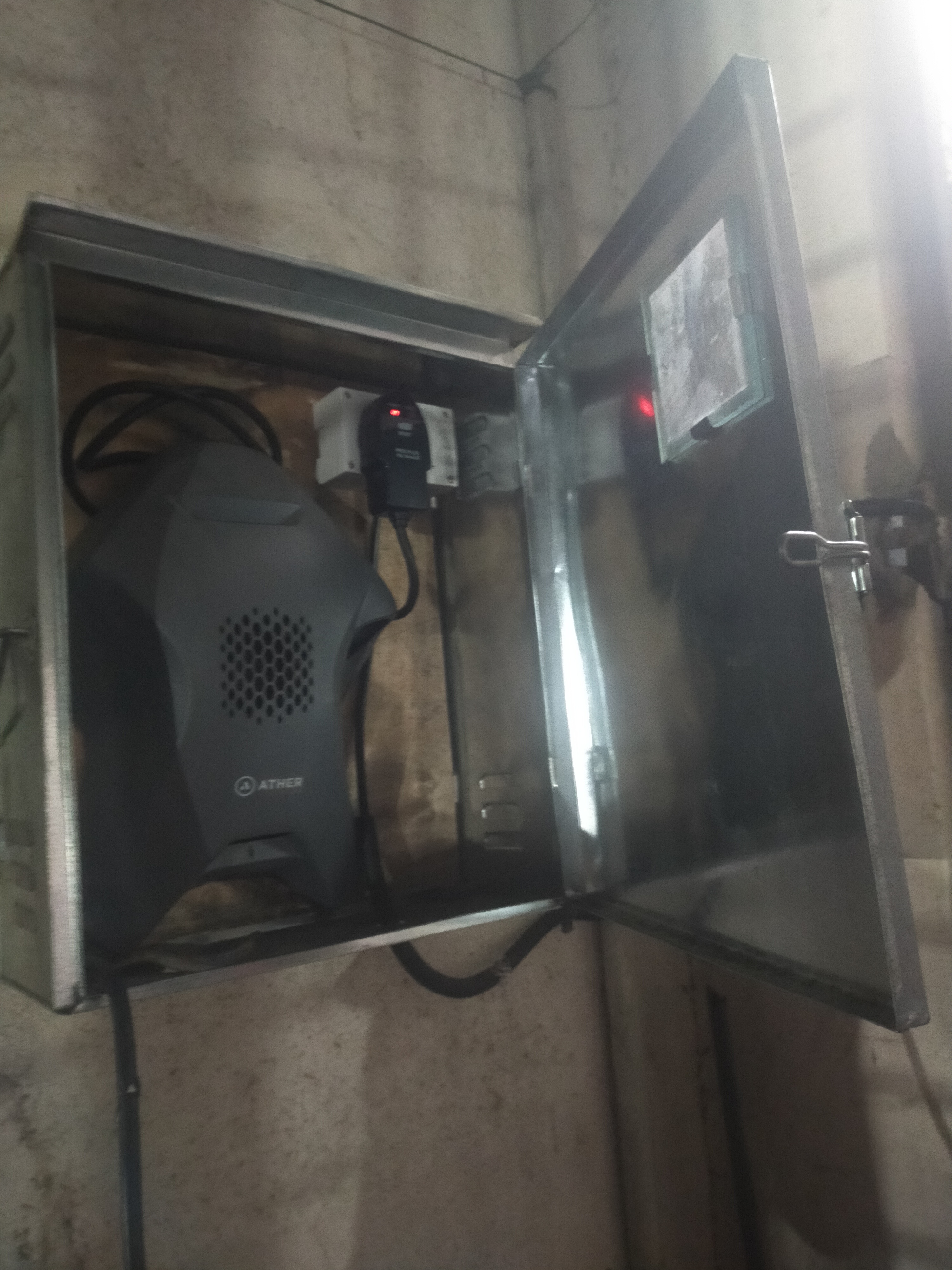

Thanks for above post for idea. Mine is more economy one, complete installation cost me only Rs500/- paid to electrician+ 350/- box. Total Rs 850/-. extra wiring for MCB and MCB switches old ones used[available at home].ignore it if you dont like it - i always look for cost effective solution and dont increase the price of Ather.

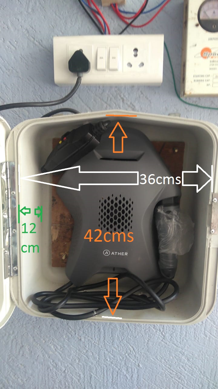

Only MCB are reused , as they are working well and not in use, so i have used it (Wire left over from old bundle available 1.5 guage wire)- Box dimensions 14.5" X 17" X 5" which are shared above(should not be less in dimension). If you are from Hyderabad Location you can get it from Troop bazar. I think you can try from submersible water pump shops for above box.
Is the box made of metallic or Pvc/Nylon?
Its Plastic box, they have given plywood piece at the back for shock proof.

Yes Anees, It just cost me Rs 350/- that can give safety and dust proof to Dot Charger. Missing part is good looks.

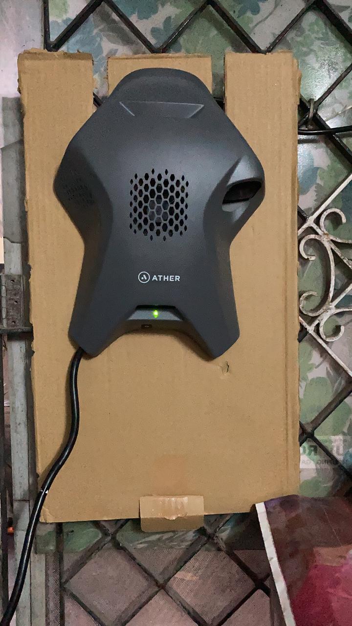

I got the DOT installed today, i also tried most economical way to do it.
  1. 350 Paid to Electrician who did excellent job and wires where taken from the main box with 2.5 Sqmm wire and with proper earthing as well and he also checked with multimeter and test lamp.
  2. Bought 16Ams & 5ams Roma Socket & Switch with box cost me 460
  3. Bought two SS heavy hooks Medium size for 20 Rs.
  4. Used Carton Box sheet just to protect the back side of DOT
Spent 830 as of now, if needed will get the Wipro 16A smart Plug as well.
Hooks were inserted on the key hole of DOT and the other side was evenly placed on the Grill inside the home and used the Carton box as a layer between DOT and the grill. All working fine now !!!

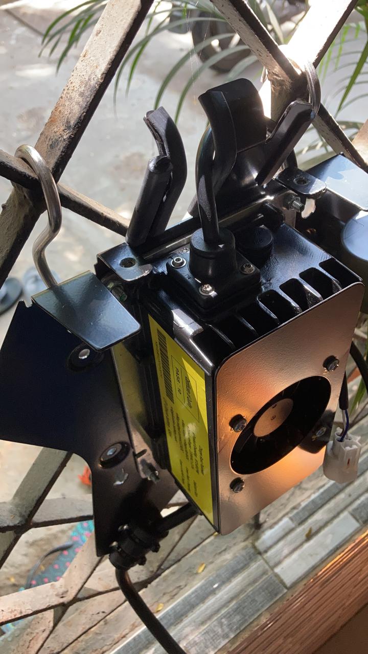

Hooks are ok but I used below type for my dot (previous vehicle 450). Below are pictures reference only I bought them locally in SP road.
These are more permanent than normal hooks.
Hooks are 18 per piece. I didn’t remember the price for nut bolts, but they don’t cost much.
I stay in rent house so I decided to make a temporary arrangement ( My owner is ok though & even suggested diff places to fix) more over the ather technician who came to fix it said it is not convenient to fix it.
Similar to your arrangement remove the top cover place the bolts and tight the nut from outside washers may be required.

Gave inside box measurement in cms, go with 2-5 cms more in dimension. .

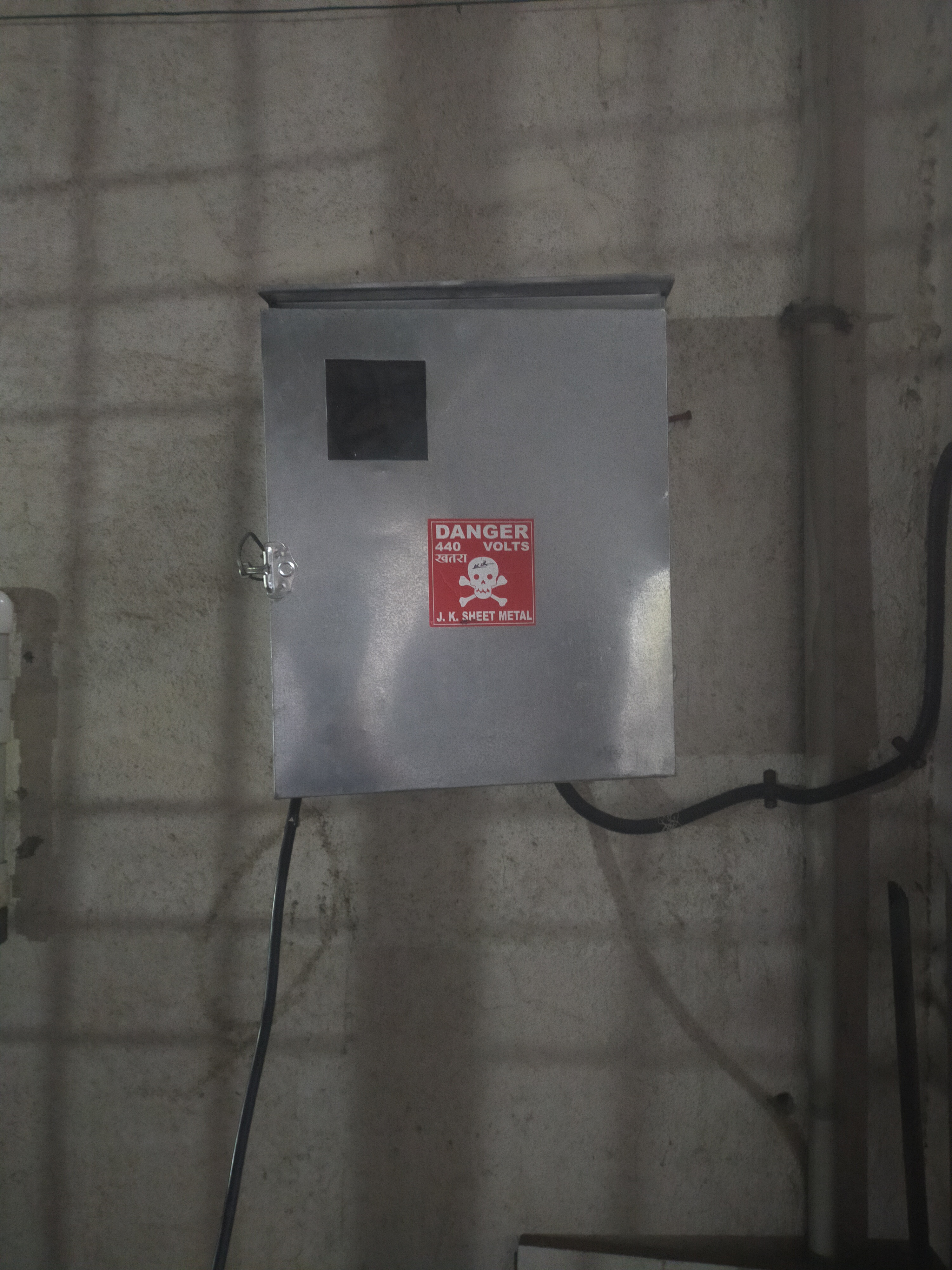

Even a standard electricity box looks nice considering a society and if you are on a budget

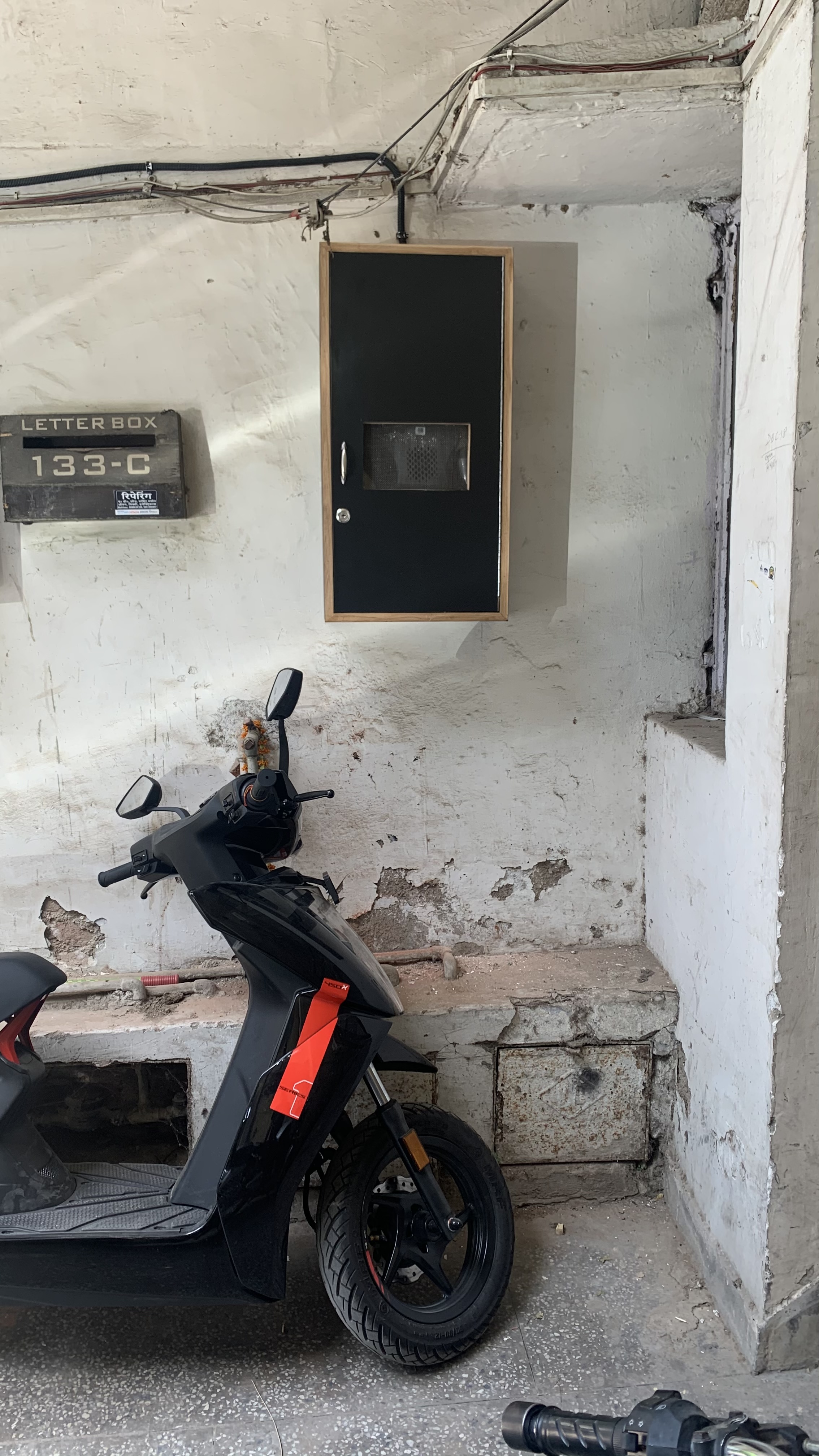

I got a custom box made. Costed me 3k but worth it. There is a hole in the base for the charger wire during charging while the front remains locked.
