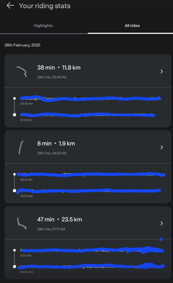

Hi All,
I bought Ather Gen 2 450 X on Oct 2021, I was good till 3 years until Sep 2024 I used to take for med long ride for about 20-25 kms one way around 50 kms per day. Post that I stoped using for long distance and used for local commutes, I never done overnight charging and left charging in grids as well. Now on 28 Feb 2025 when I took for long ride once again with 100% battery i started to drove for 20kms in smart eco mode and battery % dropped to 41% I thought that could be some issue because of the break I gave for long rides so I put that on Grid charge with 80 % i drove for 2 Kms in smart eco battery dropped 5% and then it was idle for about 8-9 hours during that time it dropped 3%, I thought its back to normal so I started driving back in smart eco and then noticed service center then realized to check my battery and battery dropped 40% (from 72% to 32% ) for 11.8 Kms ride.
Not sure what was happening I went to put on charge and ended up giving it for service check right away. Now they are informing me that battery imbalance problem, battery need to be changed…
With Ather being an EV battery replacement alone with take a hit of 40 % vechile cost bare minimum. What to do in this case.
Luckily I bought a extended warranty not sure what they gonna say about that. Ideally Ather should take responsibility on providing such information to User in dashboard or mobile app about such things based on recent update about warranty extension they should give it for all Ather vehicles as well.

u should push for a free new battery as u have warranty, what did service centre say?
For extended warranty mostly they balancing the cells and return to us, same happened to my gen2.
They never replace in extended warranty
