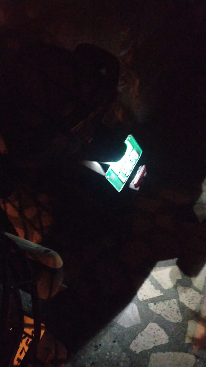

Number plate light is on even after update or switching off the vehicle. Initial bug after installing the update
Shutdown and restarted the 450x, fixed the bug for me.
Yeah did that. Seems to fix the issue. But not too sure if any other bugs shows up. Will keep the thread updated.

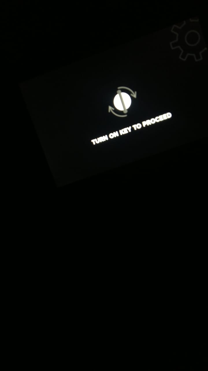

Today there was an update due to which head light & taillamp were on whole night and my apartment security called me in the morning. When I touched the screen it says “Installing updates switch on the key to proceed” and as soon as I turned the key on, within a second the installation was completed.
Why can’t this process wait for the customer to switch on whenever they come to drive or send a push notification to the mobile app?
Even better, download and keep it. Prompt the user whenever they start to choose when they want to apply the update at their convenient time.

Around a month back, update resulted in the display and number plate lights on throughout the night.

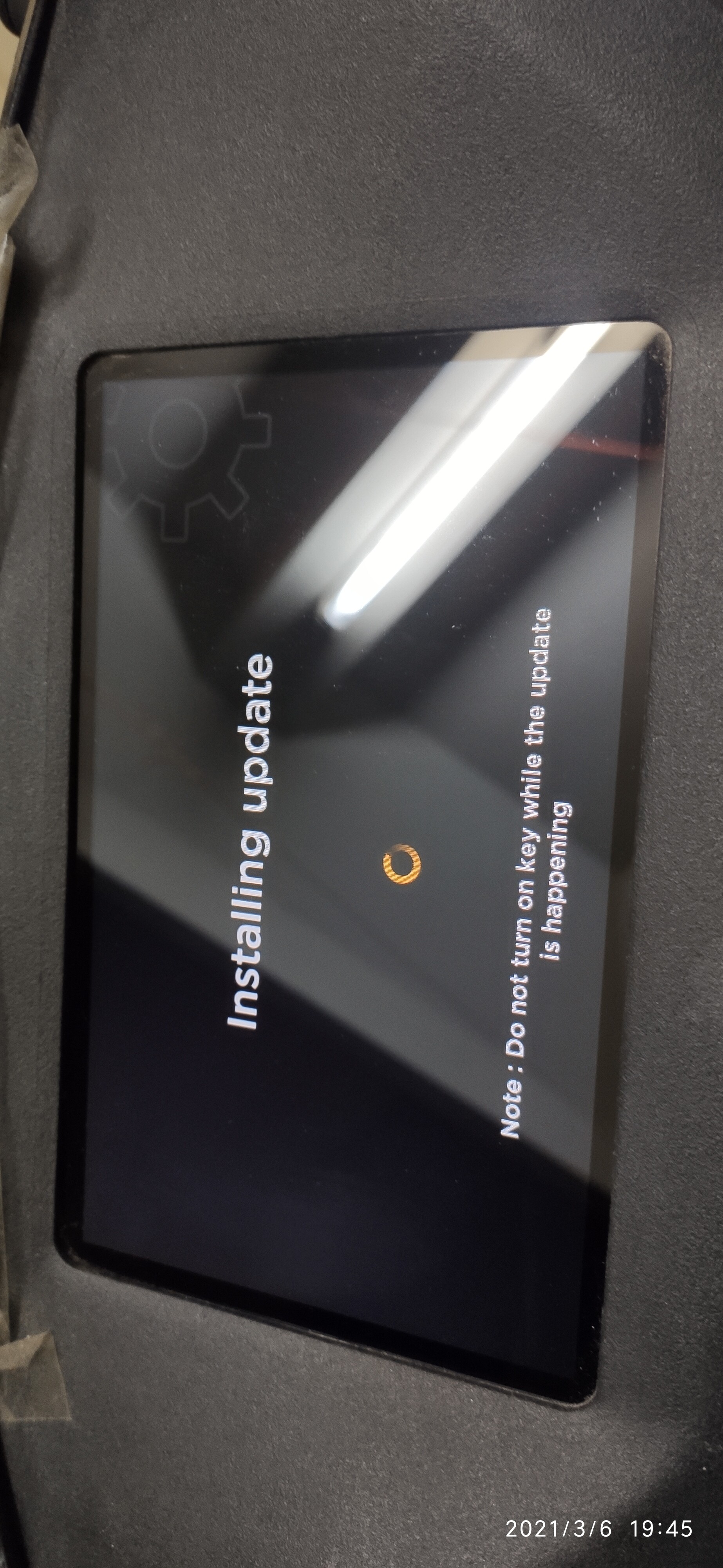

The dashboard and back light was on from 4am in the morning. I received an update for installation I turned on the bike. It said installing and went on till 7:50 pm. Couldn’t take the bike out the entire day.
At the end the Software wasn’t update.
